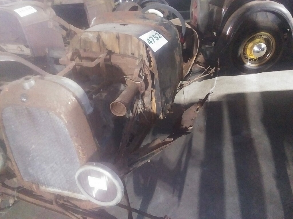

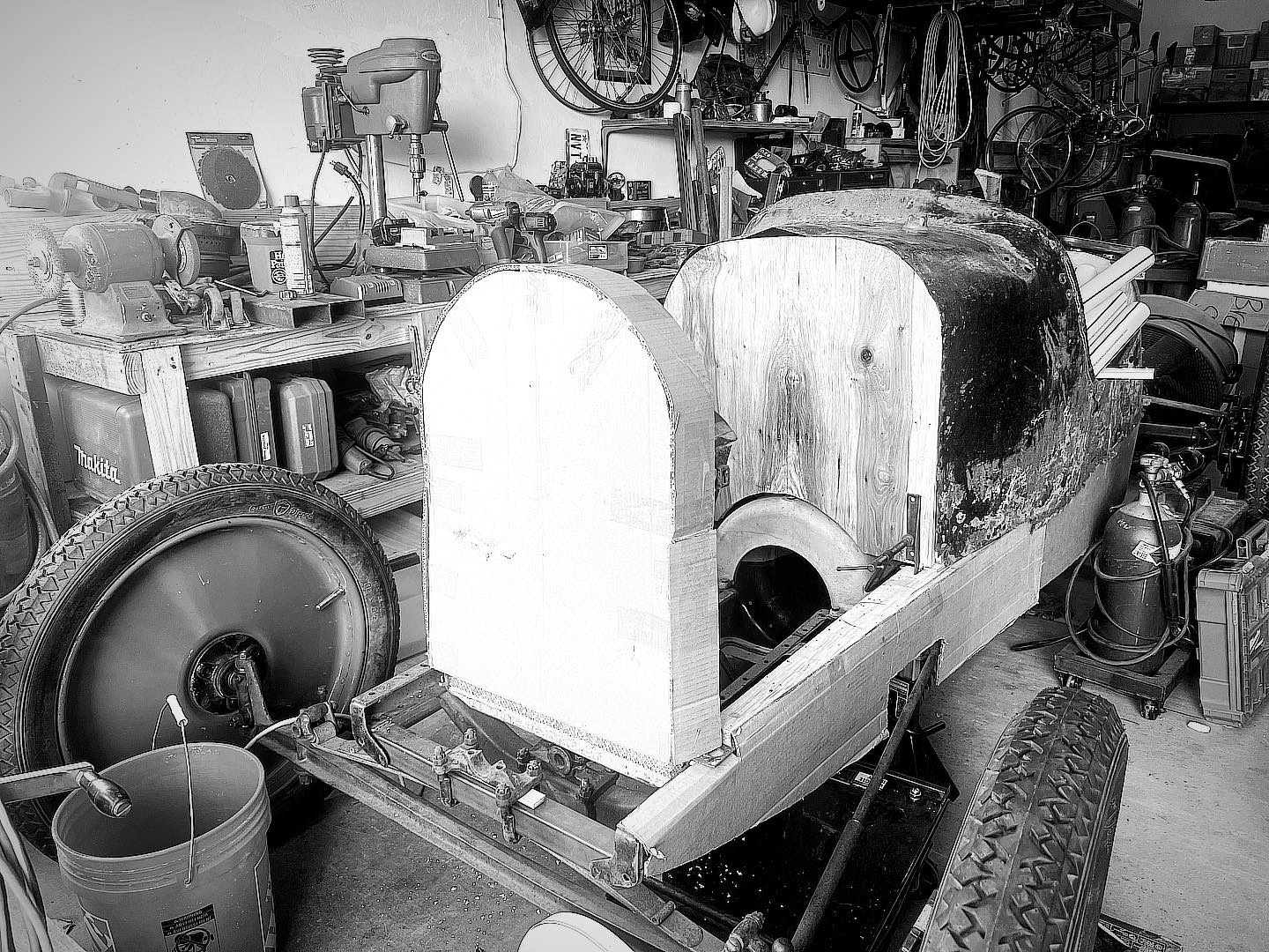

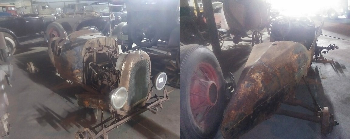

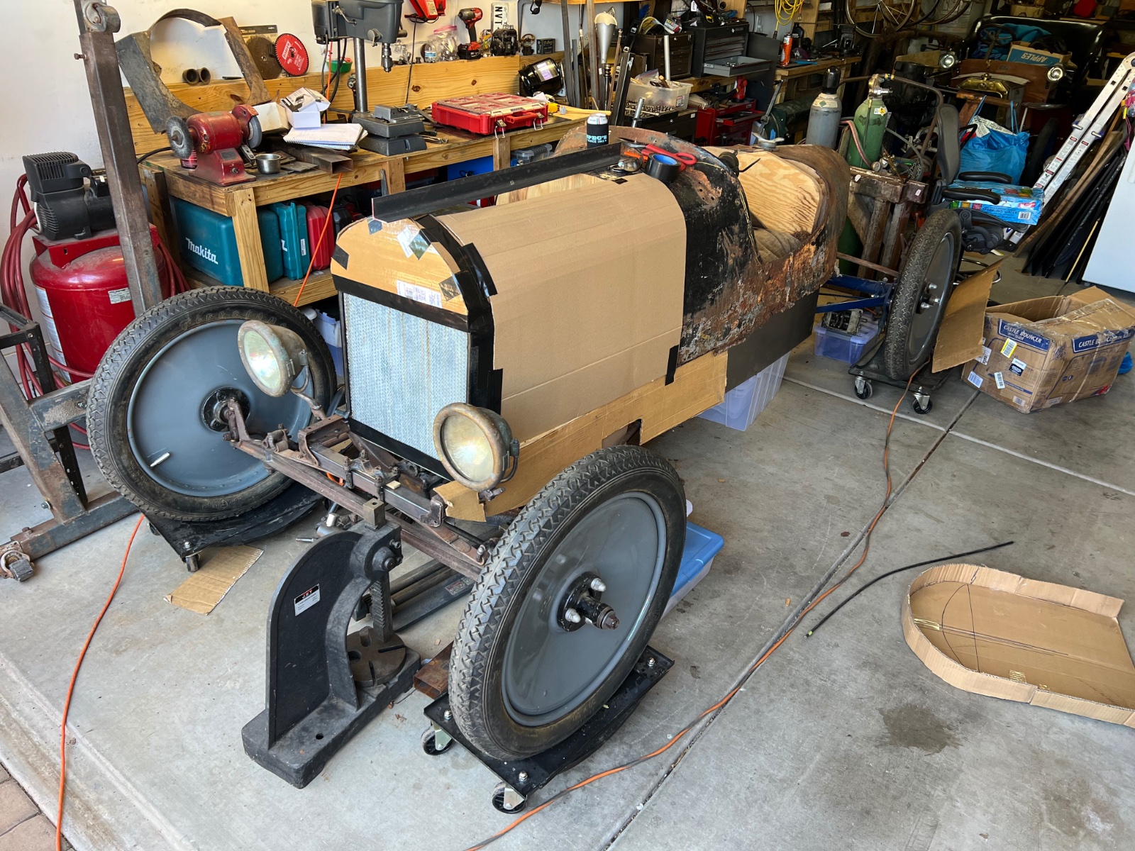

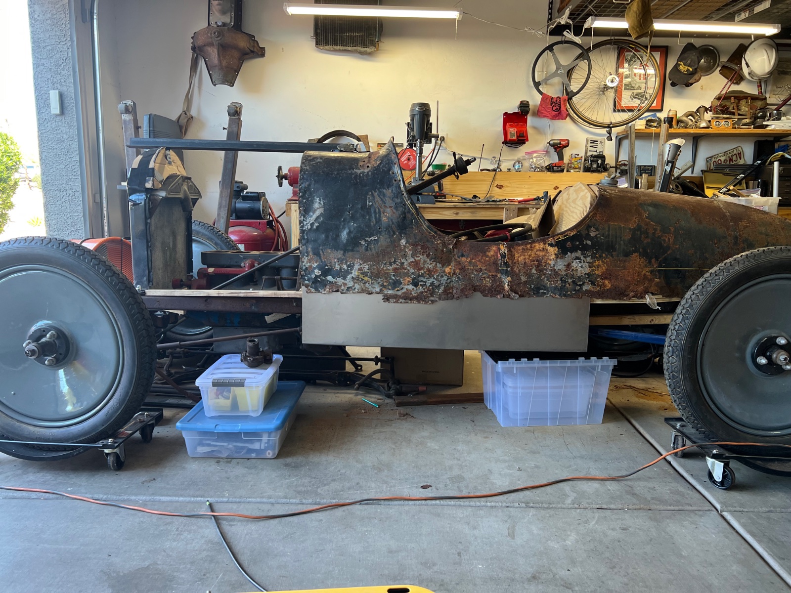

Morton and Brett speedster build
Post by blauvelt » Sat Oct 22, 2022 11:13 am

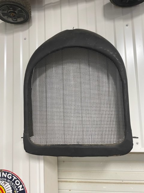

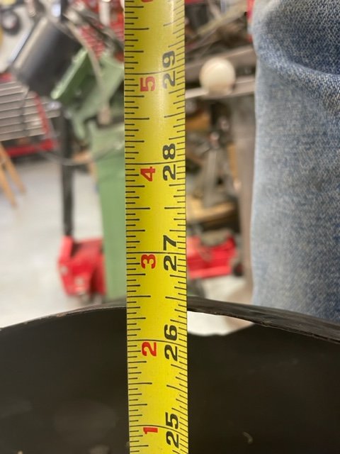

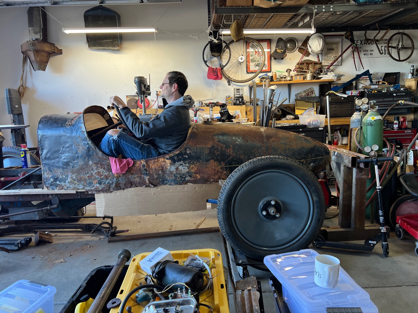

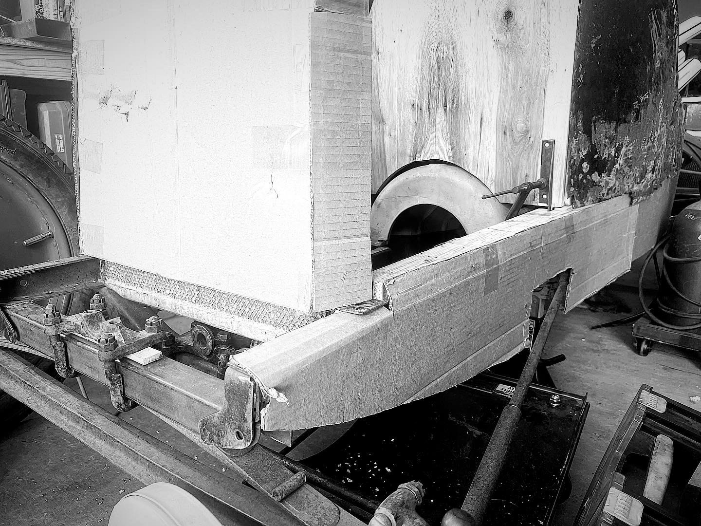

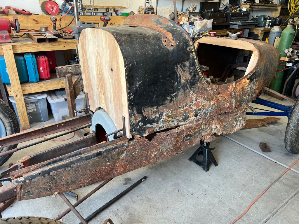

Picked up what I think is a Morton and Brett speedster. Does anyone have a Morton and Brett radiator? Been reading, seems there was a run of Polyform bodies made years back, and there may have also been a run of radiator shells made? Does anyone have any pictures they could share? Were the shells made to fit over a model T radiator (found a picture of one with a modified neck). Thanks!
blauvelt
Posts: 264
Joined: Thu Jan 17, 2019 3:26 pm
First Name: Douglas
Last Name: Ogden
Location: Tucson?

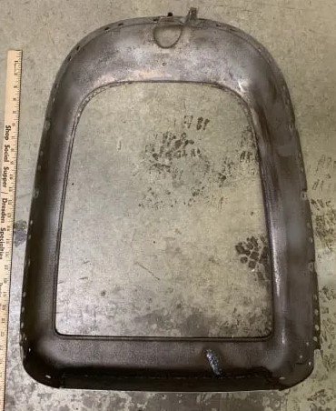

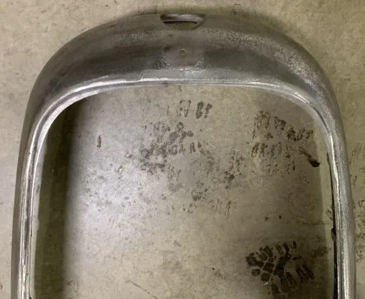

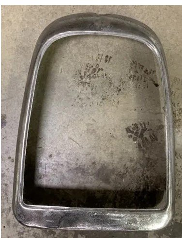

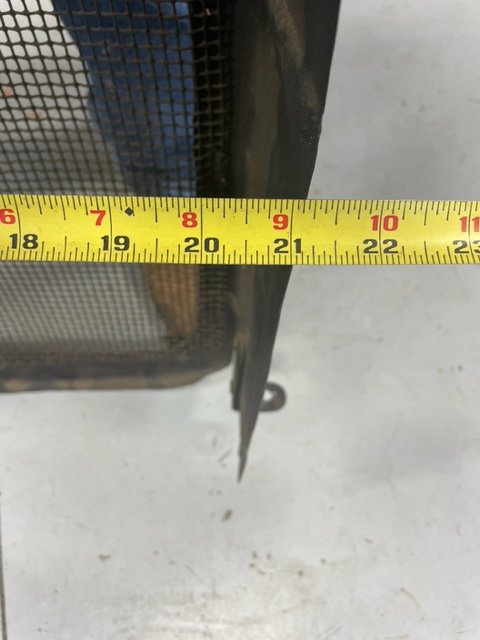

Re: Morton and Brett Radiator
Post by blauvelt » Sat Oct 22, 2022 11:15 am

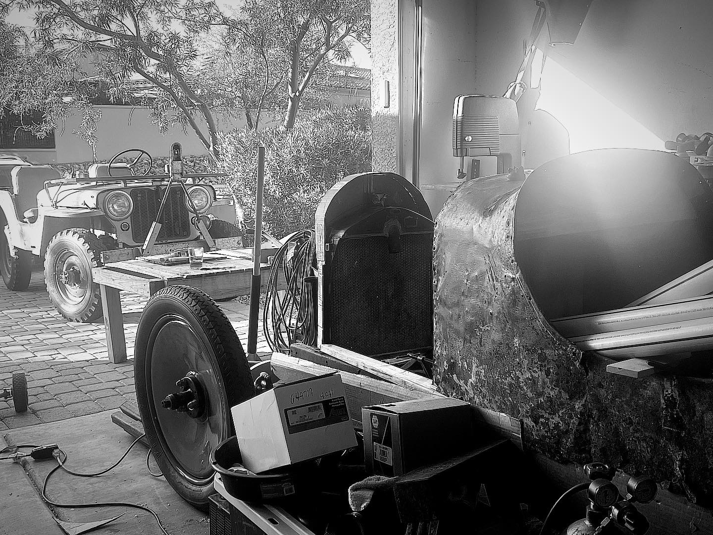

Thoughts? The cowl is why I think it is Morton and Brett, even though the tail looks Faultless.

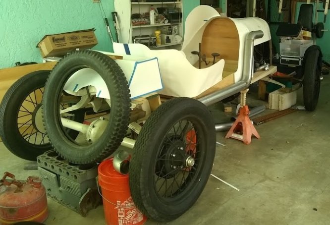

In the 1970’s I built a speedster with a Polyform Morton Brett body and they came with a Polyform copy of the Morton Brett radiator shell. I used a stock T low radiator fitted to the shell and the radiator fit ok as I remember. In the picture you show of the radiator and shell, it looks like a Whippit, car radiator, they were used on many speedsters back in the 1920’s. There are pictures of my white painted Polyform Morton Brett speedster in the 1976 Vintage Ford covering the MTFCA national tour to Catalina Island that year. In the picture of your speedster on the trailer it looks like a Morton Brett body to me because of the shape of the boat tail.

You have a very special speedster project as that looks like a original Morton Brett body. Have fun with your project.

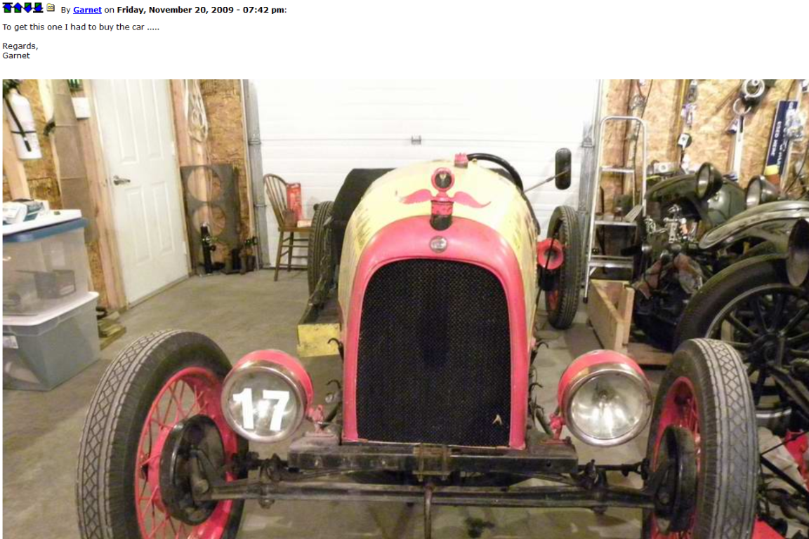

Post by TRDxB2 » Sat Oct 22, 2022 11:52 am
here i a link to detailed documentation on Morton & Brett with lots of pictures
http://www.coachbuilt.com/bui/m/morton_ ... _brett.htm
The front radiator looks like a Whippet - wonder what the rest of this speedster looks like (headlights bucket match?)
https://www.mtfca.com/discus/messages/8 ... 1258814478

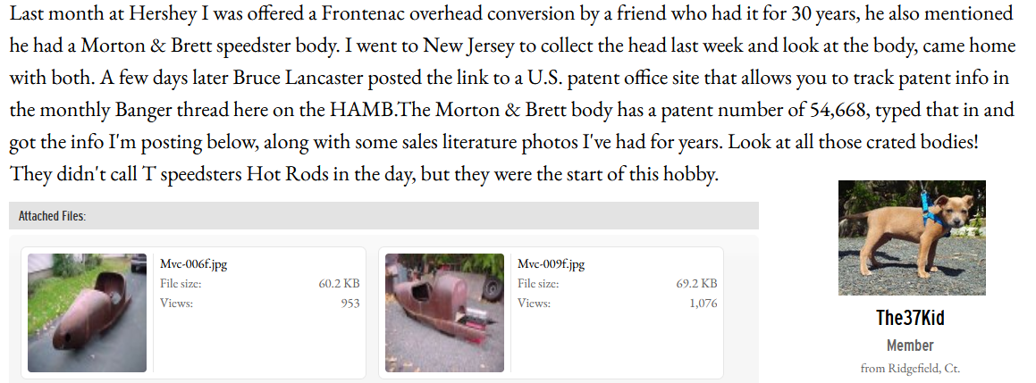

Post by TRDxB2 » Sat Oct 22, 2022 12:38 pm

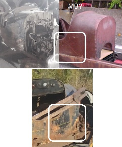

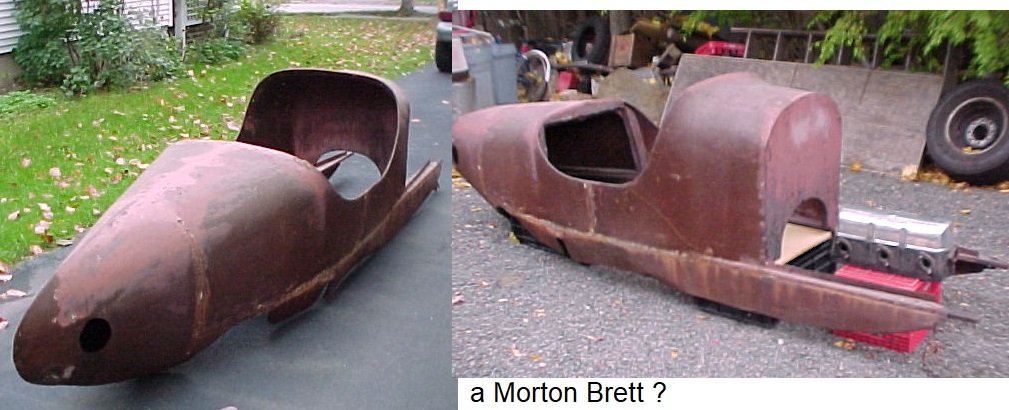

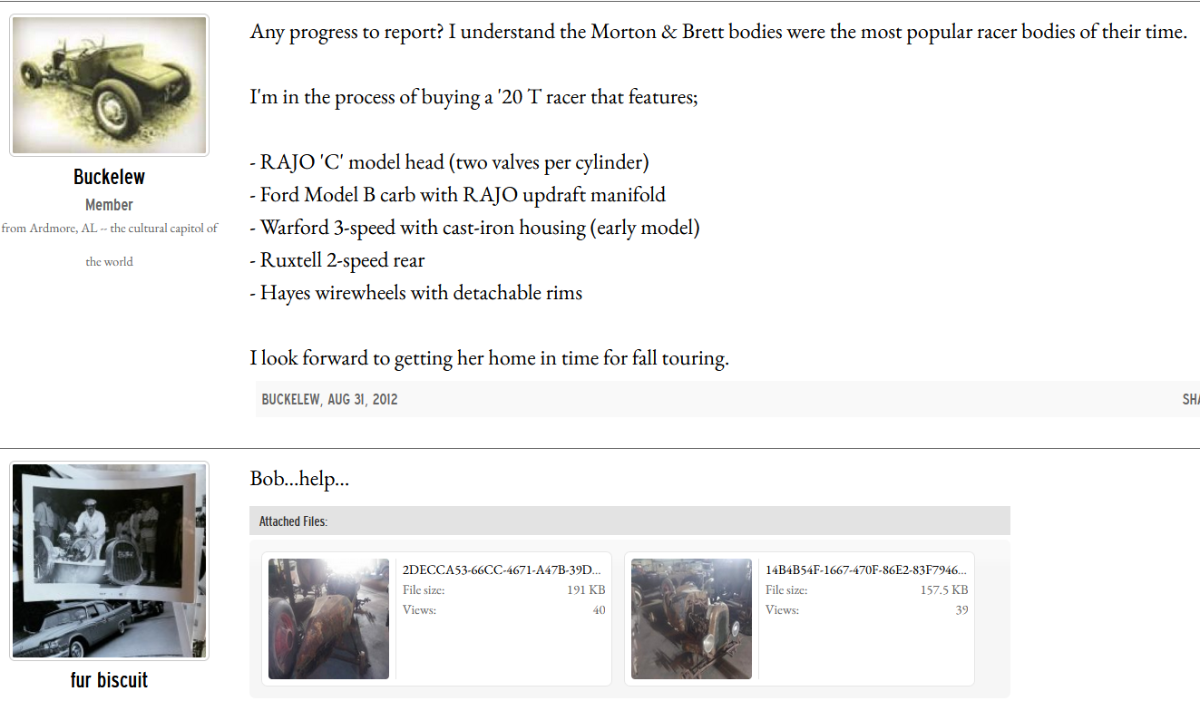

Some more info
In this report notice that there is no hole for a gas filler cap (doesn't mean that much)
https://www.jalopyjournal.com/forum/thr ... ld.220655/

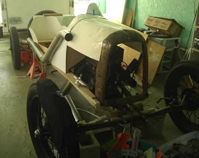

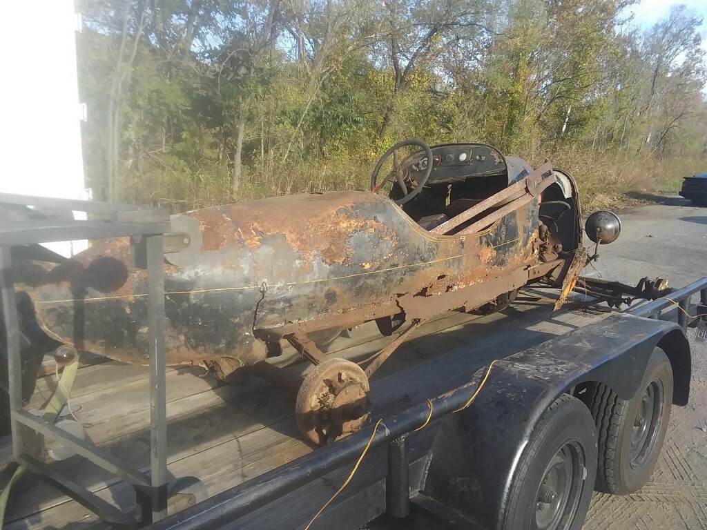

In another discussion includes your discussion in HAMB about your purchase and more pictures
https://www.jalopyjournal.com/forum/thr ... 655/page-2
How do these areas match? MB is still unconfirmed as a Morton & Brett need to follow that thread
compare cowl.jpg (72.21 KiB) Viewed 15983 times

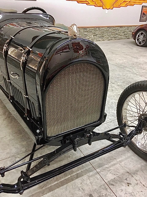

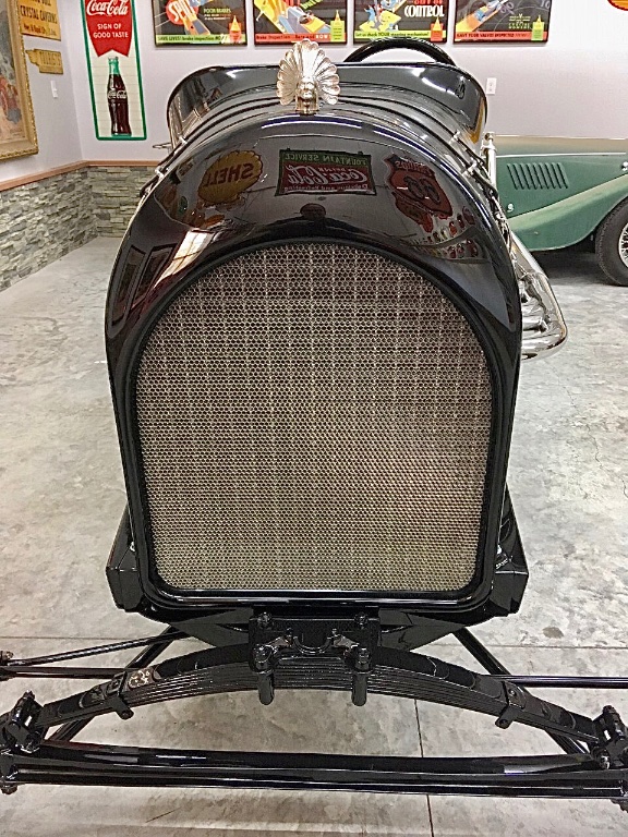

Morton Brett from poliform made by Dick Williams.

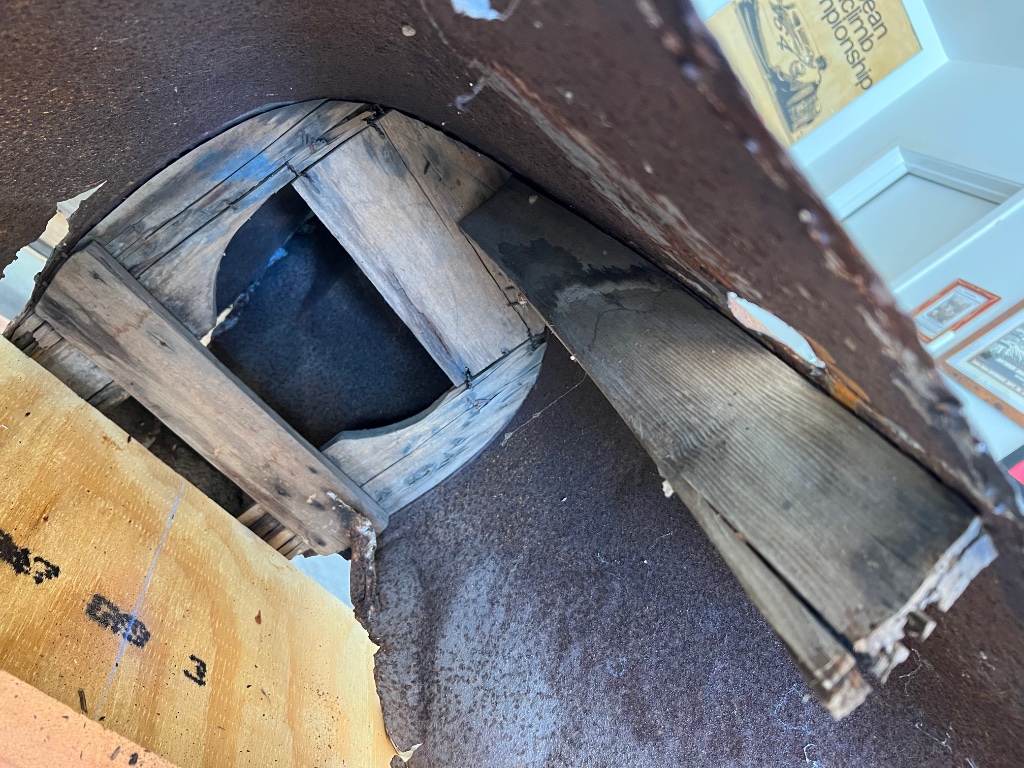

If you would like a photo of something more specific let me know. I have it stored in the next town over but Im heading that way tomorrow.
If you get a chance, could you post some photos of the wood construction of your body. I'm have been trying to figure out in my body what wood is original and what was replaced.
Thank You Steve

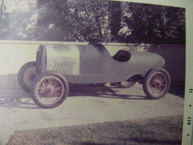

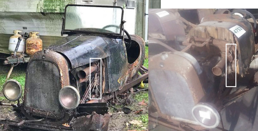

Post by Mike Penserini » Sat Oct 22, 2022 2:48 pm

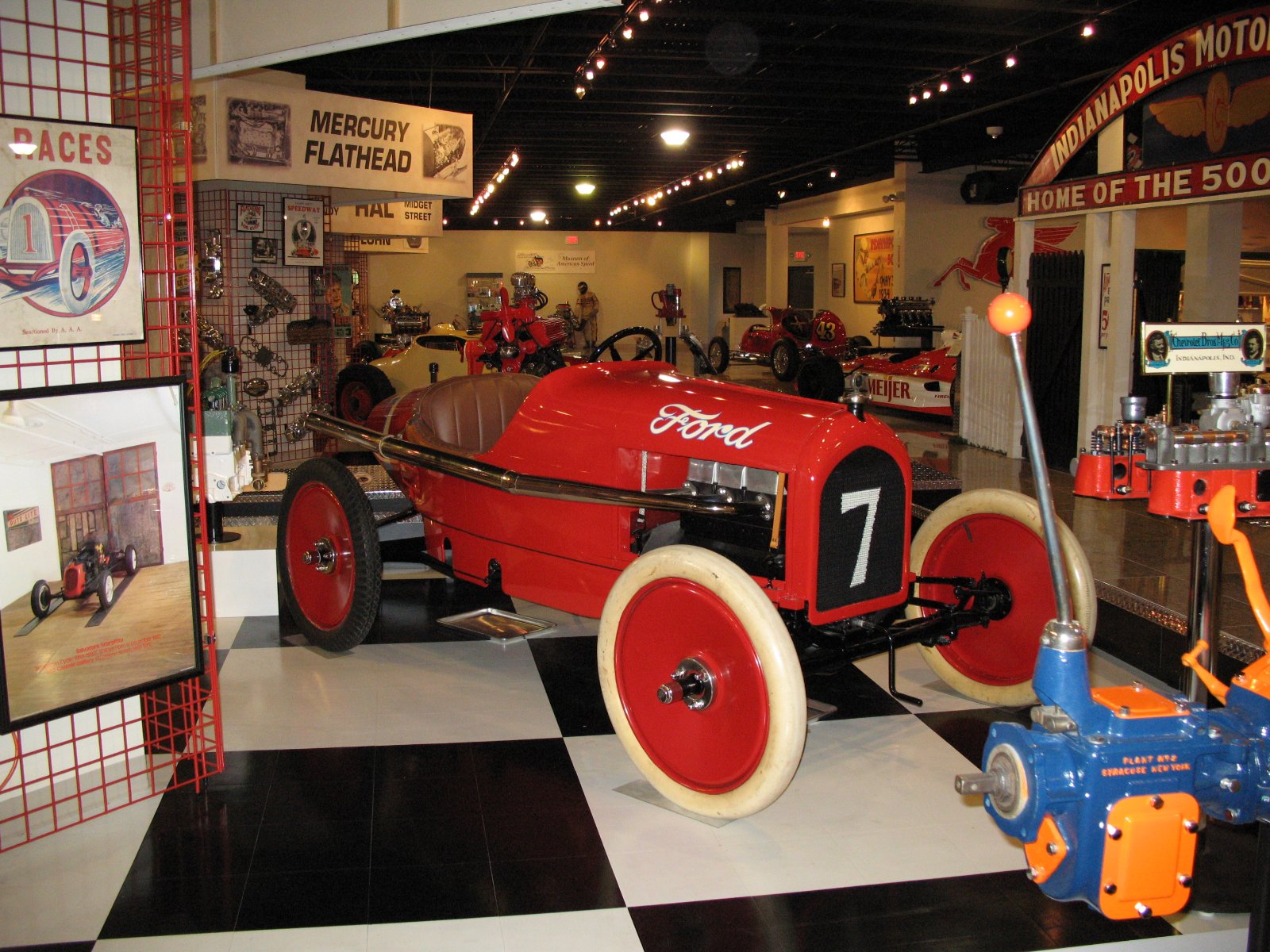

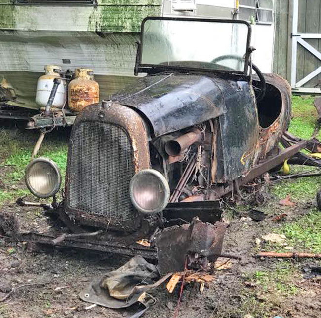

Blauvelt, Does this photo look familiar ? Don't remember when or where it came from as it's been in my computer for years.

Post by blauvelt » Sat Oct 22, 2022 5:40 pm
Mike, thanks for posting!! No, to bad the hood was lost. There are holes for a windshield. Figured the car had been around, not really a mystery. Just new to me.

That is stunningly nice. Would you have a side profile of the radiator? Interested in the the top side profile. Is it rounded or a flat slope back? Thank you.

Post by babychadwick » Sat Oct 22, 2022 9:58 pm
model-t-ford-speedster.jpgBlauvelt, Does this photo look familiar ? Don't remember when or where it came from as it's been in my computer for years.
Looks like the same car

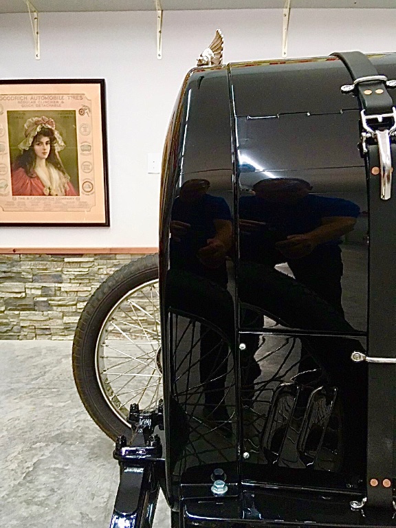

Post by Dollisdad » Sun Oct 23, 2022 7:41 pm

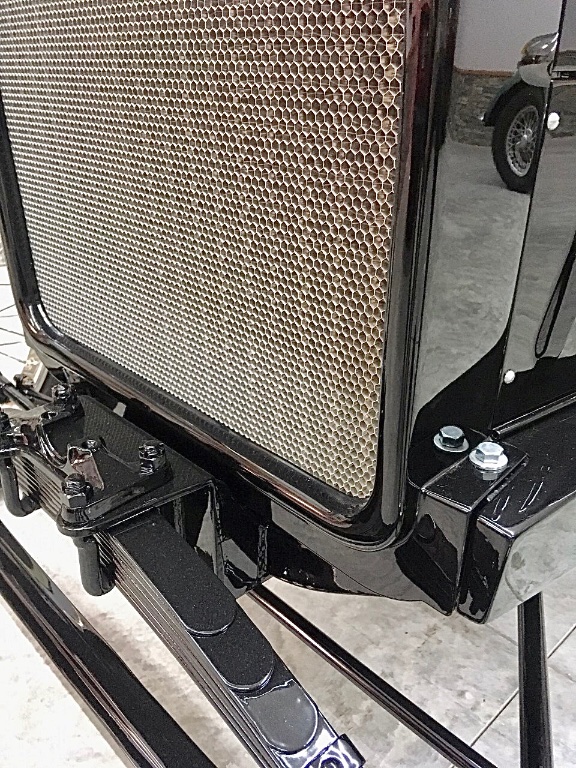

Here ya go Doug, side pic.

Post by TRDxB2 » Sun Oct 23, 2022 8:34 pm
Yup, no doubt its the same car. Wires don't lie :?

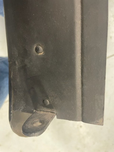

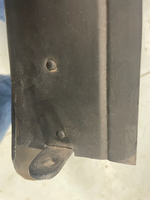

Post by slang250 » Sun Oct 23, 2022 9:11 pm
Hello Doug,

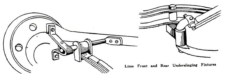

Does your car have These Lima Co brackets on it?
Also found a period photo of a possible Morton Brett radiator car with the Lima Co brackets on it.

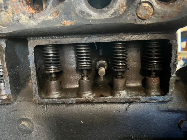

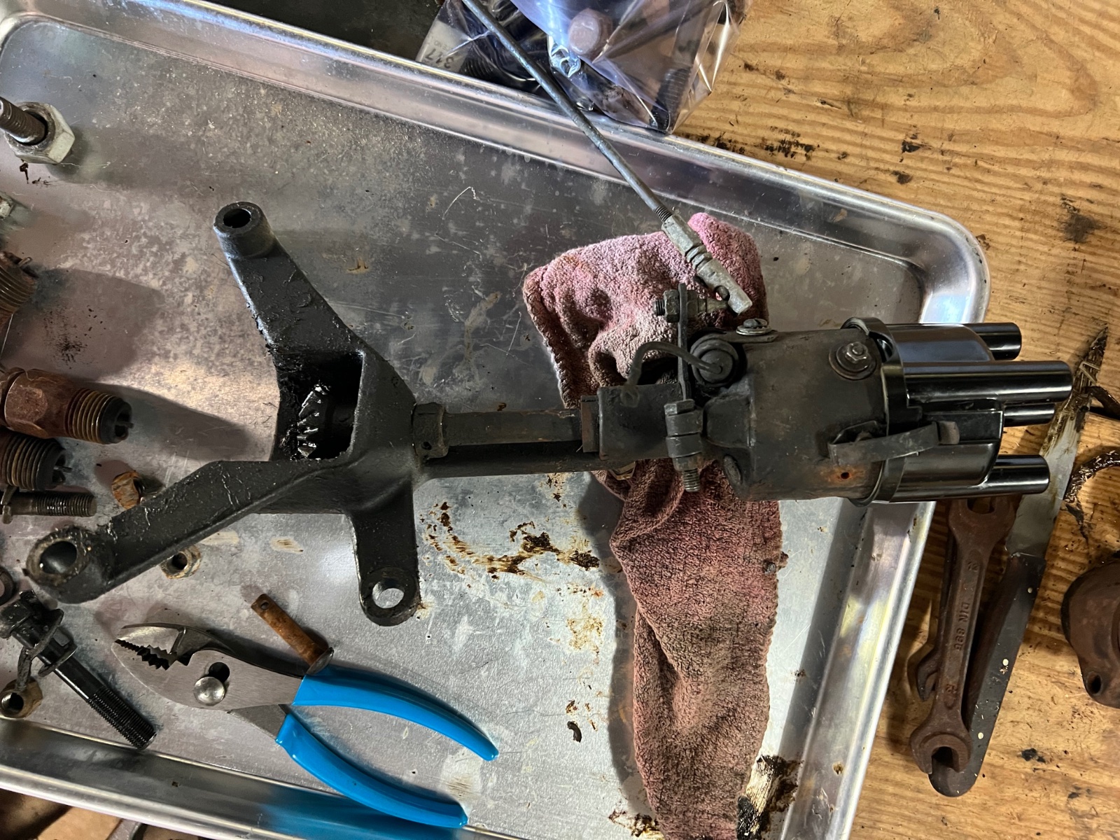

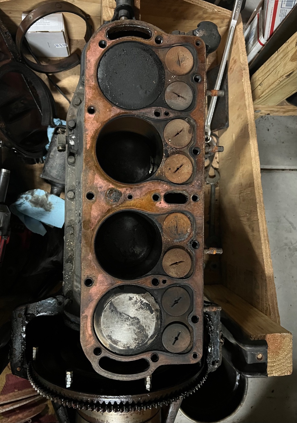

Post by Tim Moore » Sun Oct 23, 2022 11:56 pm

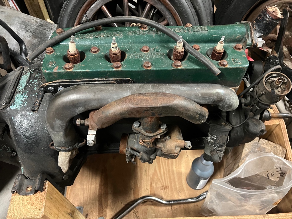

I had a Morton & Brett overhead long ago. It was 8 valve single intake with manifolds and cover. The cover said Morton & Brett with "Indianapolis" going diagonal. The valves were "boyle" and didn't have a taper seat but were flush in the combustion chamber. It was a very nice head but went off to Toronto as part of a deal on a Mercury speedster.
The guy who got it is no longer alive but if you want to try to chase it email me. Long shot but I have chased things all over the country with a surprising amount of success.

Thank you very much!!
Will try and update progress...or lack there of is made.

Post by blauvelt » Mon Oct 24, 2022 7:43 pm
Possibly? The fronts are extremely decayed, the rears much less so. Break down won't start for a few weeks. But they certainly look like those.

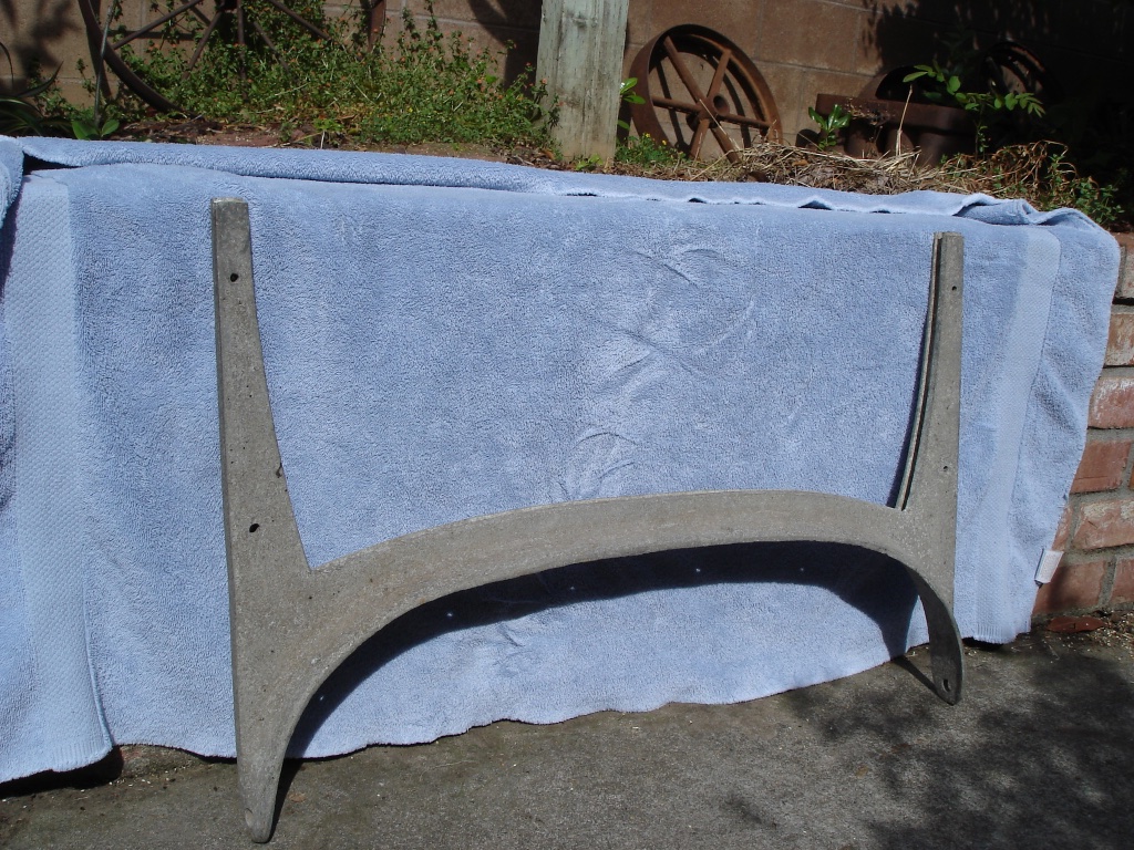

Lots of speedster stuff still floating around. A few years ago I picked up this original Morton and Brett windshield frame, seller said it was too narrow to be a car windshield and believed it was for a motorcycle side car.

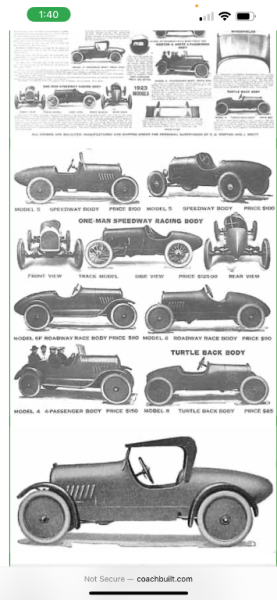

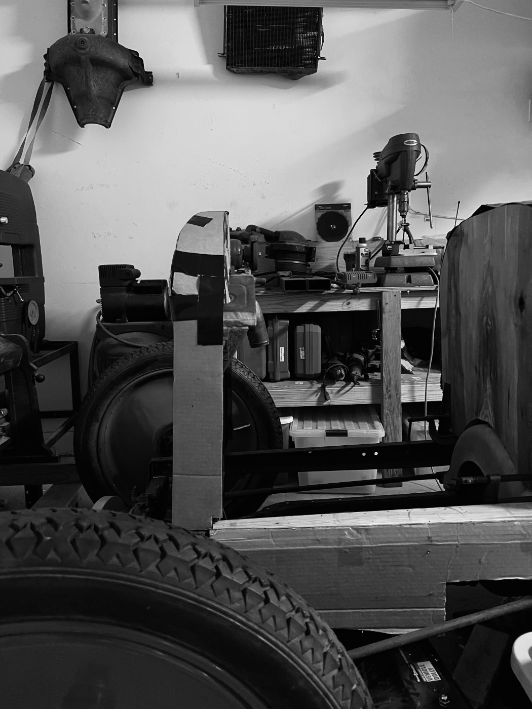

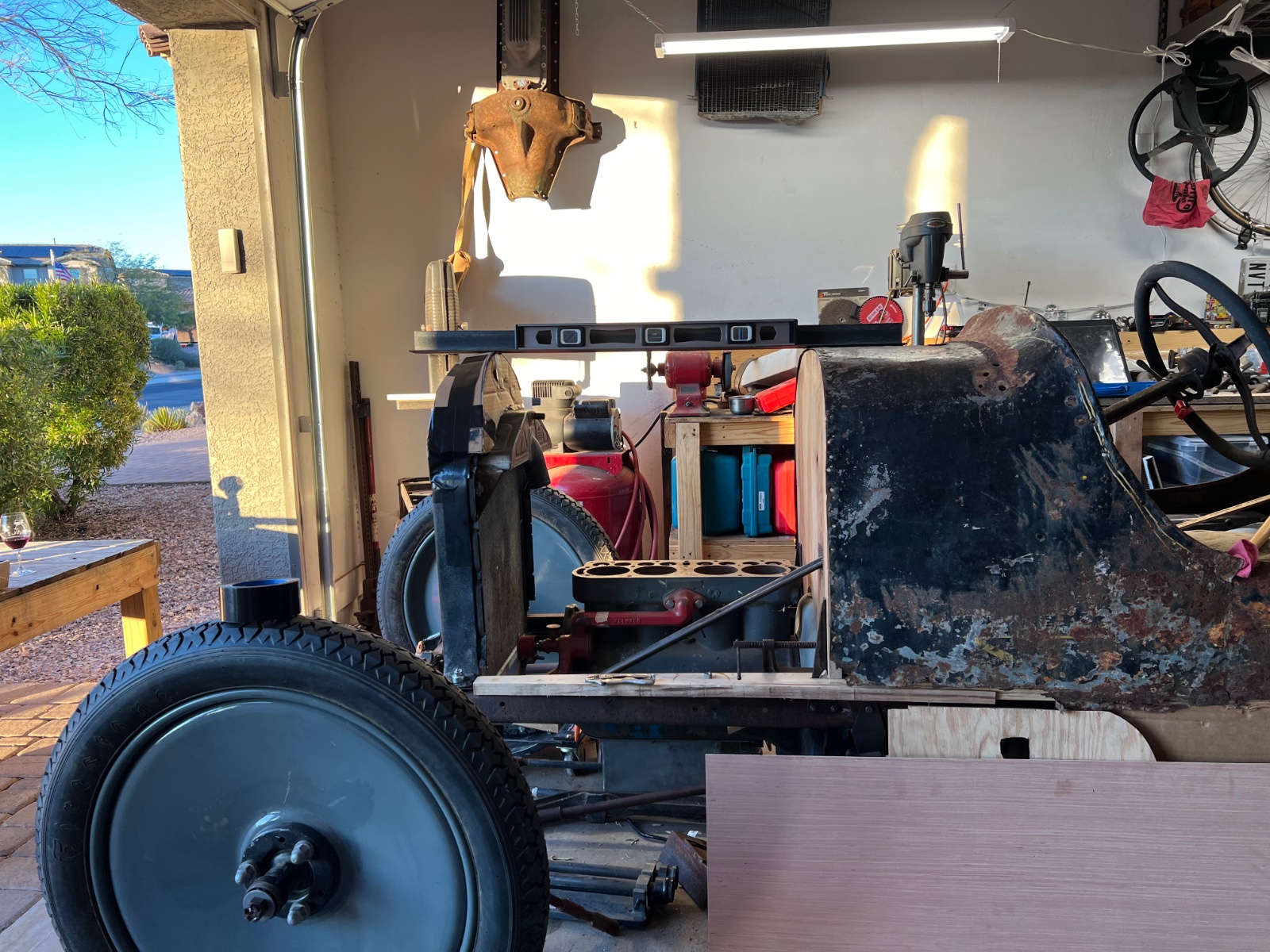

Post by blauvelt » Sat Apr 08, 2023 10:12 am

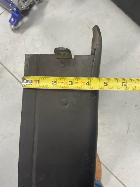

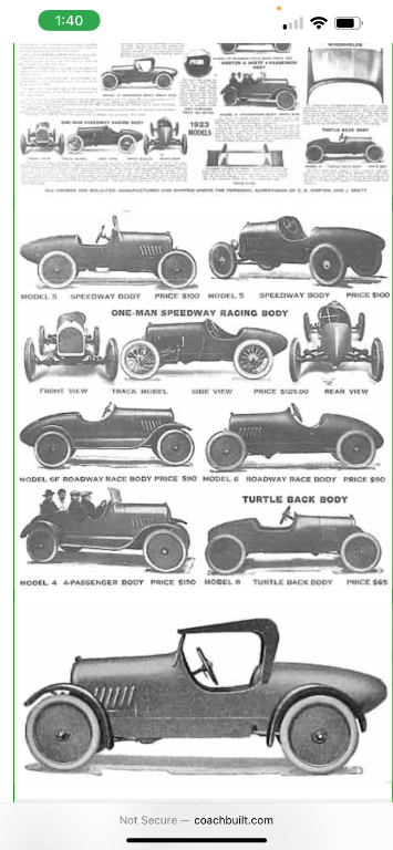

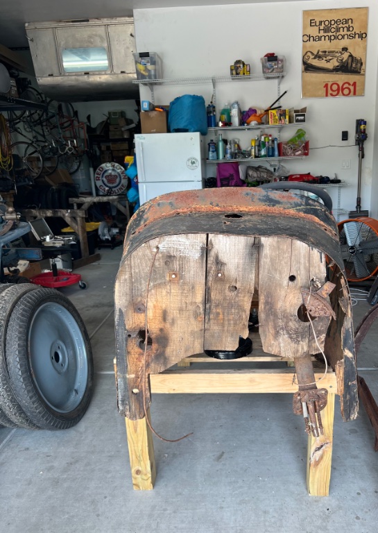

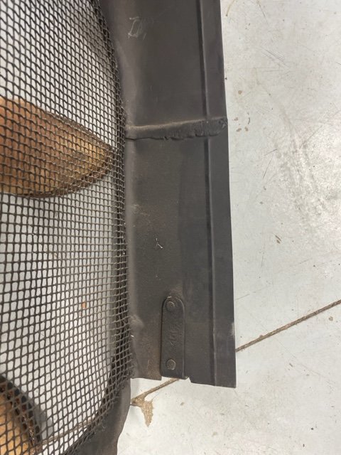

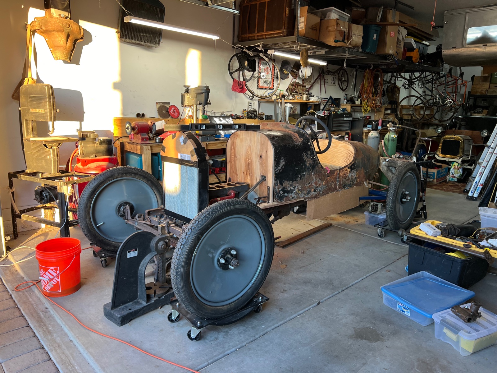

Been perusing the interwebs and have seen drawings of various styles of Morton and Brett radiator (shells). Were these actually made? Like the drawing of the single man body with the more pointy top? The drawings / advertisements being a far more optimistic of what the real out come was.
blauvelt
Posts: 264
First Name: Douglas
Last Name: Ogden
Location: Tucson?
Post by blauvelt » Sat Apr 08, 2023 10:21 am
Assuming my reading is correct, MB licensed their body to different manufactures, who add their own touches?

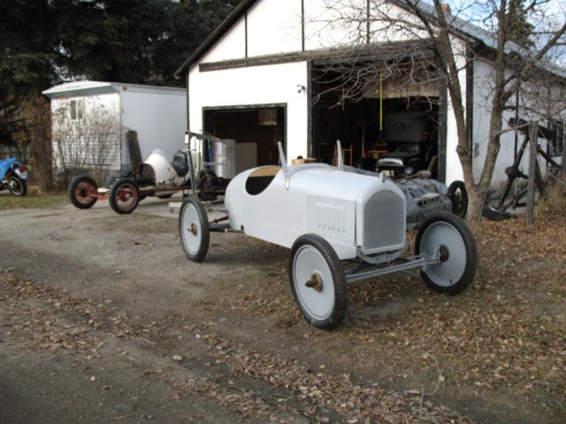

Here is a picture of the precursor body to the Polyform version referred to above. The Polyform bodies were sprayed up with a chopper gun and are quite heavy as a result. The one below and about 15 additional bodies were produced previous to the Polyform bodies. The Polyform mold was made off of one of these bodies. These precursor bodies were hand laid gelcoat/fiber mat construction and were much lighter. These bodies were the brainchild of a pretty amazing engineer in SoCal by the name of Willie Chambers. Willie scaled the plug used to make the original molds directly off of the patent drawings, so they were as accurate as those drawings. The originals were made around 1975. As I recall, the car in the picture below ran in at least two Long Beach Hill Climbs and was (and still is) powered by a BB Rajo. The wheels are 21" #3 Buffalos. I owned several of these bodies at one time and the last extra one I had now lives up in Idaho.

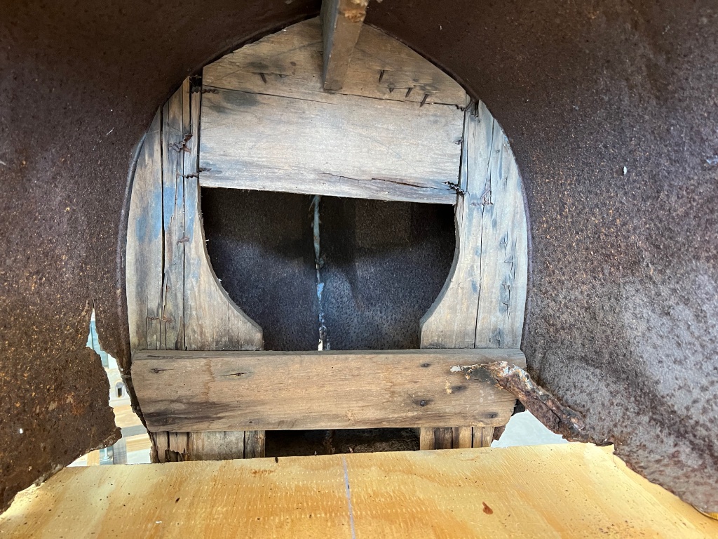

Post by blauvelt » Mon May 29, 2023 12:53 pm
Some wood pictures, see if I can resize some more.

Post by blauvelt » Wed May 31, 2023 9:39 am
Thank you Dan. I'll give them a call!
Also included some more pictures. The car was moved with a fork lift, so the valence panels were just a crumpled mess. Worked them out by hand to see what was left. The sill plates and a few feet are probably salvageable. The rest is just for patterns.

Post by blauvelt » Wed May 31, 2023 9:57 am
The original dash was built out of slats, then flat "nails" were used to secure the bits together. Any familiar with the exhaust and intake set up? It isn't A.

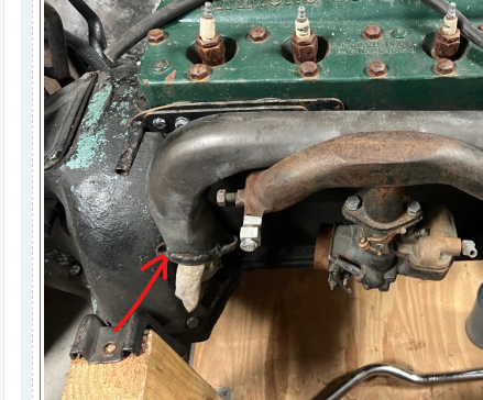

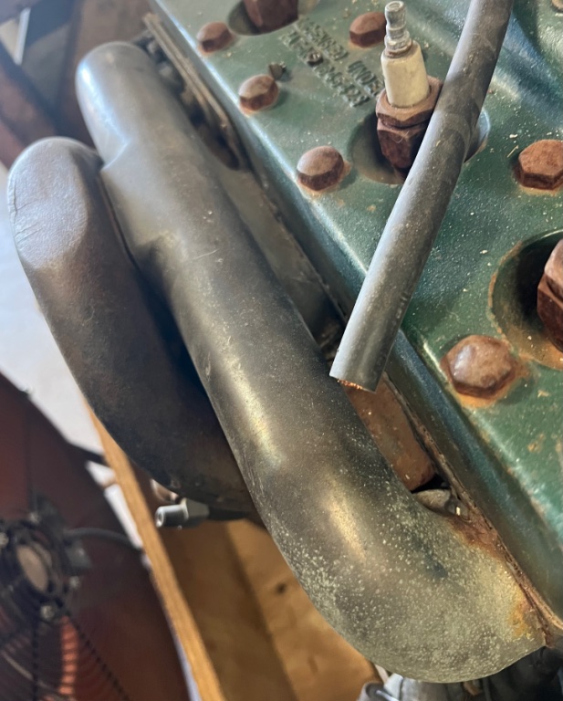

Post by RajoRacer » Wed May 31, 2023 11:02 am
Model B manifolds.
Posts: 5299
First Name: john
Last Name: karvaly
Location: orange, ca
Post by speedytinc » Wed May 31, 2023 11:11 am
B intake.
A exhaust modified with a flange.
blauvelt
Posts: 264
First Name: Douglas
Last Name: Ogden
Location: Tucson?
Post by blauvelt » Wed May 31, 2023 11:25 am
Flange? The plate at the back is tapped into the head and supports the gas pedal. Thank you for the help!
Better picture.
B intake.
Posts: 4503
Post by Jerry VanOoteghem » Wed May 31, 2023 11:59 am
Better picture.
B intake.
Flange...

Post by blauvelt » Sun Oct 22, 2023 7:29 pm
Finally found a good useable T radiator, so i played around with the valence panels and started cutting out a shell for mock ups.

Post by JSteele » Mon Oct 23, 2023 12:52 am
This car has a copy of a Morton and Brett Radiator shell. Made by hand, copied from an original. They used Model T radiators with an extension of about 2.5" on the filler. I have what I believe is an original shell in my shop. I will try and post a picture tomorrow.

Post by blauvelt » Mon Oct 23, 2023 9:54 am
Thank you for sharing the picture. Next step is to build the lower part of the shell mock up and then I'll start on the forehead. Looking at yours it looks like it has more "pinch" than the black one posted earlier. For the top round, i just freehanded a radius.

Post by JSteele » Tue Oct 24, 2023 1:27 pm
Larry Sigworth thought this is probably an original Morten & Brett Radiator shell. Museum of American Speed has has a M&B Speedway which I looked over closely and took some measurements off of but it's been 15 or 16 years since I did that. It has a correct radiator shell, but I don't know if it's original and don't remember the fine details. My brain absorbed everything back then, but now it will not release that information, should have wrote more down and taken better pictures.

Post by JSteele » Tue Oct 24, 2023 1:30 pm
Couple more

Post by GGZ » Tue Oct 24, 2023 3:59 pm
Looks like a 1927-1928 Whippett radiator shell. These are amongst the most popular radiator shells used on Model Ts.

Forget trying the valance with cardboard, use poster paper. Much better to work with.

Post by blauvelt » Wed Oct 25, 2023 10:16 am
Thank you very much Mr. Steele. Will study.
My current idea is to effectively cut the top off a stock T shell, leaving the sides, lower valence, upper/cross part of the shell at the top of the core and the mounting brackets. It will leave a much larger forehead than original. I don't have the ability to do the 3D curve for the top, so it is a compromise. Eventually I'd like to have a proper copy made.
Can you share some about the white bodied car you were building? The curve at the top of the seat looks very pronounced. Seems that Disteels are the wheel choice for Morton and Brett!

Post by blauvelt » Wed Oct 25, 2023 9:31 pm

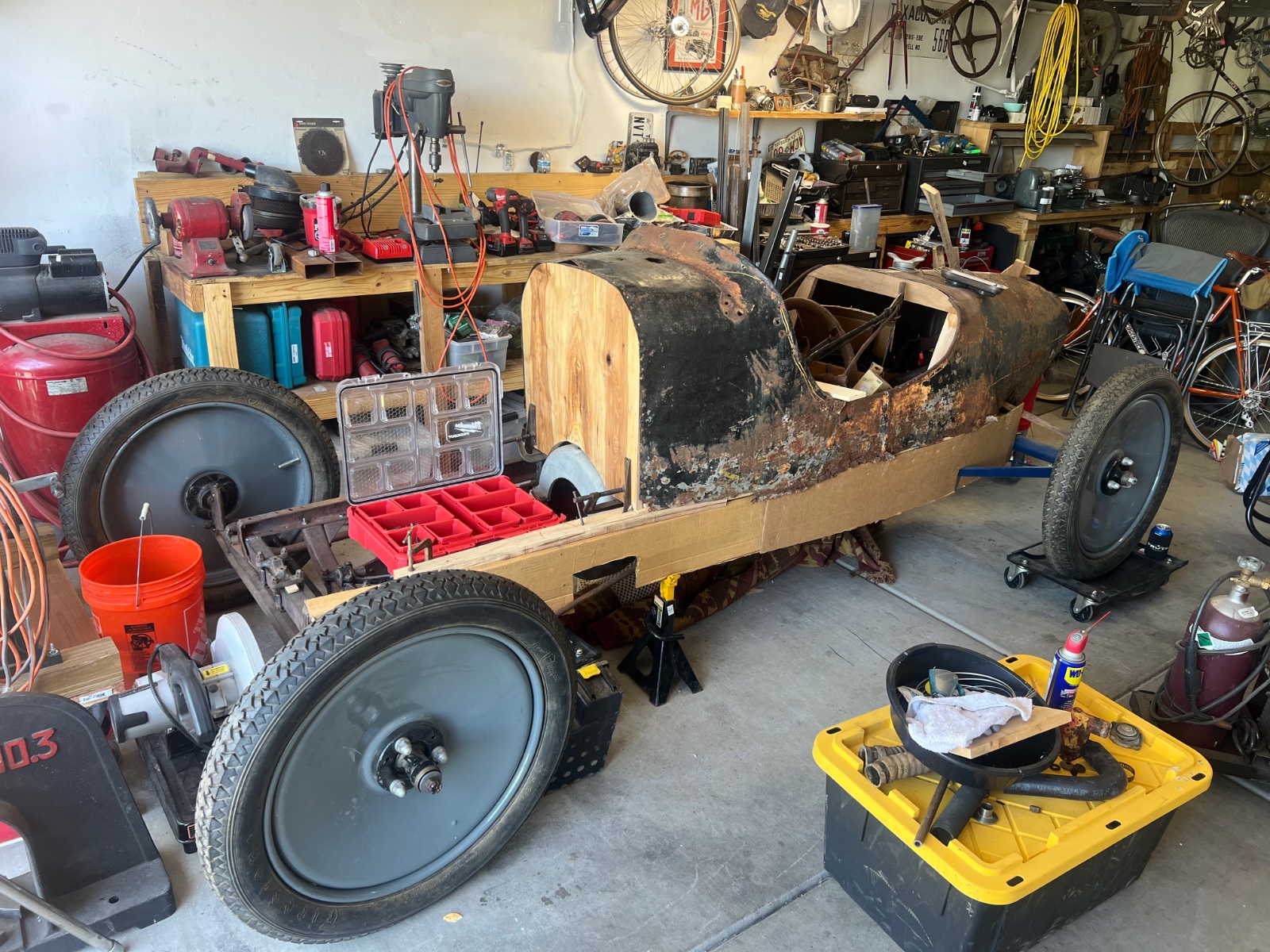

Realized I haven't posted many progress pictures...
106" wB, 6" engine set back, Warford, Disteels.

Next go at the shell, have a roller, but can't do a compound curve. Played with trimming and shaping the top part. Forgot that there was a great side profile in this thread. So back to at again next weekend.

Just saw this post on Facebook, one of the radiator for sale has what appears to be a Morton and Brett badge on it. It doesn't look like any shown on this thread earlier.
https://m.facebook.com/groups/183233695 ... tid=NOb6eG

Post by blauvelt » Sun Feb 04, 2024 8:08 pm
Started tearing into the engine, looks nice and stock. Someone did pistons at one point.
blauvelt
Posts: 264
First Name: Douglas
Last Name: Ogden
Location: Tucson?

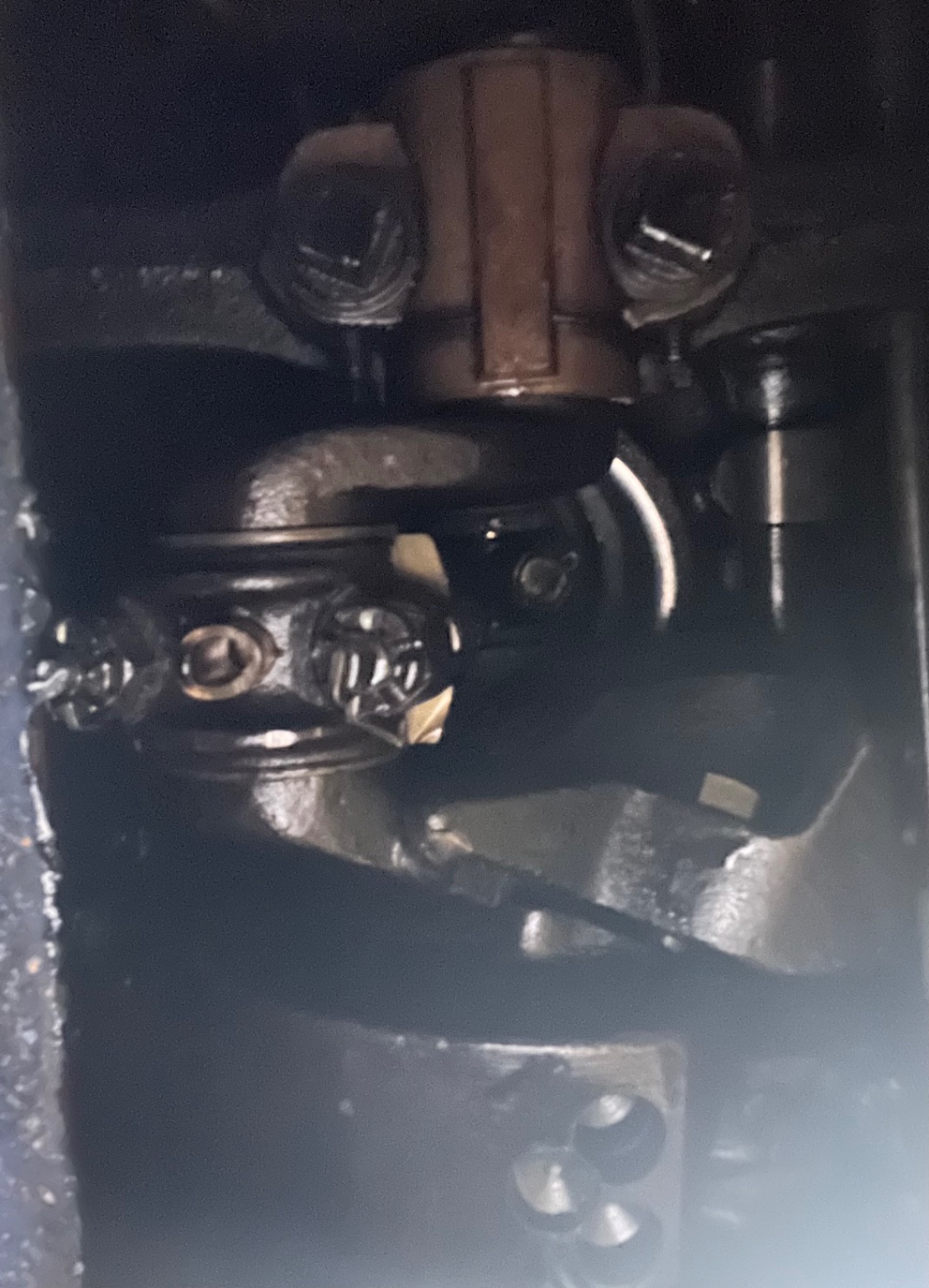

Post by blauvelt » Sun Feb 04, 2024 8:29 pm
Someone put 0.40 over aluminum pistons in it, adjustable lifters, and nice head. All in all a nice stock T. No clue what is up with the crankshaft, assume some sort of pastie weights?
Posts: 4415
Post by Wayne Sheldon » Sun Feb 04, 2024 9:15 pm
Look like Dunn counterweights on the crankshaft. Or likely reproductions made sometime in the 1960s or since. They were originally produced in the 1920s, and fit only the earlier style "diamond" throw crankshafts. Later, the design was altered to fit the rectangular throws of the 1925 and later crankshafts. Reproductions have been made of both styles, and I think a third "one size fits all" casting at various times in the hobby.
You may want to check out how well they were fit onto the crankshaft. They should be very carefully fit, and ground to match against any specific crankshaft because forgings actually vary considerably from one crankshaft to another. They need to fit properly against the crankshaft throws so that the special hardened bolts can be tightened extremely tight so that the weights cannot even begin to shift around in any way at all. And they also need to be properly fit so that the heavier casting of the weights when tightened do not actually cause a slight bend in the crankshaft. Even the slightest bend in the crankshaft can cause the crank and bearings to beat each other apart. (People think that adding the weights can't bend the crankshaft, but they actually can!) AFTER the crankshaft and weights are properly fit, then have the assembly dynamically balanced. Some people have recommended doing one pair of weights on the crankshaft, then balancing them. Then do the other pair, and then have them balanced again.
blauvelt
Posts: 264
First Name: Douglas
Last Name: Ogden
Location: Tucson?
Post by blauvelt » Mon Feb 12, 2024 10:05 am
Thank you Wayne, I'll pay close attention to them and share what I find (hopefully nothing abnormal).

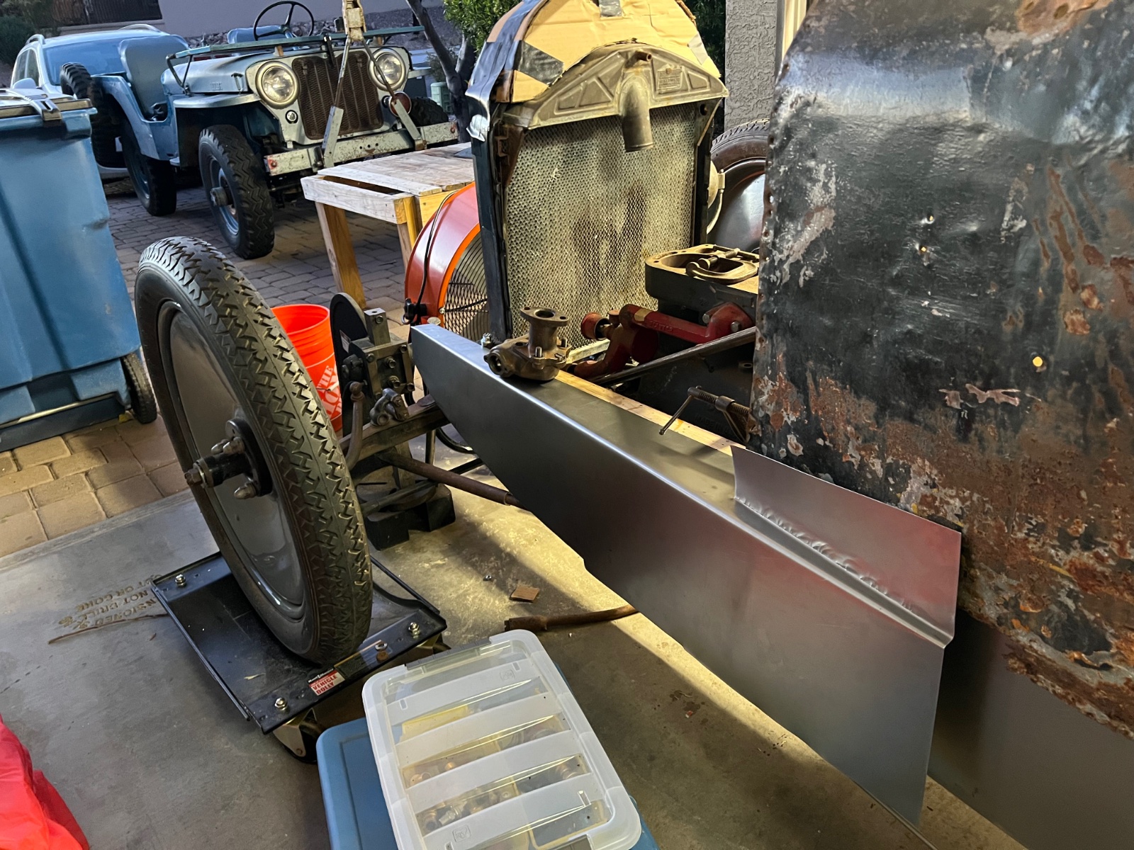

Post by blauvelt » Sun Mar 03, 2024 7:37 pm
made the first part of the lower valence. Rolled the sheet metal around a dowel rod. Also added eyeballs.

Post by blauvelt » Sat Mar 30, 2024 12:23 pm
First try at the front valence panel. Working on putting the beaded edge on a long curve. The original has an additional 3 folds to create a vertical lip which the bottom of the hood can be secured against. May try that on the next attempt. Who knew adult origami was this much fun.
