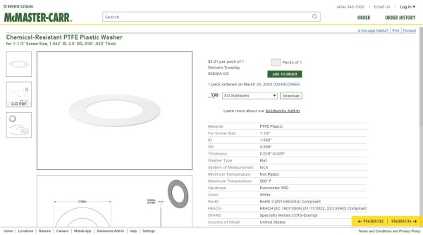

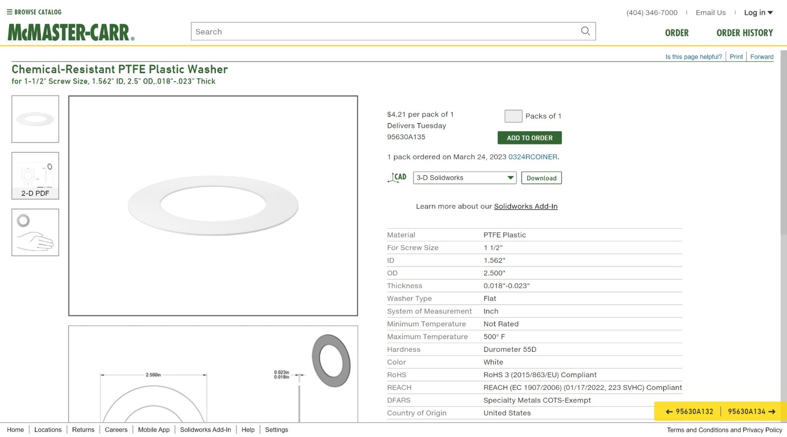

I have a ball bearing 4th main that still had oil leak.
Mar 2023 I added an PTFE "oil slinger" large washer. What I bought is attached below, but I bought both the 1.562 ID and the 1.50 ID but do not remember which I actually used, and it has made a huge difference in leaking at the 4th main.
