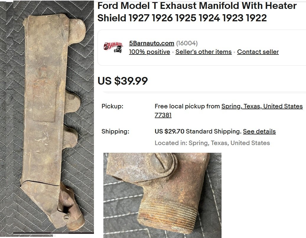

The plus on the exhaust manifold is that it not prone to warp but check the threads
The ARVIN on eBay
https://www.ebay.com/itm/134990497521?i ... R8ip1bjQYw --
https://www.ebay.com/itm/256283378615?i ... R9Sn5LjQYw --
The ARVIN on eBay

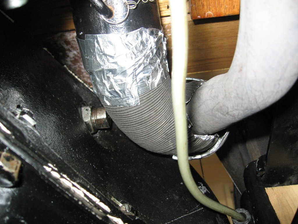

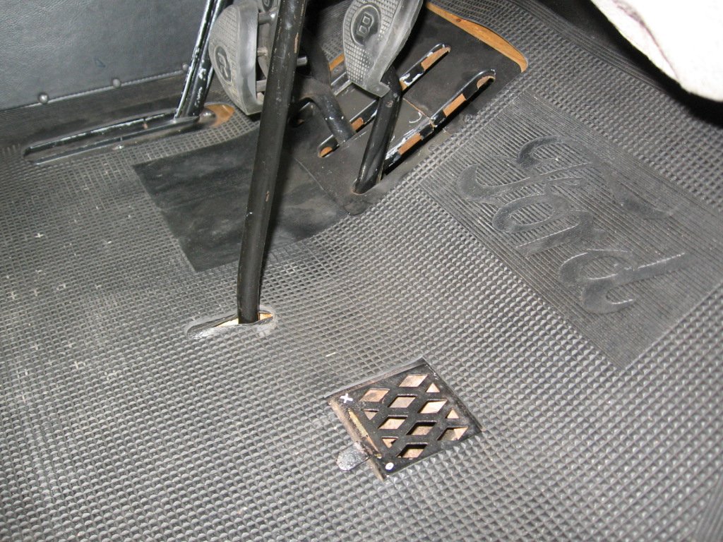

Here is my setup, I found the floor grate with damper on eBay and made the exhaust shroud out of a couple of pieces of flexible hot air intake hose that you can get at most auto parts stores. The shroud intake is down low, so it isn't visible from the engine compartment. Better than nothing!
- Attachments
- heater02.JPG (22.76 KiB) Viewed 2908 times
- heater03.JPG (15.15 KiB) Viewed 2908 times

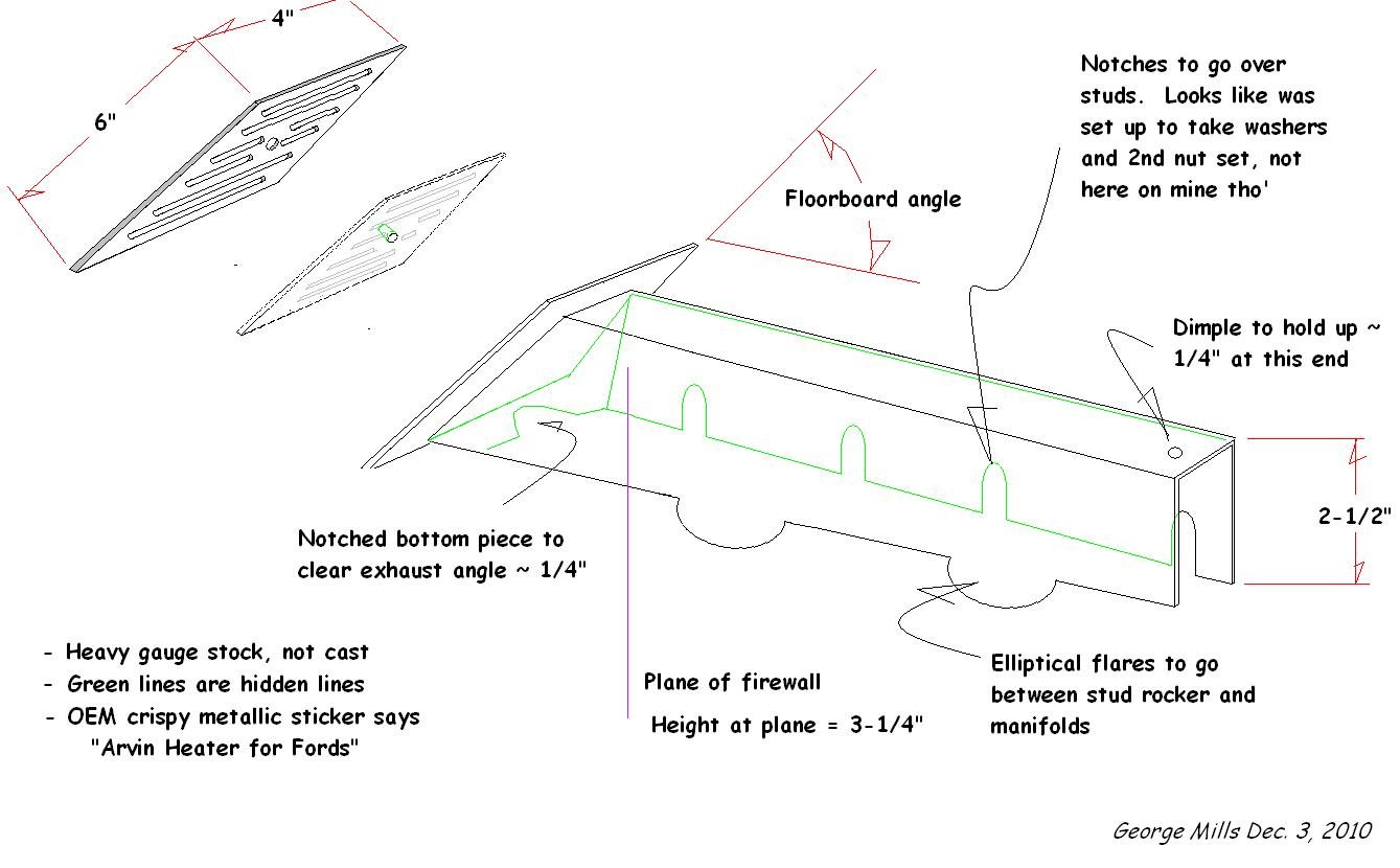

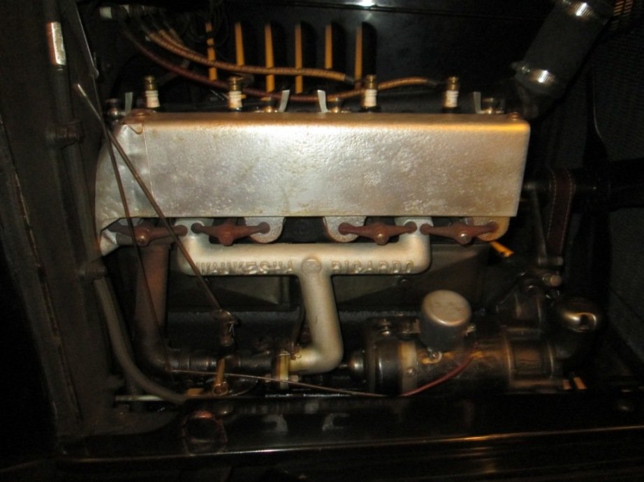

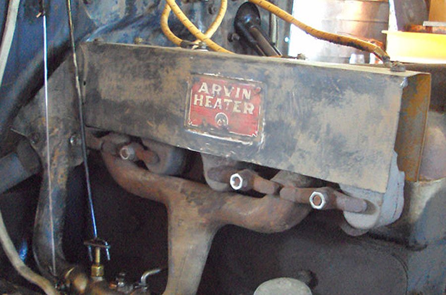

Re: Heater?
https://www.mtfca.com/phpBB3/download/f ... &mode=view
The heater label on the heater that TRDxB2 shows is not correct but one I copied and added on that heater. I'm sorry if I have added to the confussion. That was my best guess at the time.
