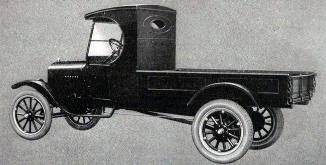

I am in need of some help. I want to replace the sheet of plywood the P.O. used for the floor of a steel TT Express bed/box. I believe there are 5 steel rub strips over the seams between 7 floor boards, 2 steel side strips for between the outer 2 boards and the steel box, and 1 steel strip across the back end at the tail gate to cover the 7 board ends.
Lang's sells the 5 steel rub strips and a hardware package for a Pick Up box (bolts, nuts, clips, and washers). I looked in the Encyclopedia, the Vowell Art Drawings, and on this forum, with no Luck.
Does anyone have an interior photo of an express bed floor? I need to verify my assumptions and count the number of bolts needed.
Thank you for reading this and for posting a photo if you have one.

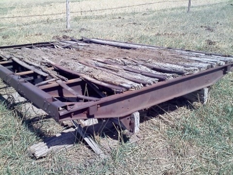

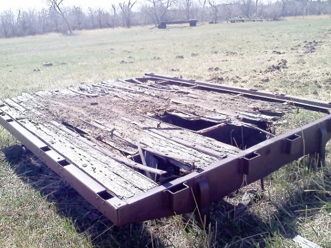

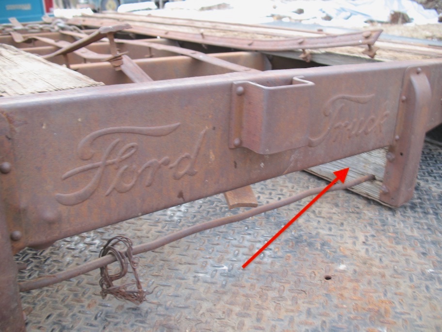

Here's a few TT beds showing the bed strips, could be 5 is correct. These are longer than the pickup bed strips of course.

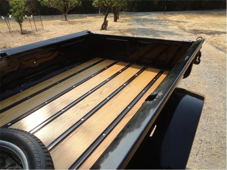

Not my truck, but is this what you are looking for?

Thank You Robert. That sure helps. Is this photo the same as your TT? I hope mine comes out as nice as the one in the photo.

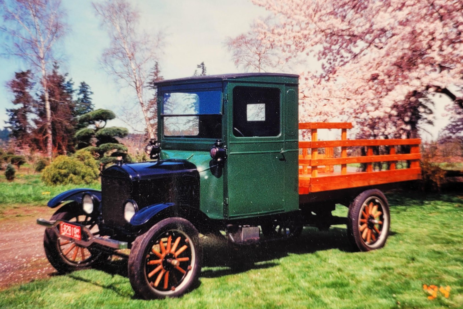

I wish that was my bed. My truck came off a farm without any bed. I am building a wooden grain/express bed for it.
