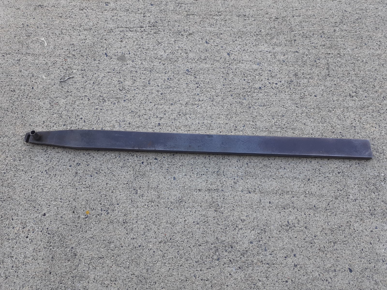

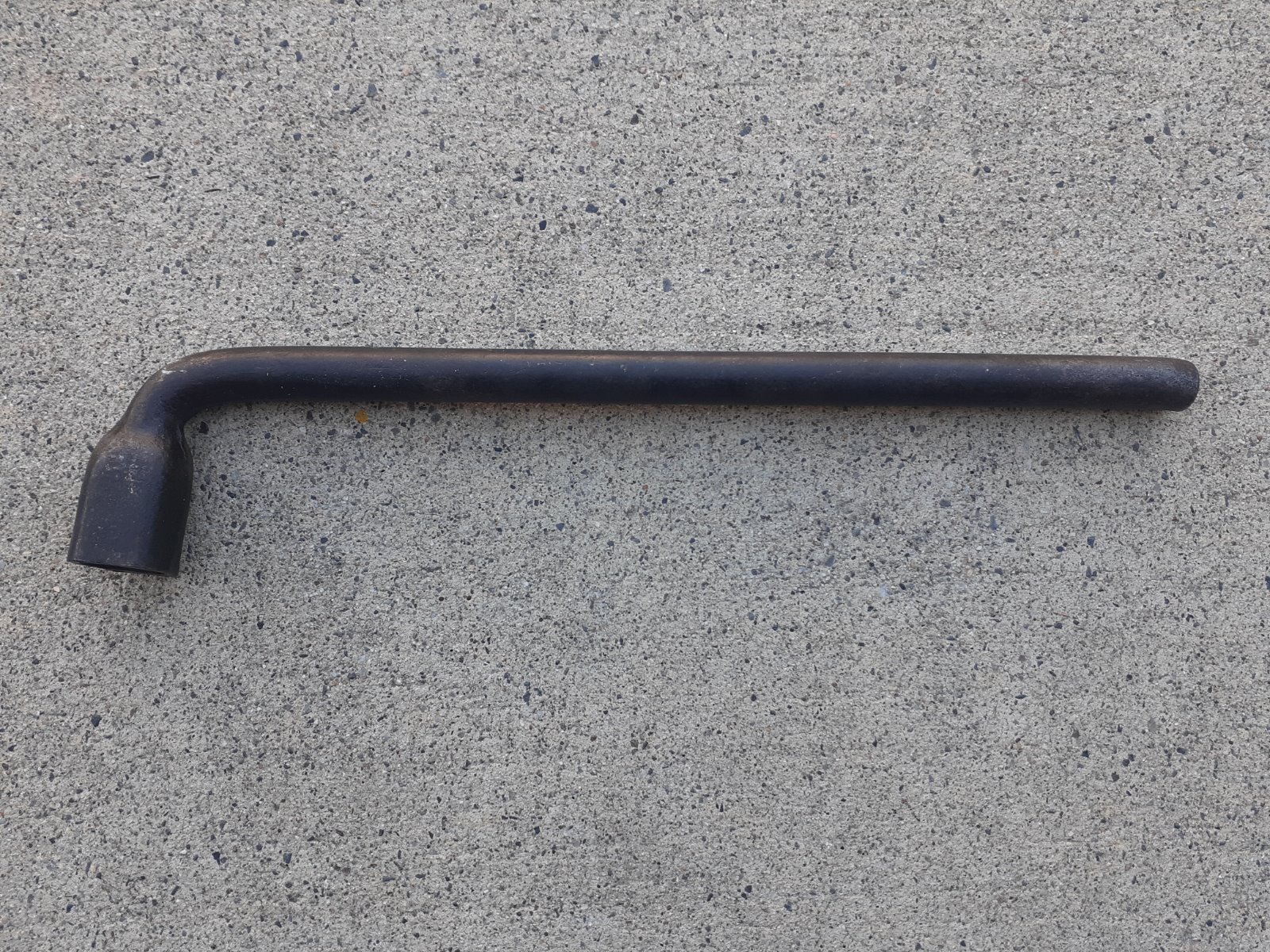

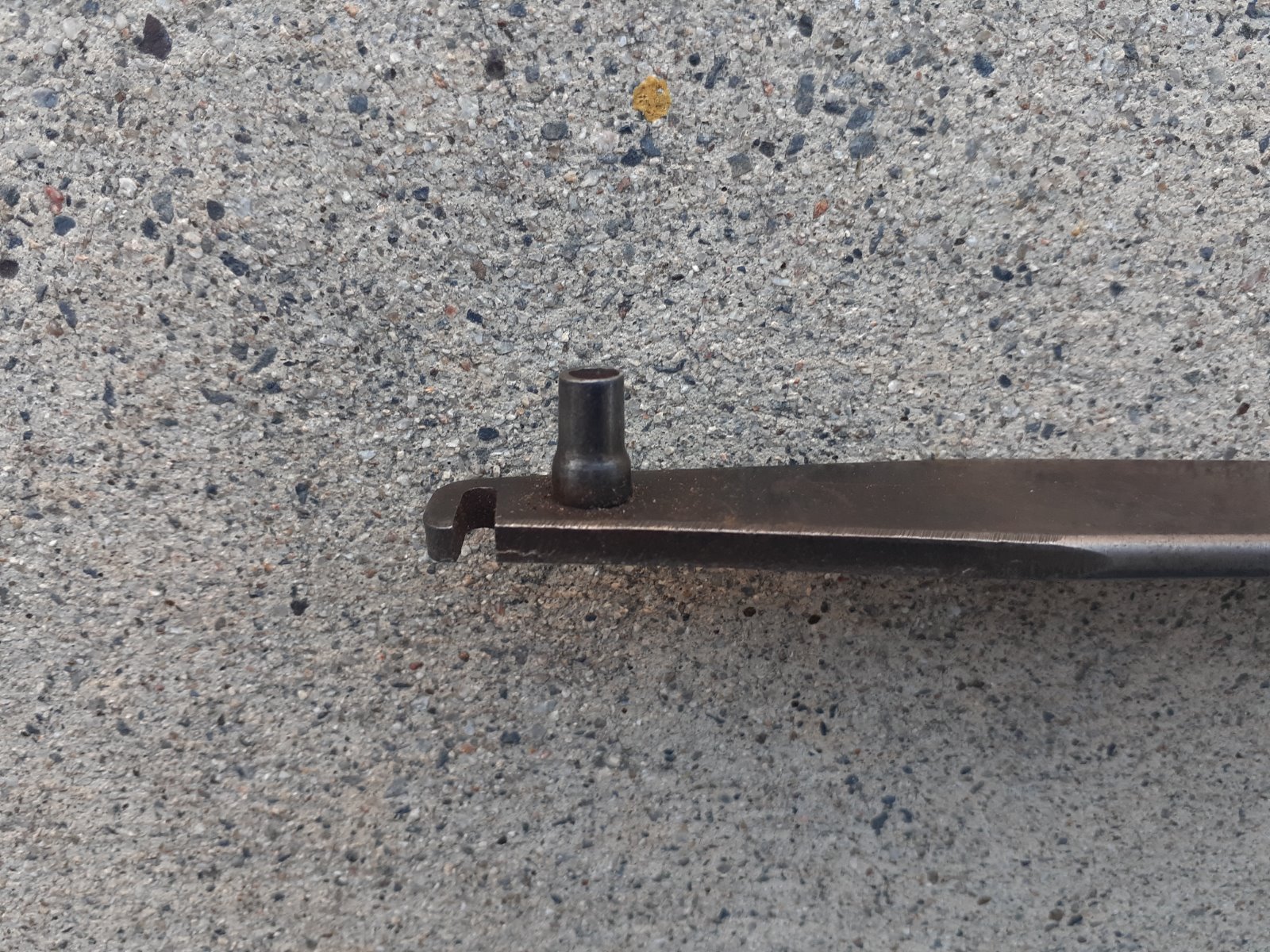

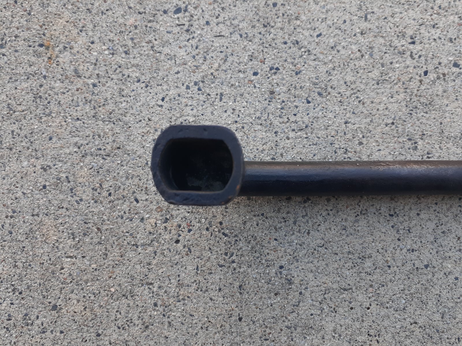

I have two tools I have been unable to identify. I believe they are "Z" tools; however, no visible marks to indicate that is the case. Any help would be appreciated.
First tool
Second tool
First tool
Second tool

Mark the second tool is likely used to make adjustments to LHD first gear. It fits the external adjuster by the looks.

I don't know the number, but the first tool is the "bar" for removing and installing the brake shoe spring on large drum rear axle. It is shown in the Service Manual in paragraph 1224.

Mark. I'm interested in both tools if you decide to sell them. Not sure about the second tool but the first is a brake shoe spring remover/installer as mentioned above.

The socket wrench is for early engines with main bearing bolt heads with simply 2 flats (not square)
- Posts: 7273
Re: Mystery Tools
Scott, that's what I love about this forum. One can learn something new every day. I did not know about those early main bearing bolts. Have you any idea what the measurement is across the flats? The square headed ones are 9/16".

Your early main bearing wrench is 3Z-619. Not all of them are marked.

That early wrench for 2 flat face main bolt heads is either 2069 in '12-'15 and then became 2341...
and the sq. head style is 2341-B....later in Feb 1917 the 2341-B became 3z-619.

And BTW, that bar for large brake drum shoe spring is 5z-1157 Pry Bar (rear brake spring)

The main bearing wrench for the square headed bolts started as 2341-B in Oct 1914, was changed to 3Z-782 in Feb 1917, and later changed to 5Z-156.
The early main bearing wrench for the bolts with two flat sides started as 2341, and was changed to 3Z-619 in Feb 1917. It was still available until June 1922, but apparently became obsolete. There is no record of it changing to a 5Z number.
