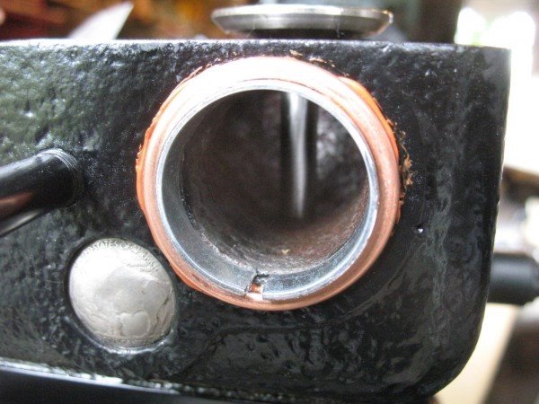

This picture was posted in an earlier topic. I have some pitting on my block, and I want to get some of the High Temperature RTV that's mentioned in the post where this picture was.
What High Temp RTV should I get? If you have a picture of the tube, please post it.

That's my pitted block in the picture.
I used this Permatex product. It's fine. It seals, and when I removed the manifolds after almost three years of driving (including Detroit and back) it was unburned. The label says red, but as the first picture shows it's closer to orange.
