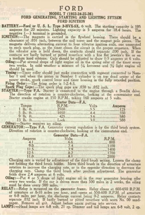

Here's some of the information that Jeff referred too
Adjusting the Model T Generator Brushplate Null Point with the Generator Installed by Ron Patterson
https://modeltfordfix.com/adjusting-the ... patterson/
Testing a Model T Generator Armature Using a Growler
https://modeltfordfix.com/testing-a-mod ... a-growler/
Generator Repair or Replace discussion
https://www.mtfca.com/phpBB3/viewtopic.php?f=2&t=37795
Repairing a Common Model T Starter Problem by Ron Patterson
https://modeltfordfix.com/repairing-a-c ... r-problem/
another of Ron's
