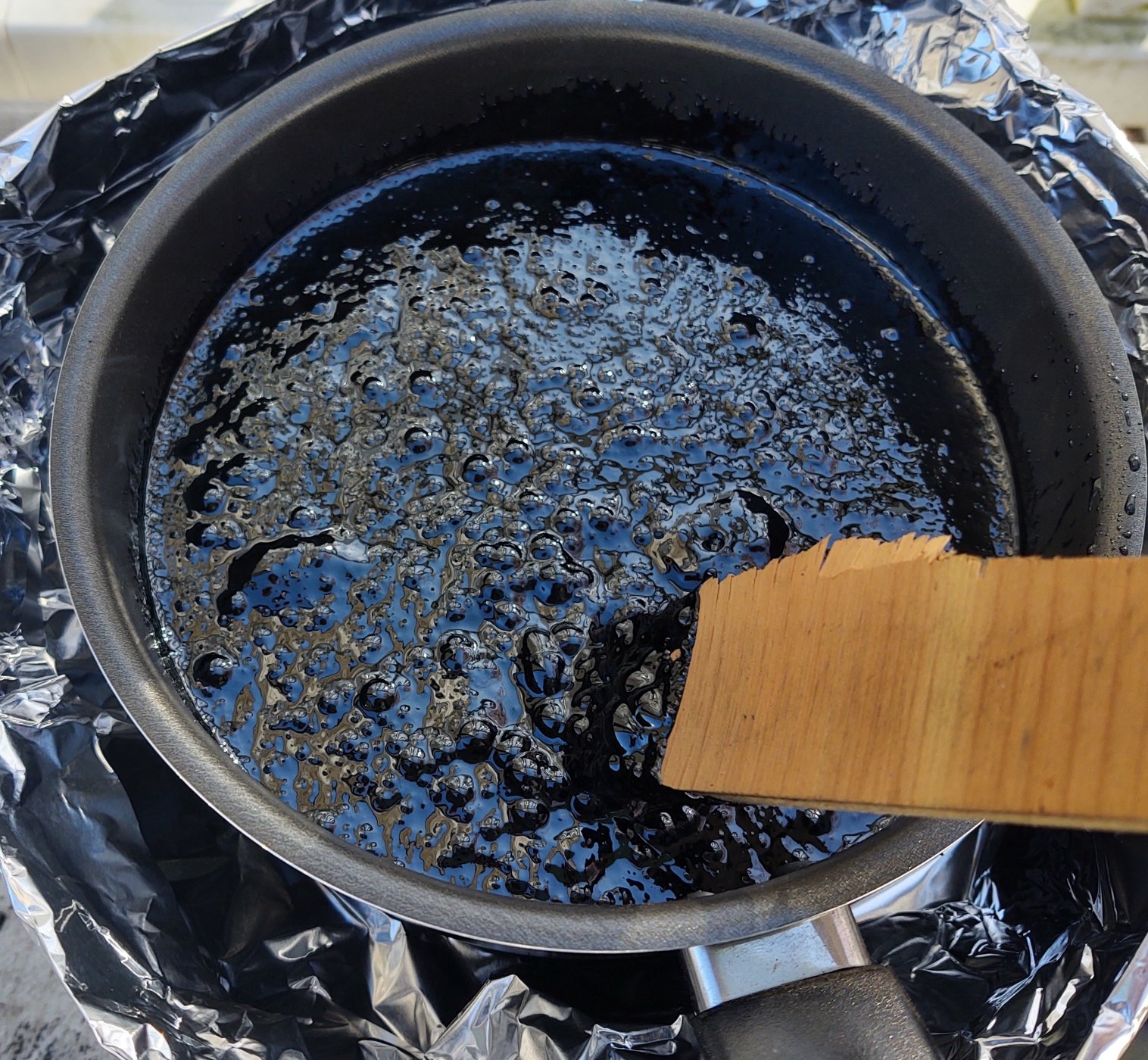

Post by Moxie26 » Sun Apr 07, 2024 9:06 pm

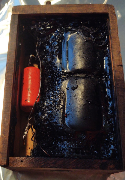

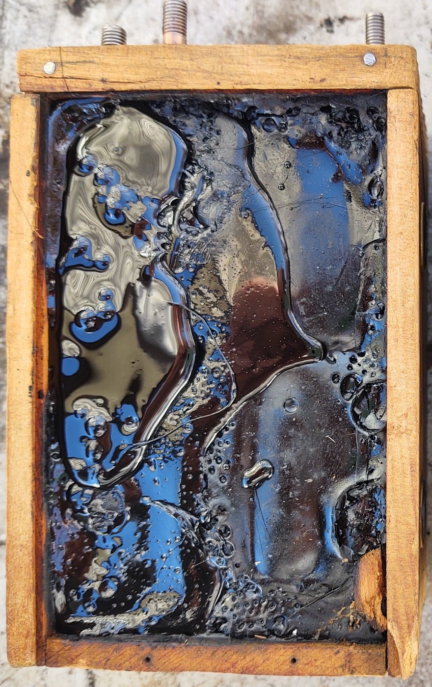

New capacitor , soldered leads , and re-potted with hot tar

Post by Moxie26 » Mon Apr 08, 2024 6:42 am

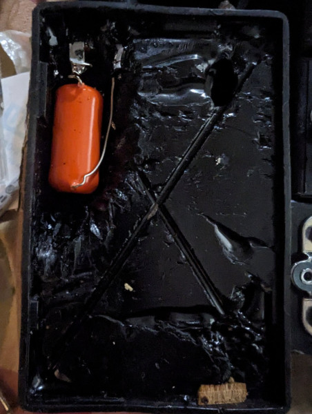

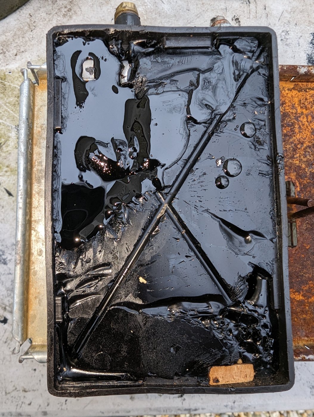

Later made Plastic case coils... Capacitor, replacement and potting

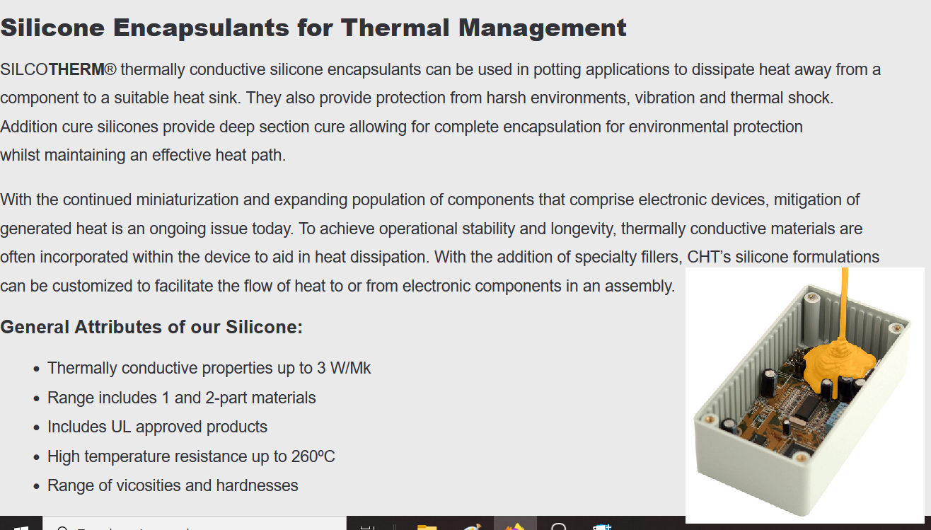

A solar flare hit me & was wondering if silicone casting material would be a good choice for filling a coil unit. Its non-conductive and would be easy to remove later if needed be. It could be applied in two sessions like making a mold, to make it even easier to remove. Tar was about the only solution back then as an insulator.
Maybe ?

I think the main question is how would the silicone or the aerosol filler adhere with the tar that's in the coil to make one solid unit.

Moxie26 wrote:
Mon Apr 08, 2024 5:18 pm
Why do they, or other options, need to adhere to any residual tar that's in the unit? The purpose of the tar is just to prevent things from moving around. Its just a filler that is non conductive as the other options. I'm saying fill the box.
The foam expands and would prevent wires etc from moving

Post by Moxie26 » Mon Apr 08, 2024 6:11 pm
After replacing the condenser, soldering the connections, repotting with Hot tar will assure the adhesion to the tar in the rest of the coil unit and this way from Rocky road, vibrations and engine vibrations will eliminate wire breakage inside the coil
