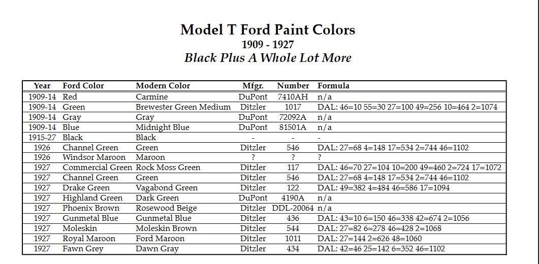

From the Forum's Encyclopedia
Other sources
Other sources

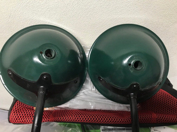

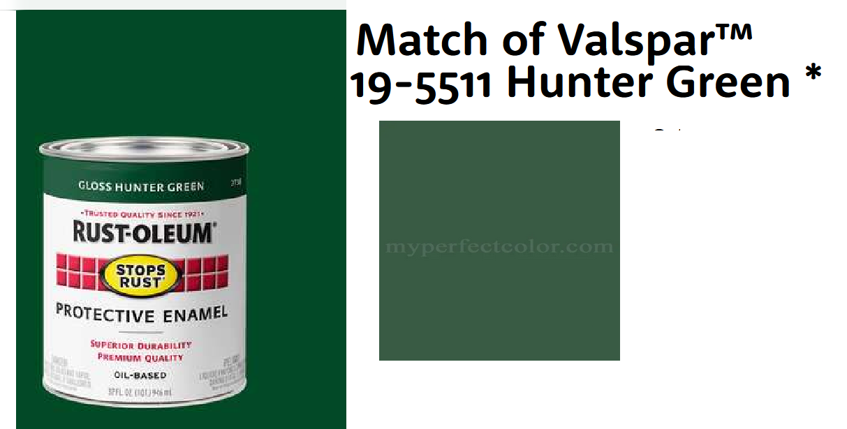

I used Valspar Hunter Green of these buckets. Had some Rustoleum Hunter Green in a spray can that was a shade darker than the Valspar
Cameras & individual computer screens render colors slightly different. But the Headlights displayed on my computer screen match to the real ones

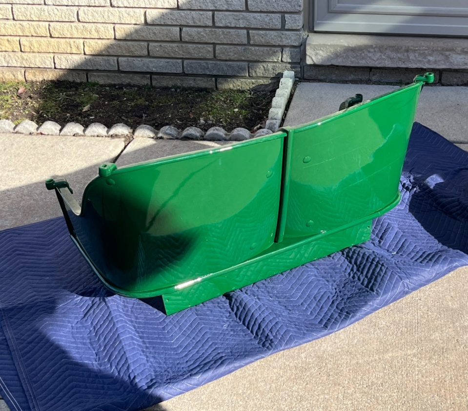

Re: Highland Green?
I know someone was talking about rustoleum hunter green I went to the paint store and had a batch of ppg paint made up to match it for the painter to spray on the body, I did the frame in oil based brushed rustoleum hunter green. Here’s how it came out, it does look maybe a touch light compared to what the later green cars seem to normally be.
Matt
Matt

Re: Highland Green?
That looks like what I've seen labeled "Machine Green". The same shade of green might be sold under 100 different names over a period of years.
A spectrographic analysis of some original paint might reveal the pigment formula.

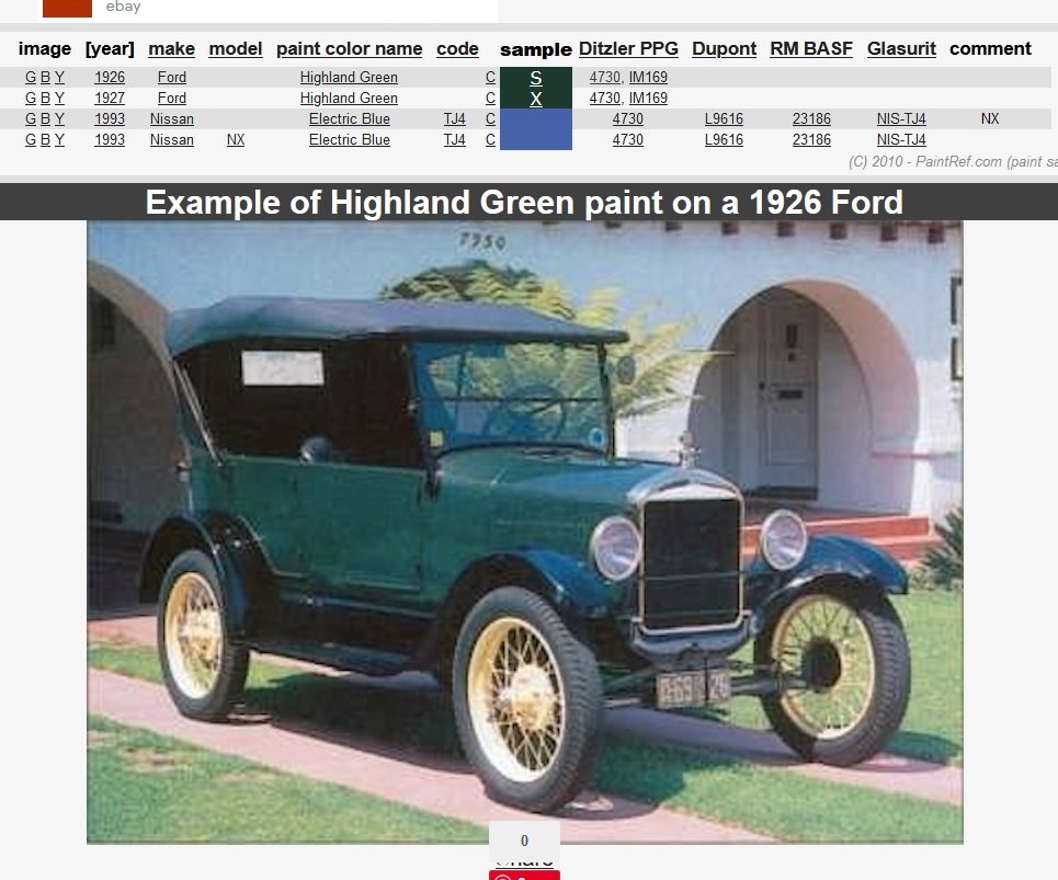

You have permission to use the image of my 1926 Touring above. No extra charge.
That photo was taken back in 2000 when I first bought the car. It was photographed in the driveway of a 1920s Spanish Revival style house near where I live in the city of Downey.
I've since put a different pair of YOM license plates on it. I've seen that photo used many times.

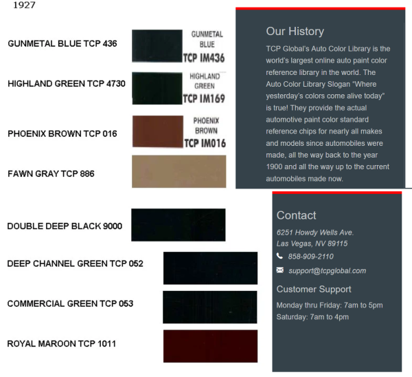

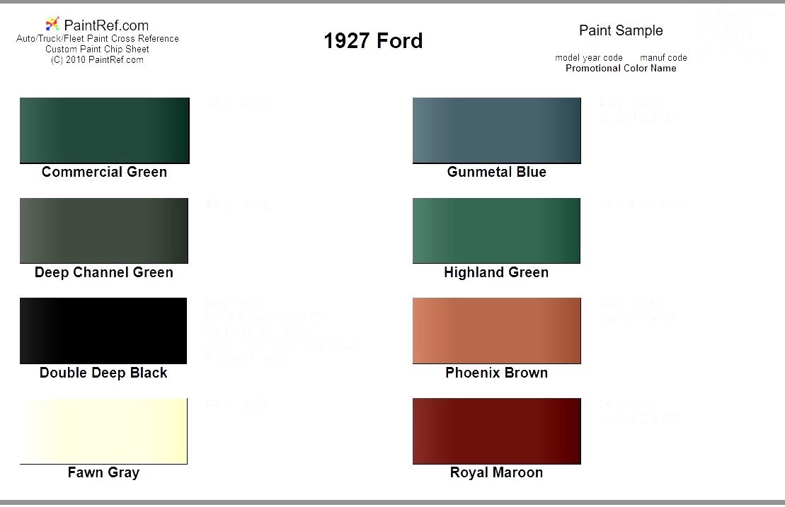

A paint source (colors don't always show correctly on computer screens)
https://www.autocolorlibrary.com/pages/1927-Ford.html
https://youtu.be/Qqnp-JBko0Y
- Posts: 7278
Re: Highland Green?
As Frank points out, colours on computer screens often vary from reality. The green tourer looks nice on my screen, but if it is compared with the green lawn, the lawn keeper has a problem. There is no real alternative to seeing the colour you want in real life, somewhere and on something.

Oh my…. sorry about that picture of your car sir. It’s what came up on the Internet….. you’re famous…. And I plagiarized….lol
Thanks for being such a good sport

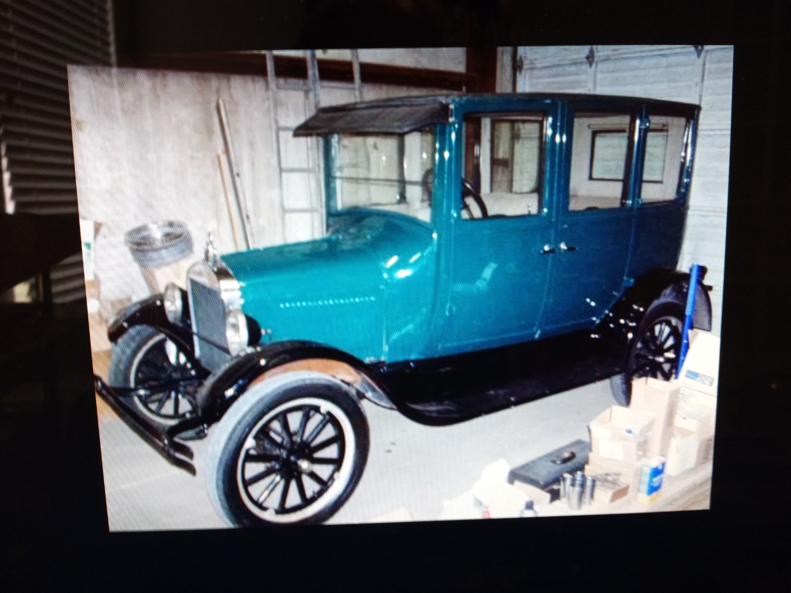

I own a 1926 fordor that came to me out of Pennsylvania, by way of Valdosta, Georgia. I don't know who restored it in Pennsylvania, but while the paint job is of nice quality, if I had chosen the paint color, it would have been gray or maroon; anything but green. While i have nothing against John Deere tractors (my Dad owned plenty and combines, too) every time i look at the car, I think John Deere green. The car is going to be for sale when I get around to fixing a thing or two on it. The car 's paint looks blue due the the light in the storage unit, but it is Green.
