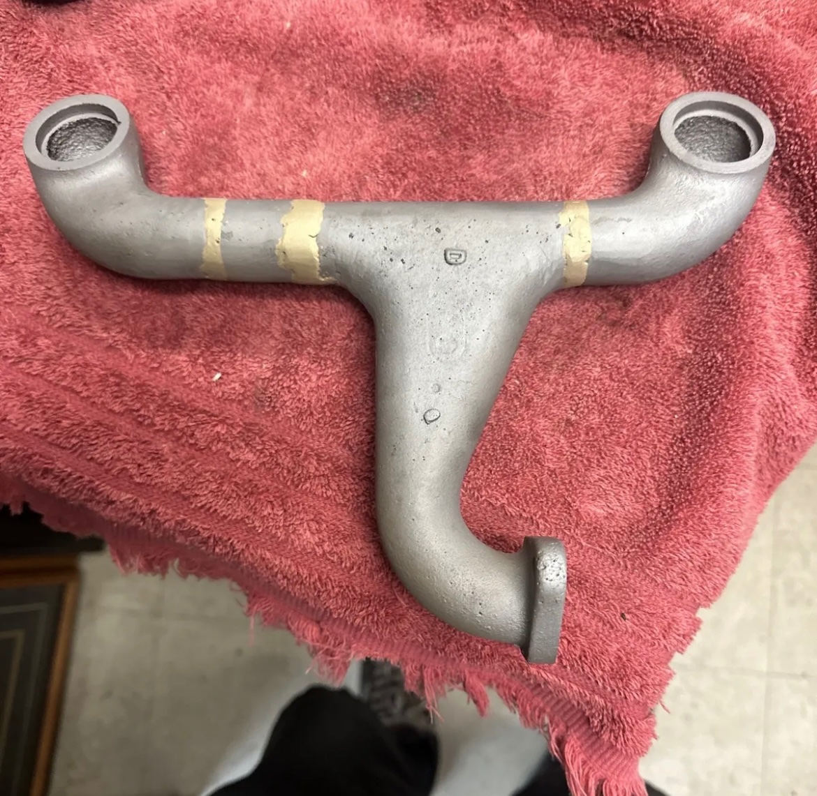

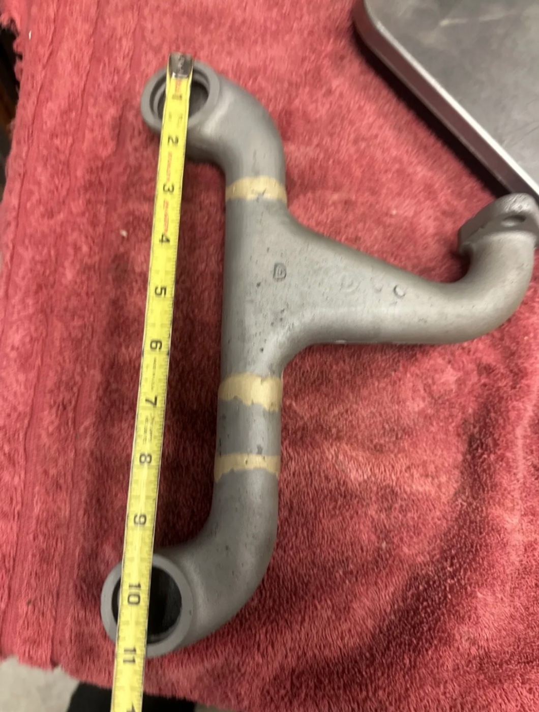

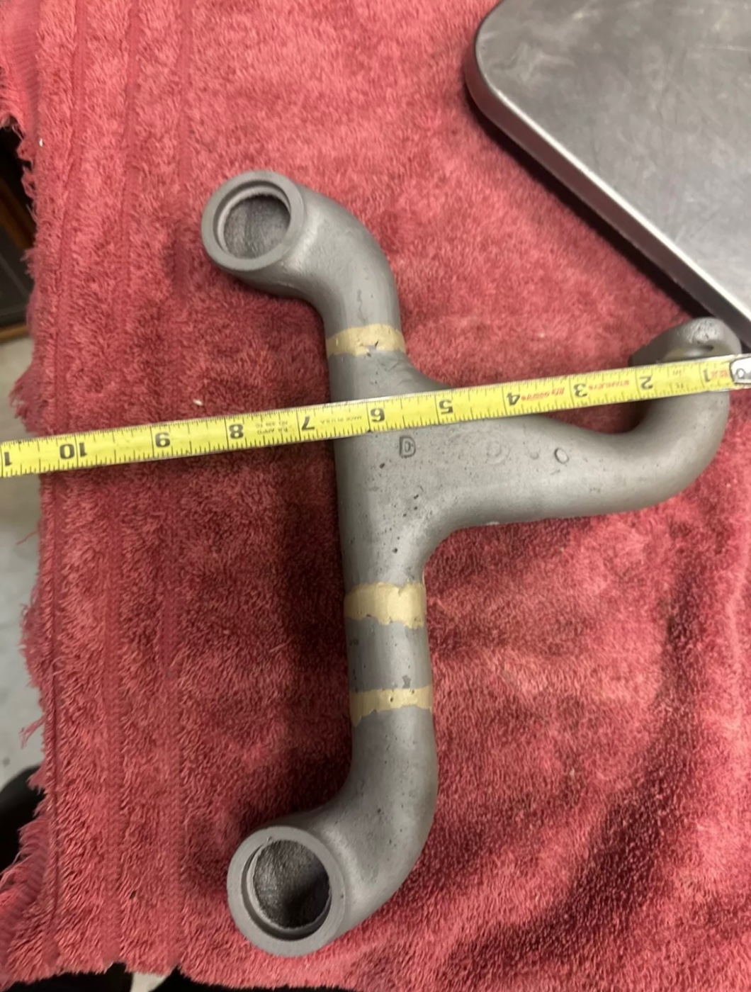

Surfing the web looking for an aluminum intake and chanced upon this. Measurements are good. So why?

To put in a larger generator, or one with maybe an oil pump behind it.
- Posts: 4380
Re: Why the need to change?

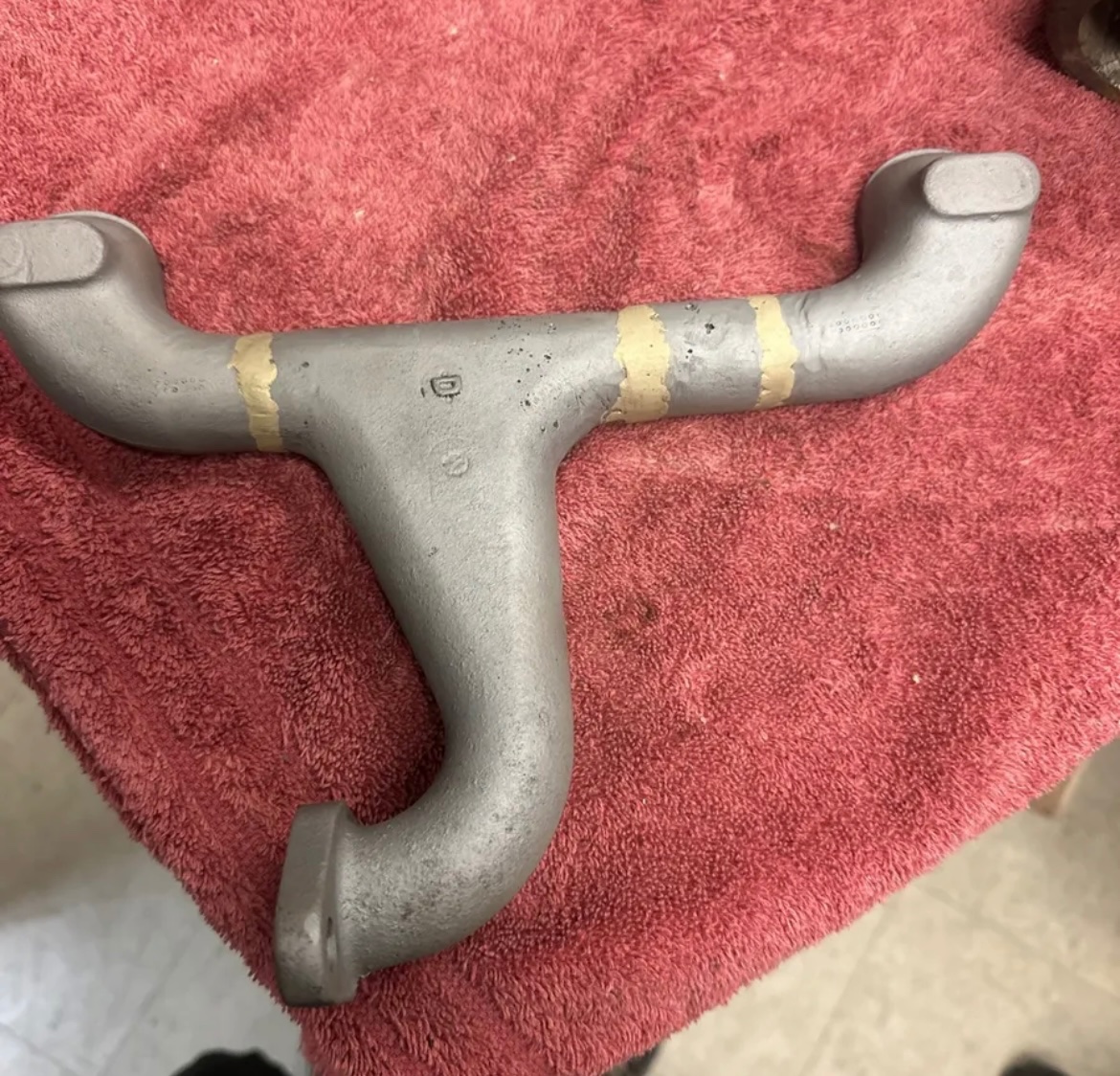

It would really mess up the "Y" flow pattern. The number 3 and 4 cylinders would run stronger and richer than cylinders 1 and 2. If someone wanted to do this for some reason, it would work a bit better if the triangle "Y" was turned end for end to compensate somewhat for the change in flow distance.
- Posts: 4380
That of course would require turning the bottom piece around.

Some folks feel that 1 & 2 tend to run richer than 3 & 4. Maybe this was an attempt to "correct" that?

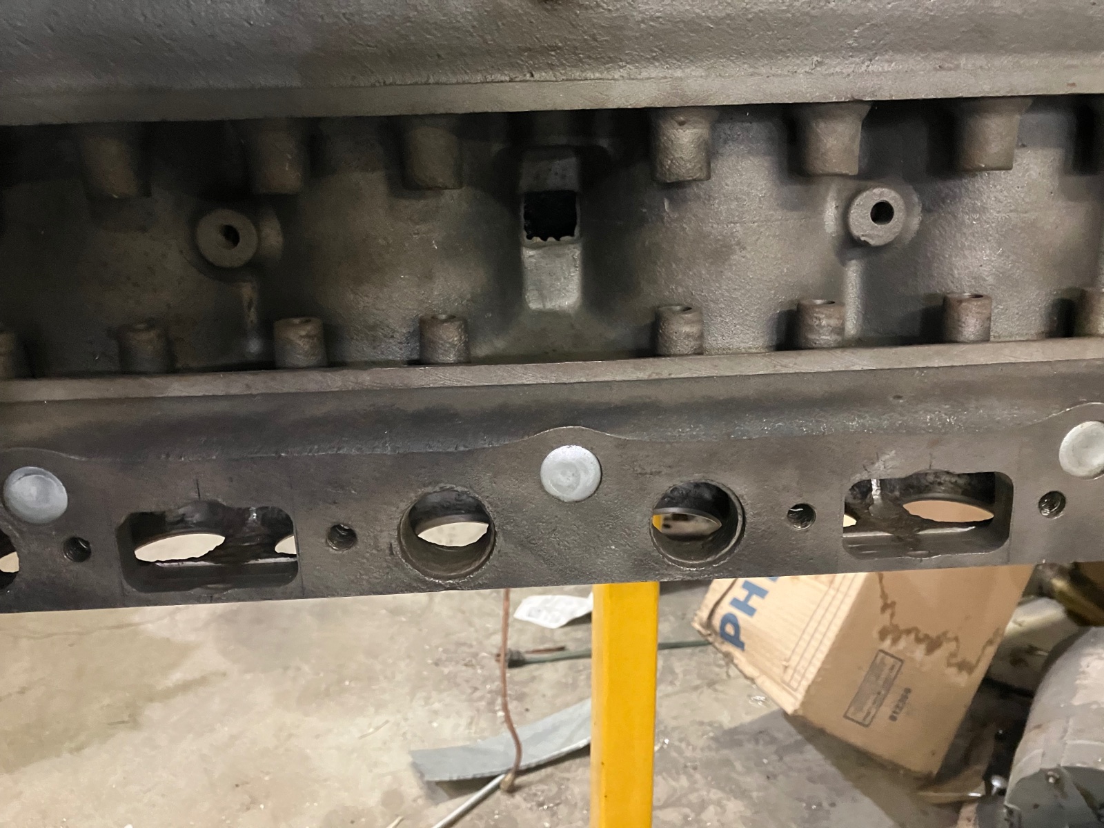

On the other hand, I would guess that it was to provide more clearance for an oddball magneto adapted to a Bosch front plate unit or similar. The DU4 already is pretty close to the manifold, other larger magnetos would probably touch. But definitely for something being driven on the side of the engine that was touching stock manifold.

My thinking is that the 1-2-4-3 firing order is off so far that the manifold is of little concern. No modern inline 4 cylinder engines use that
firing order????? I may be full of bravo sierra but I thought that firing order of Winfield's 2 up 2 down had much to do with firing order?

With the typical four cylinder crankshaft for balance reasons cylinders 1 and 4 are opposite in stroke to cylinders 2 and 3. All options for firing order has cylinders 1 and 2 fire next to each other, and cylinders 3 and 4 fire next to each other. Any inline four with a normal crankshaft and only two intake ports is going to struggle to have identical charge in the adjacent cylinders (1 & 2, 3 & 4). Modern engines deal with that by having individual intake passages for each cylinder. The 2 up, 2 down method achieved alternating intake pulses for more even intake charge, at the cost of horrific vibration acceptable only in a race car.

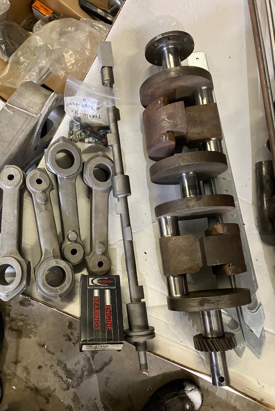

My 2 up 2 down crank (and cam and rods). If you look at the counter weights vibration is not likely to be a problem!
Les Schubert
- Posts: 1364
- First Name: Les
- Last Name: Schubert
- Location: Calgary
Another solution to the limitations of the T firing order. I have had great success with!

Another thought: Was/Is this manifold advertised to be an aluminum intake manifold (if that is what you are seeking)? It looks like whomever modified it cut it and reassembled it using brass to braze the pieces together. You don't braze aluminum. You can braze cast iron, and sandblasted cast iron can give the appearance of aluminum. I saw this on EBAY when it was first offered and thought the same thing as others; someone modified this manifold to move the carburetor further back. i didn't think about it upsetting the flow characteristics, but I'm sure that's true.
