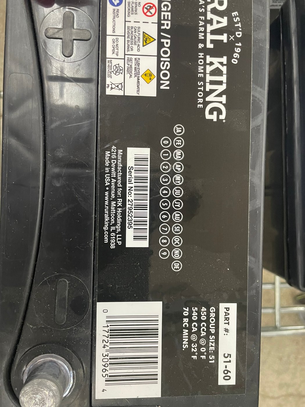

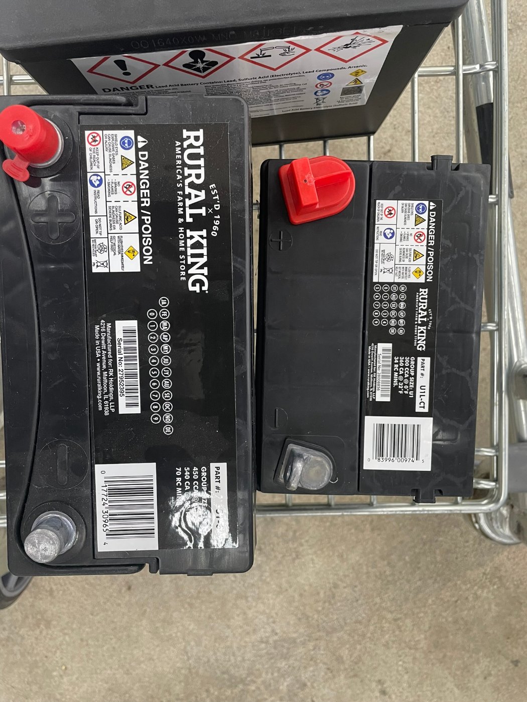

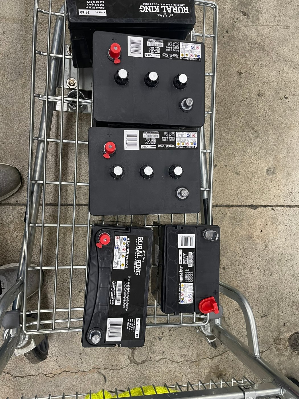

To update everyone on this, we wound-up purchasing a Group 51 series battery (-amongst 4 other batteries) because the Group 51 gave about 180 more CA than the smaller diesel garden tractor battery did. I think this Group 51 battery should fit the 'need' nicely but time will tell I suppose.
FWIW, this Group 51 battery was about ½ the size of a Group 24 battery, ...and you can see its physical size when compared to the Group 1 6v battery next to it.

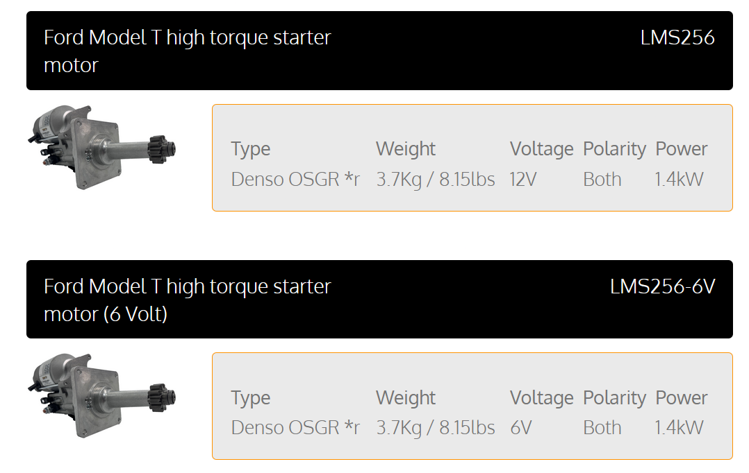

Thanks for the details on that 'little' 12v battery. That should work fine for the modified 12v T starter.
Here is torque specs on the 12v modified.
A typical well working T starter on 6v will put out good 8-10 ft/lbs of torque, plenty to crank over a cold engine.
And that little battery is good for running board battery boxes used on early cars. Am putting a running board battery box on the '12 project (has a '13 frame, and don't want to drill and use the later Ford chassis holder.)

Glad you found a solution, congrats on a Wasp starter. You are correct about the charging issue with Optima batteries & they require a special
trickle charger to maintain them ( most good quality chargers now have a setting for AGM batteries). It has been my experience that the lawn
& garden mower batteries work fine with a straight 12VDC conversion using a T starter & generator. Starter engagement is softer & they charge
up pretty fast with the generator. IMHO. Now everyone is free to bash 12volt conversions in a model T
