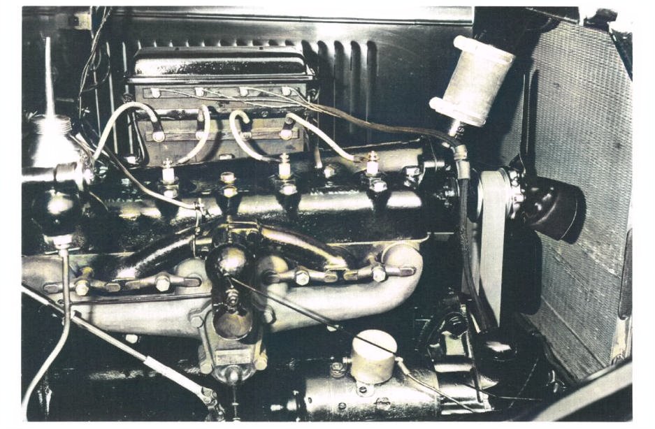

Tried to colorize an old photo. Didn't change much but looks like unpainted wood. We do know that Henry wouldn't add a process if it was unnecessary and added cost.
