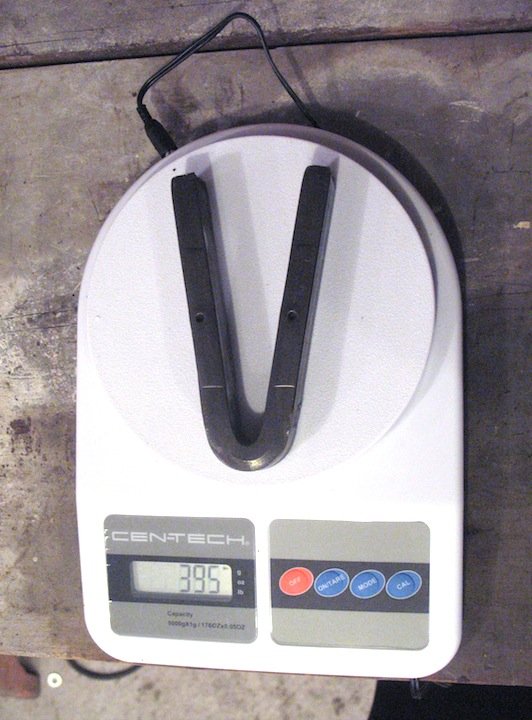

- Posts: 7411
Re: magneto issie
This may have been overkill, but I took a little off some of the magnets to get them all the same weight.
