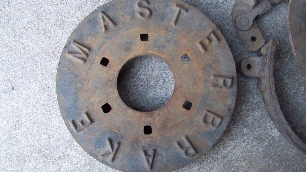

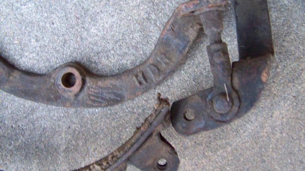

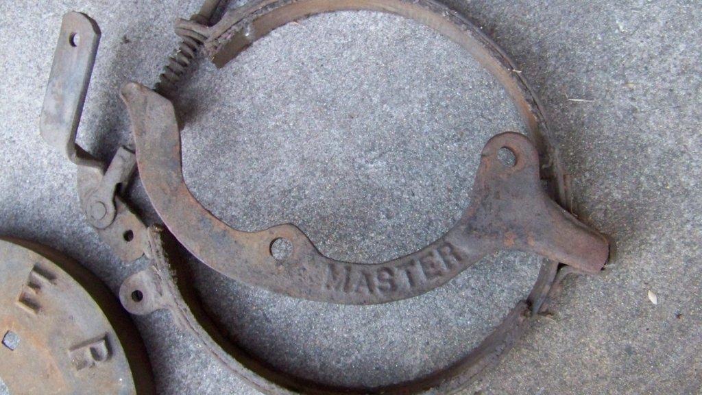

These photos of 'Master' brand were posted a while back.  Seems to be similar to Rocky Mtn.
