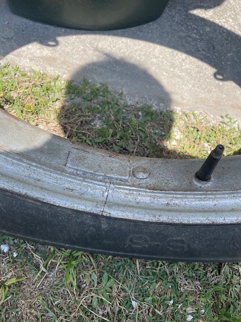

I have ‘rollers’ that I’ve never worried too much about. Today after moving then out of the garage for a week and then placing them back today.
Look at the picture, please. This been welded? Or am I missing on how this particular latch works? Tube spun as you can see, at least want to straighten it out. Old eyes, not ready to get into it and find I can’t unlatch it

The short piece (right) sits in a rectangular hole. There was a latch that pivoted in the plugged hole.
The latch sat on that small shelf in the strap. Looks like a heavy coat of silver paint, not welded on the right side.
Tap it with a rubber mallet & see if a separation joint becomes more obvious.
If you are not familiar with this type of split rim, search the forum for pictures.

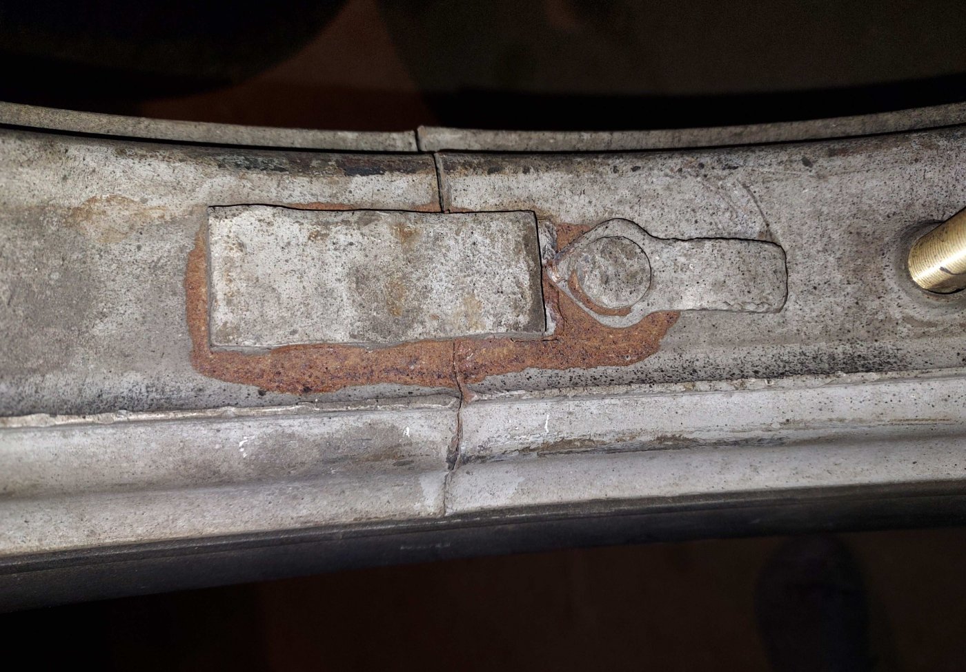

Re: Demount tire rim.
This is what it should look like.
You could put that rim/tyre on the opposite side of the car, under inflate it somewhat and take a slow drive until the valve stem is upright again, if that is your only concern.
Thanks all, I never noticed when I bought the 4 ‘rollers’ at Hershey that this one was different until today.
I’ll prob take Allan excellent advice and run it backwards on the next time I use a ‘roll’
