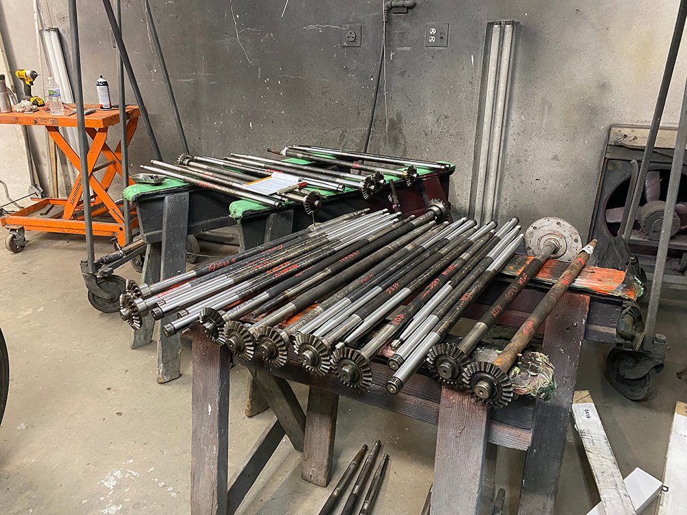

Loose wheels are the most common cause of rear axle damage / failure. On cars I've worked on about 8 out of 10 have needed new axles. Cracked or wallowed-out keyways, deep scoring from the hyatt bearings, worn tapers, etc.
When inspecting a club member's car I frequently find the rear axle nut loose. It is important that you initially torque it to around 80-90 ft-lbs and then after 100 miles or so, check it again. You may be surprised to find you can get some movement out of the nut (like one castellation.) I check mine each spring before touring season.
I strongly recommend you consider installing floating safety hubs. They transfer much of the load from the axle to the axle tube, and replace the outer hyatt bearing and seals. They require no service and as an added bonus, won't let your wheel fall off in the unlikely event that your axle breaks. The new axles are about 1/16 inch longer which helps with clearances.
The attached photo was taken at the shop of a well-known Michigan antique car restorer. He tries to do a bunch of Model T rear ends at the same time (like an assembly line) and these are axles that needed replacement (and a few new ones). Two of my friends have axles in that pile. The gears are a particular PITA to remove and install. He modified a hydraulic press to make the job a little easier.
