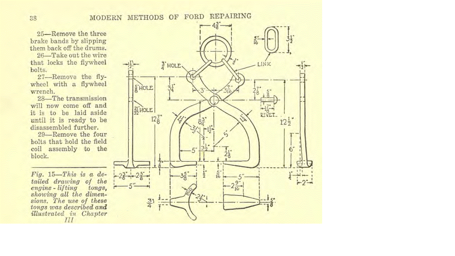

I would like to see the thread on engine lifting tongs. Could someone show me a link to that discussion?

Herb ; I use this to lift the Engine

See Modern Methods of Ford Repairing, page 38.
