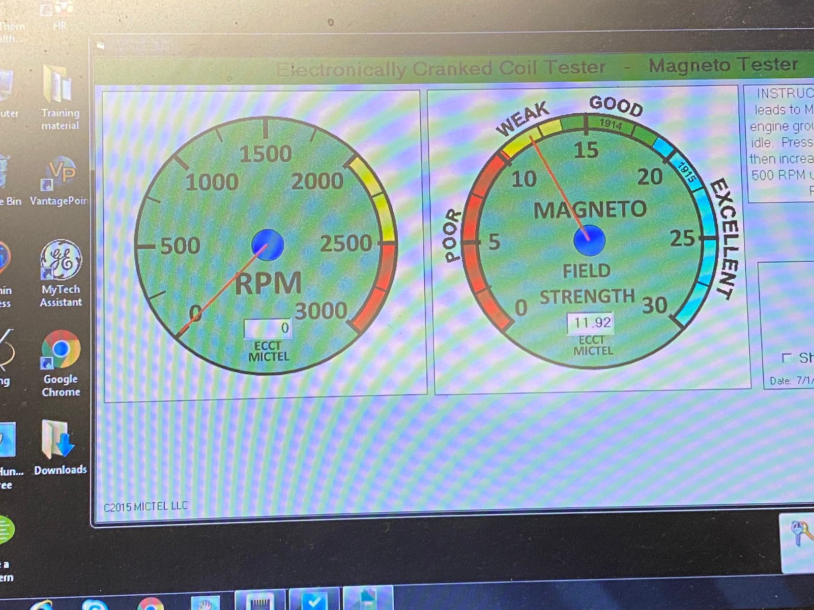

More information to add. I cleaned up the magneto contact and now I have a reading on the magneto meter. That is the good news. However I read about 6 1/2 volts at idle but just 10 volts at RPM verified with my fluke meter. What should I see on the mag at RPM? Needless to say that will not charge the 12v battery! Still do not understand how the wiring is set up such that It will not run on mag. Is it likely that a change was made internally in the coilbox/switch?

I have a magneto meter the same as Dan above posted with a picture. The Magneto Meter and my Fluke agree on the voltages at both idle , 6 1/2v and at higher RPM, 10 v. The voltage does not exceed 10v.
- Posts: 7330
Re: 1912 modified for mag to charge a battery
...the voltages at both idle , 6 1/2v and at higher RPM, 10 v. The voltage does not exceed 10v.
Your magneto is weak. At road speeds (20 to 30 MPH) it should put out plenty of voltage to keep your battery charged. See the chart here: https://www.mtfca.com/phpBB3/viewtopic.php?t=11870

Before you get too carried away with removing the motor or re-magnetising could I suggest you first measure if there is any DC charge current (NOT voltage)? Now that you've cleaned up the mag connection you may find in fact that the battery is being charged in use, although be aware that with a magneto system it won't be at a high rate.
FWIW the reason I suggest checking is that traditional AC meters will measure average (.636), but be calibrated in RMS (.707), whereas what matters to you is DC volts, which should be very roughly 1.4x the RMS. Thus if you have an AC meter reading 10V then the DC voltage (after a rectifier) will be about right for charging your battery (albeit crudely). There are other factors in play here too, including the electrical noise that a T will generate, and the magneto waveform and how meters will react to that, but for the present these are probably safe to ignore.
Note I make these comments without being specifically aware of how your machine is wired, so it may be that you get no result, however it's a simple thing to check before delving deeper.

Well, in accordance with the recommended directions provided in the referenced post I attempted an in car magneto refresh with unsuccessful results. I am confident that I did it in accordance with the referenced procedure using 3 12v batteries connected in series. I used stout battery cables and the no load voltage was 38 volts. I very briefly zapped it 8 times and now I have no output on the magneto meter. I did repeat my thrust measurement at .005 inches with a 1' dial mike before and after the procedure with initially the crankshaft pushed back, the wheels chocked and in high gear. Unless someone has another thought, I will run on the 12v battery for this tour season with plans to pull the engine next winter and go after the mag.
