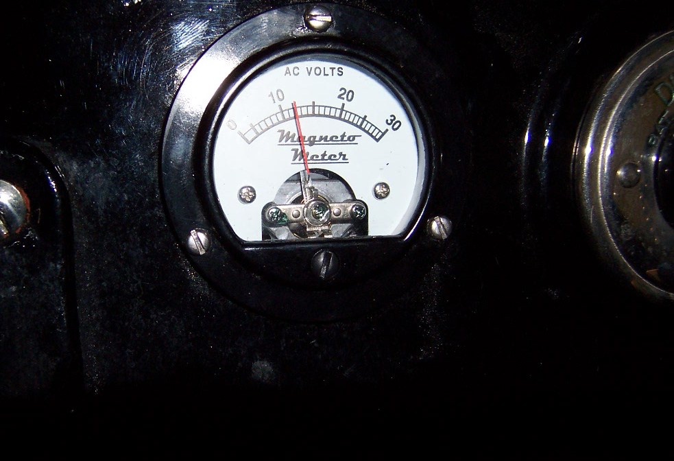

My new to me T has been modified I am told such that the mag is set up to charge the battery. It also has been modified with the later hogshead/starter. To my knowledge it is not supposed to run on mag directly. It has the later T voltmeter. Currently the voltmeter is not indicating that the mag is producing voltage. Can someone school me on how this setup is at least supposed to work? For example I thought that if a normal T mag is functioning properly the voltage would be higher than wanted to charge the battery. Note that the battery is 12 v and per records the starter has been rebuilt for 12 V. The previous owner is deceased but did leave notes on a number of items. He had the starter done but I believe purchased the car with the "conversion" done on how the mag was to function. Help anyone?

For one thing voltmeters show DC and your mag puts out AC so it won't show. The meter would only indicate if the generator is worming which sounds like your car does not have one.

"For one thing voltmeters show DC and your mag puts out AC so it won't show."
That depends on the type of voltmeter you have. If it's the 'Magneto Meter' by Funprojects that was sold by Lang's and other vendors, it will indeed measure and display the AC voltage output from the Ford Magneto. Lang's still lists it but it's unavailable, https://www.modeltford.com/item/A-MAGM.aspx
( Funprojects also offered a DC voltmeter that fit in the Ammeter panel on the dash, that meter was often installed by those whose cars were equipped with alternators to monitor battery voltage. Those were sold by Lang's with part numbers 5016-6v or 5016-12v for 6v and 12v, respectively. The meter scales were 5.5-7.5 Vdc and 11-15 Vdc for the respective meters)
From the descriptions of the meters you should be able to determine what is being measured on your model T. Best, jb

It is equipped with the Magneto Meter and says that it is to measure AC volts. As indicated it shows 0 volts at all rpm.jab35 wrote: ↑Fri Apr 26, 2024 8:33 am"For one thing voltmeters show DC and your mag puts out AC so it won't show."
That would be either the wire from the Magneto Meter to the mag output on the hogshead isn't connected, or the other lead from the meter isn't on a ground. Or, perhaps the magneto contact is caked with oil/lining/metallic debris and is grounding out the magneto output. Cleaning the contact by removing the magneto post would check that. Finally, the magneto could be dead.
With 12v starter added, your T should have a 12v DC storage battery, perhaps the owner used the AC magneto with an adaptor device, to put 12v DC back to the storage battery, but that juice would be very light amps anyway, about like a trickle charger.

More information to add. I cleaned up the magneto contact and now I have a reading on the magneto meter. That is the good news. However I read about 6 1/2 volts at idle but just 10 volts at RPM verified with my fluke meter. What should I see on the mag at RPM? Needless to say that will not charge the 12v battery! Still do not understand how the wiring is set up such that It will not run on mag. Is it likely that a change was made internally in the coilbox/switch?

I have a magneto meter the same as Dan above posted with a picture. The Magneto Meter and my Fluke agree on the voltages at both idle , 6 1/2v and at higher RPM, 10 v. The voltage does not exceed 10v.
- Posts: 7411
Re: 1912 modified for mag to charge a battery
...the voltages at both idle , 6 1/2v and at higher RPM, 10 v. The voltage does not exceed 10v.
Your magneto is weak. At road speeds (20 to 30 MPH) it should put out plenty of voltage to keep your battery charged. See the chart here: https://www.mtfca.com/phpBB3/viewtopic.php?t=11870

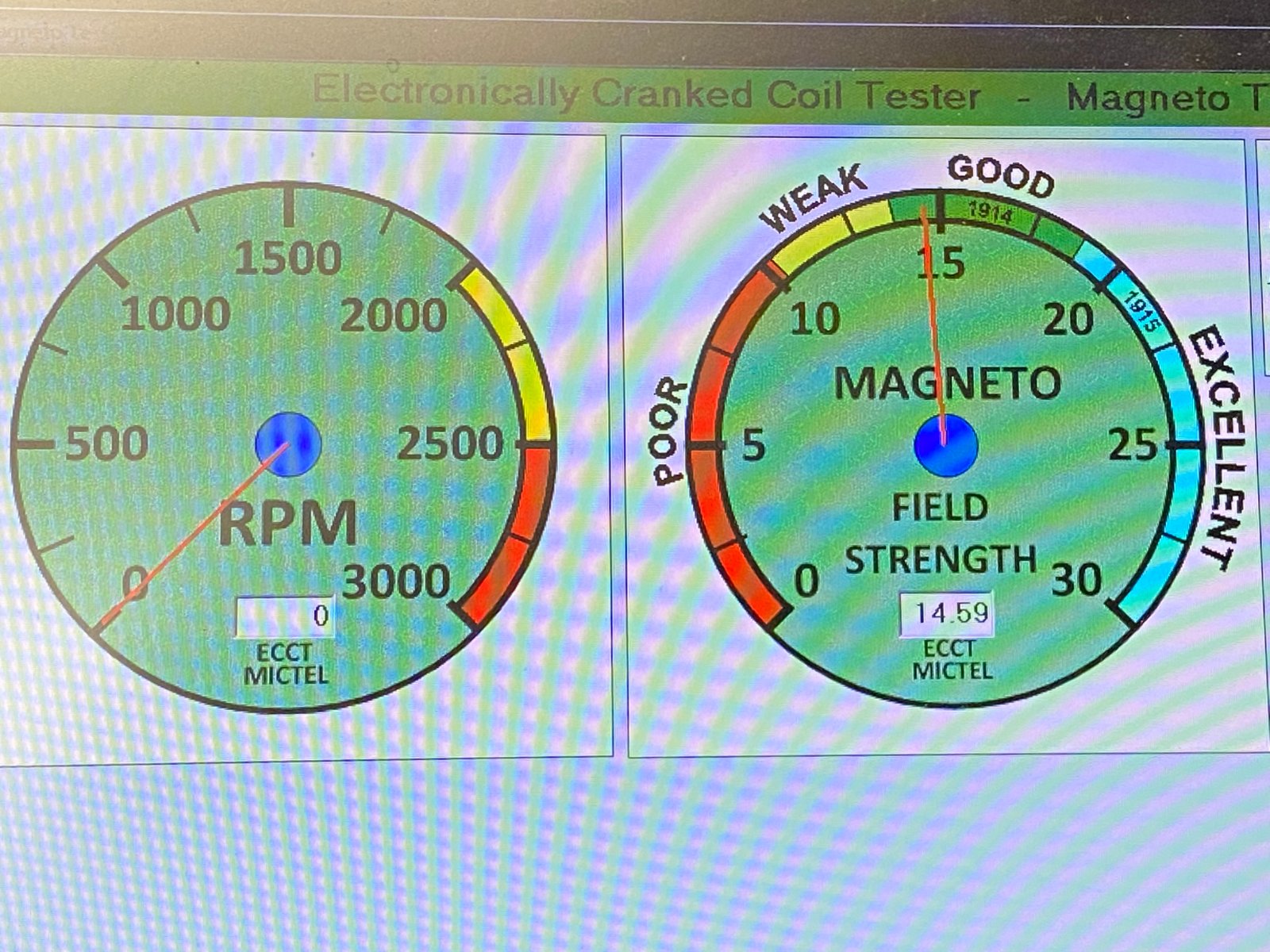

William,
Before you get too carried away with removing the motor or re-magnetising could I suggest you first measure if there is any DC charge current (NOT voltage)? Now that you've cleaned up the mag connection you may find in fact that the battery is being charged in use, although be aware that with a magneto system it won't be at a high rate.
FWIW the reason I suggest checking is that traditional AC meters will measure average (.636), but be calibrated in RMS (.707), whereas what matters to you is DC volts, which should be very roughly 1.4x the RMS. Thus if you have an AC meter reading 10V then the DC voltage (after a rectifier) will be about right for charging your battery (albeit crudely). There are other factors in play here too, including the electrical noise that a T will generate, and the magneto waveform and how meters will react to that, but for the present these are probably safe to ignore.
Note I make these comments without being specifically aware of how your machine is wired, so it may be that you get no result, however it's a simple thing to check before delving deeper.
Luke.

Well, in accordance with the recommended directions provided in the referenced post I attempted an in car magneto refresh with unsuccessful results. I am confident that I did it in accordance with the referenced procedure using 3 12v batteries connected in series. I used stout battery cables and the no load voltage was 38 volts. I very briefly zapped it 8 times and now I have no output on the magneto meter. I did repeat my thrust measurement at .005 inches with a 1' dial mike before and after the procedure with initially the crankshaft pushed back, the wheels chocked and in high gear. Unless someone has another thought, I will run on the 12v battery for this tour season with plans to pull the engine next winter and go after the mag.
