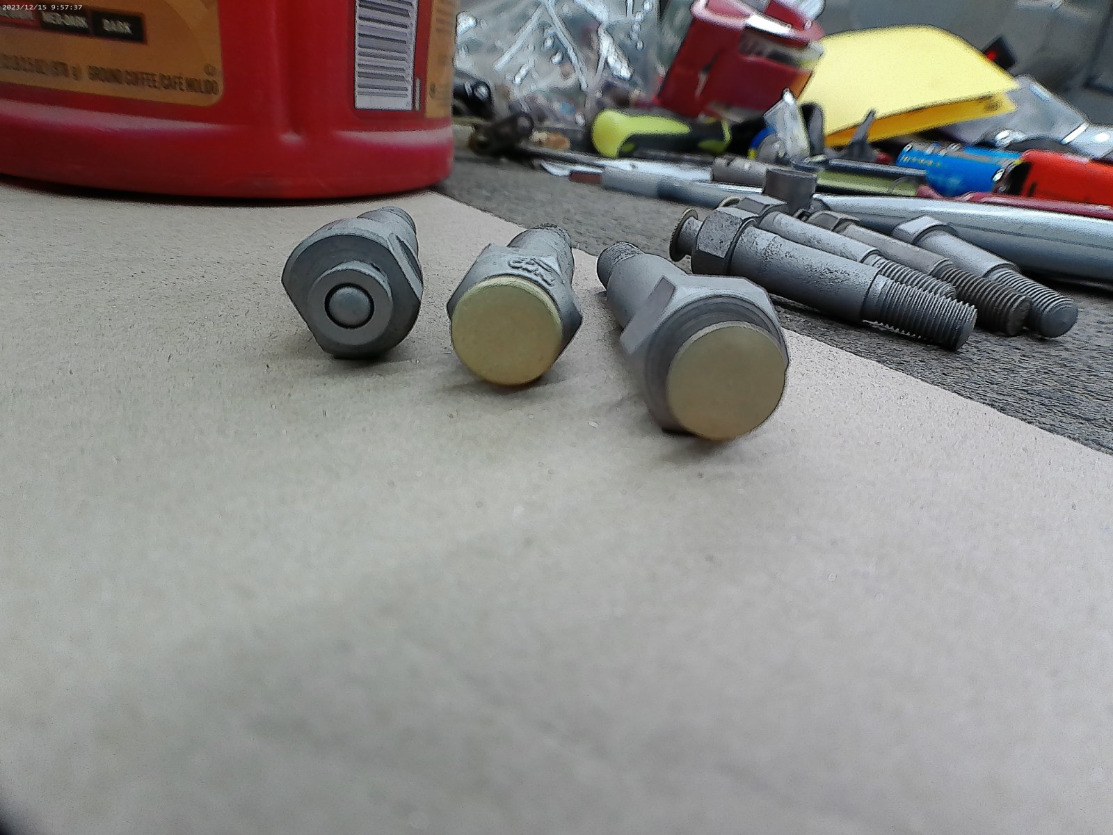

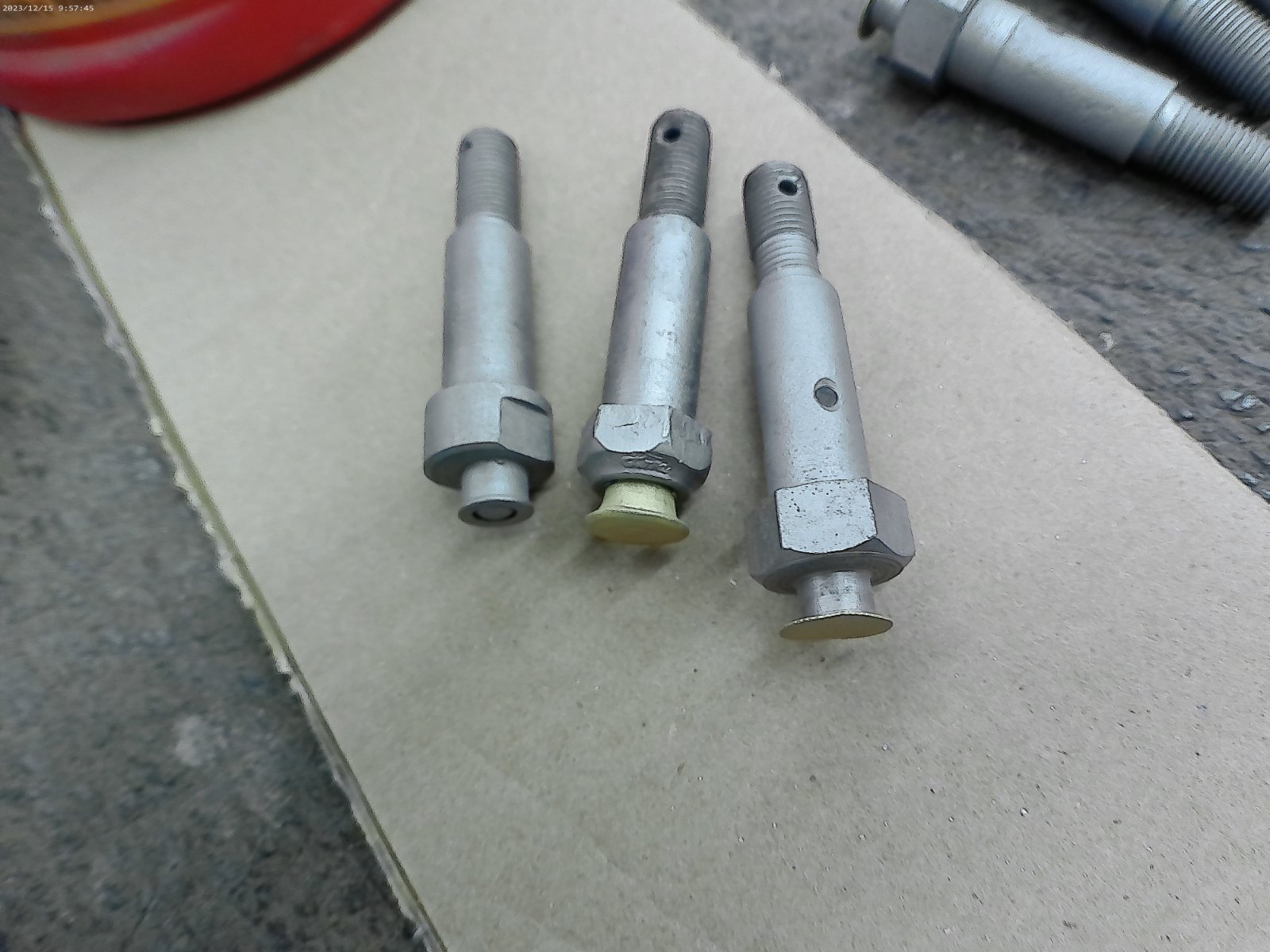

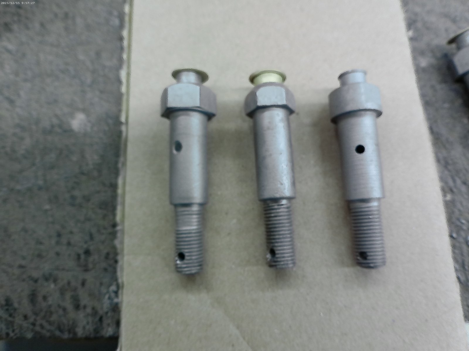

Going though a box and found these some oilers are man hole some have a ball the heads are not the same, any ideas how many types were made all the correct size,Bob

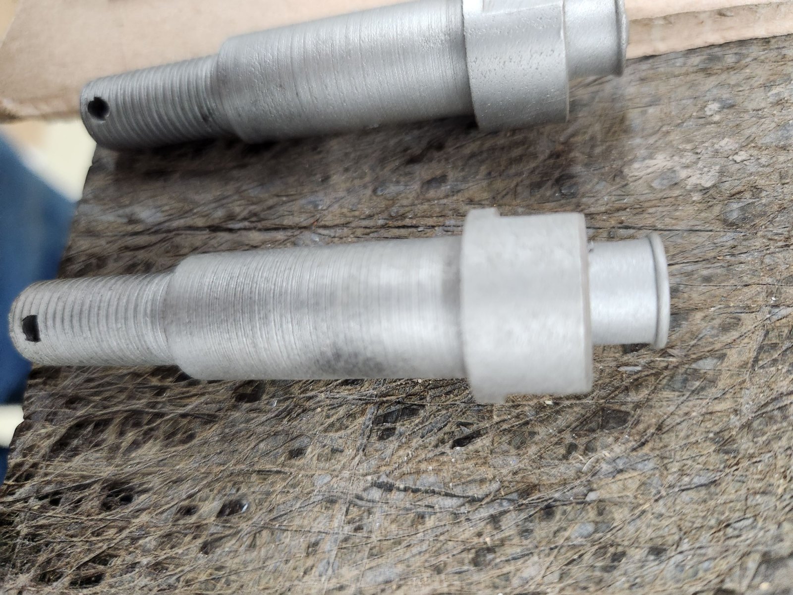

more photos
some reason re sizing does not let me add to this site

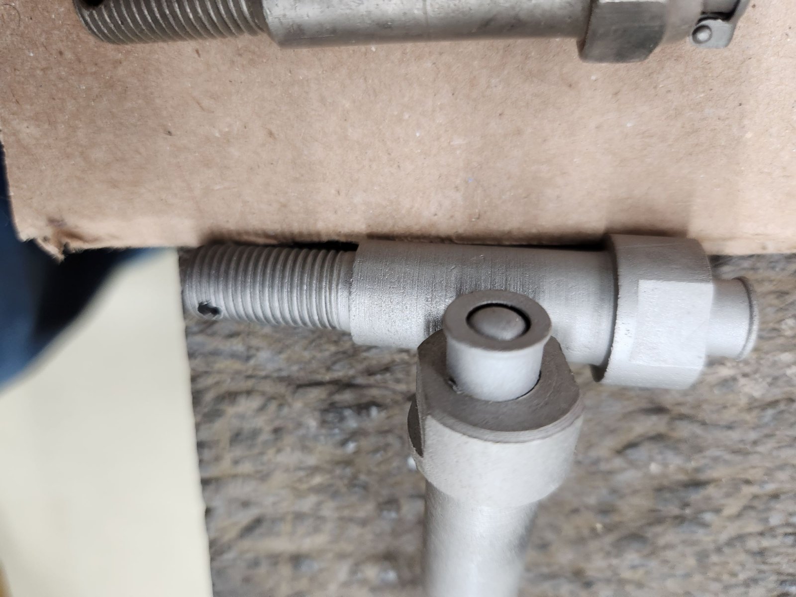

try another camera

From the MTFCA Encyclopedia
09-06-16 “Brought drawing up to date with oilers as they are being made by changing the design from 4N Bowen. The new type was the Winkley.
09-30-16 T2944 spring oilers. These were used on the springs, replacing the hanger oilers. They were Winkley 1-G “Special Winkley Oiler.” They appear to have a spring-loaded ball as a “door.” Push the ball down to add the oil and then the ball seals the hole. They were zinc plated.
11-29-16 Changed from the above Winkley to the man-hole style, also made by Winkley, and were initially raven finished but later Zinc coated. This oiler was also used on the commutator.
12-13-16 Changed to Winkley oiler #3, Style R.
02-08-17 This same oiler now used on the spindle bolts.
No idea on the bolt head difference
