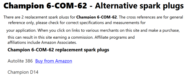

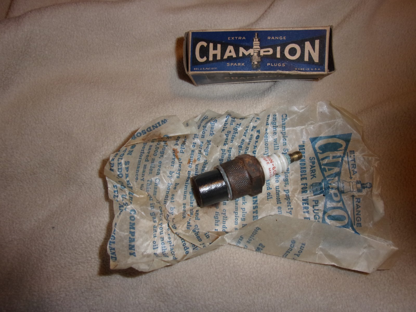

I know nothing about these air gap plugs other than a stash of them came in a Model T parts lot, so I presume the PO was running them. I have not installed them in my T but may do so to test them. NOS Champion 6 com 62. What little verbage I can find them is they are commercial plugs designed for engines that run hot, a cooler running plug.
I've got a little roughness in my T engine right now and connecting everything up after gas tank cleaning and lining. If it still runs a little rough, I'll replace the plugs with something and see if that helps. Then I'll move to the coils.
Anyone heard of these AC plugs?

From the internet for AC 6-COM-62 plugs
6COM-62, 18mm plugs were listed as for "Ford and pre 1926 Harley." by spark plug dealer Donald McKinsey in 1994
from a discussion on aaca.org
My pre-war Champion catalog shows this 18mm plug as mainly intended for commercial vehicles and motorcycles. It's a "severe service" plug and is recommended for engines that run hot. (It's a colder type plug.) There were no specific vehicle recommendations in the catalog but there is a note that it can be used in some Studebakers, but it is indicated as a plug that can be used to help correct rapid gap growth, pre-ignition, ping, overheating and core fracture caused by hot running motors, high speed usage, heavy loads and long highway upgrades in hot climates.

If that's a gasket on there - it won't fit a T - they're 1/2 pipe !

Would a early Ford and Harley plug really be 18mm? I haven't tried to thread one in yet, but certainly don't want to mess up a head.

Re: Spark Plugs for the Driver T
Good question. All depends on what one means by "Early"
Spark Plug (18mm Champion);
1933-37 Ford V8
1929-1952 Harley-Davidson WL
1936-1940 Harley-Davidson EL
1937-1947 Harley-Davidson UL
1941-1947 Harley-Davidson FL

I believe Model T spark plugs were always half inch pipe thread, from the beginning. I don't know about all the pre-T models. The Model T parts dealers have adapters that let you use other sizes.
