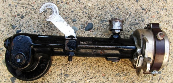

Because every T I have acquired has had a bad mag I have come to appreciate distributors. The other day I picked up a distributor that I have
never seen before. It uses Jeep cap, rotor, points & condenser. It was removed because it does not fit well. It appears to be for only 26-27
timing covers because it collides with the fan adjusting boss & bolt. It has two bulges that may have been intended to anchor it to the cover.
Anyone know anything about this distributor??? Thanks Guys.
Craig.
Craig.

I have been running one of these for many years trouble free. They were made in Argentina back in the '60s. I drilled 1/4" holes in the two tabs and mating holes in the timing cover and tapped for 1/4" bolts. The head on mine is a match to an Autolite IAD 400, commonly used on mid 50s Jeep. And yes, must use the 26-7 front cover and fan set up. Also mine came with auto advance springs and weights. I removed them and riveted the two plates together and added a lever the the case for the advance rod. You will need to fashion bell crank lever for reversing the timing rod, similar to the early 009 distributors.

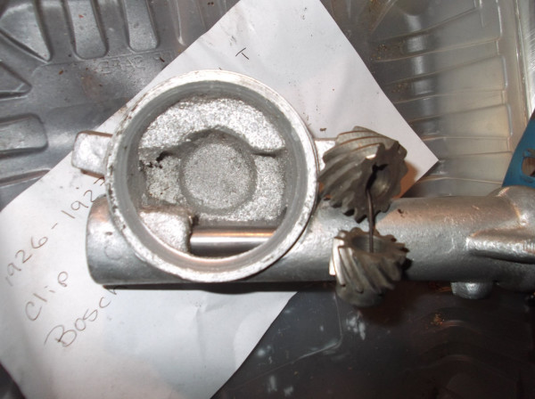

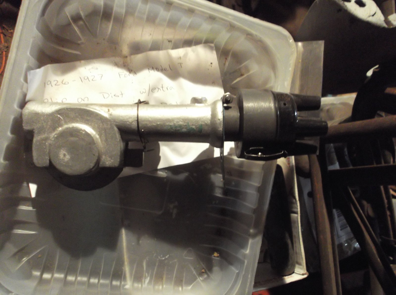

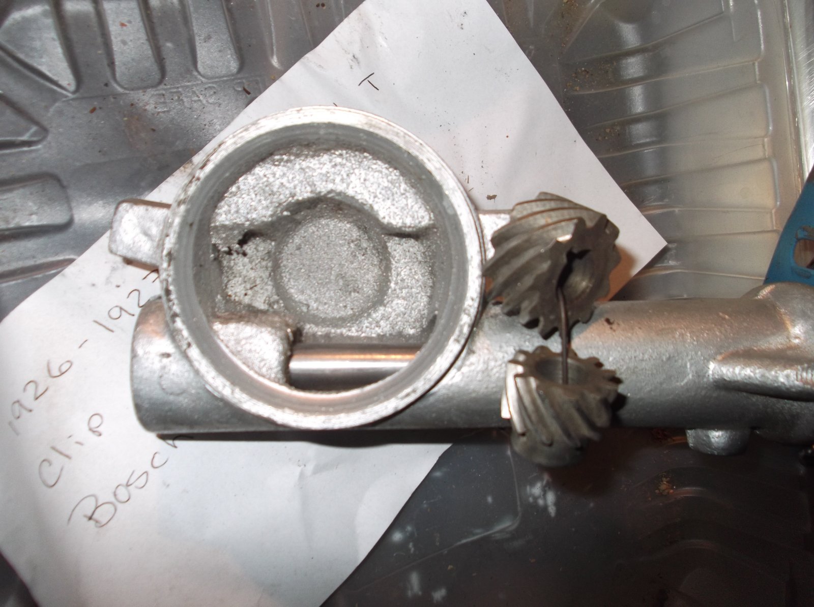

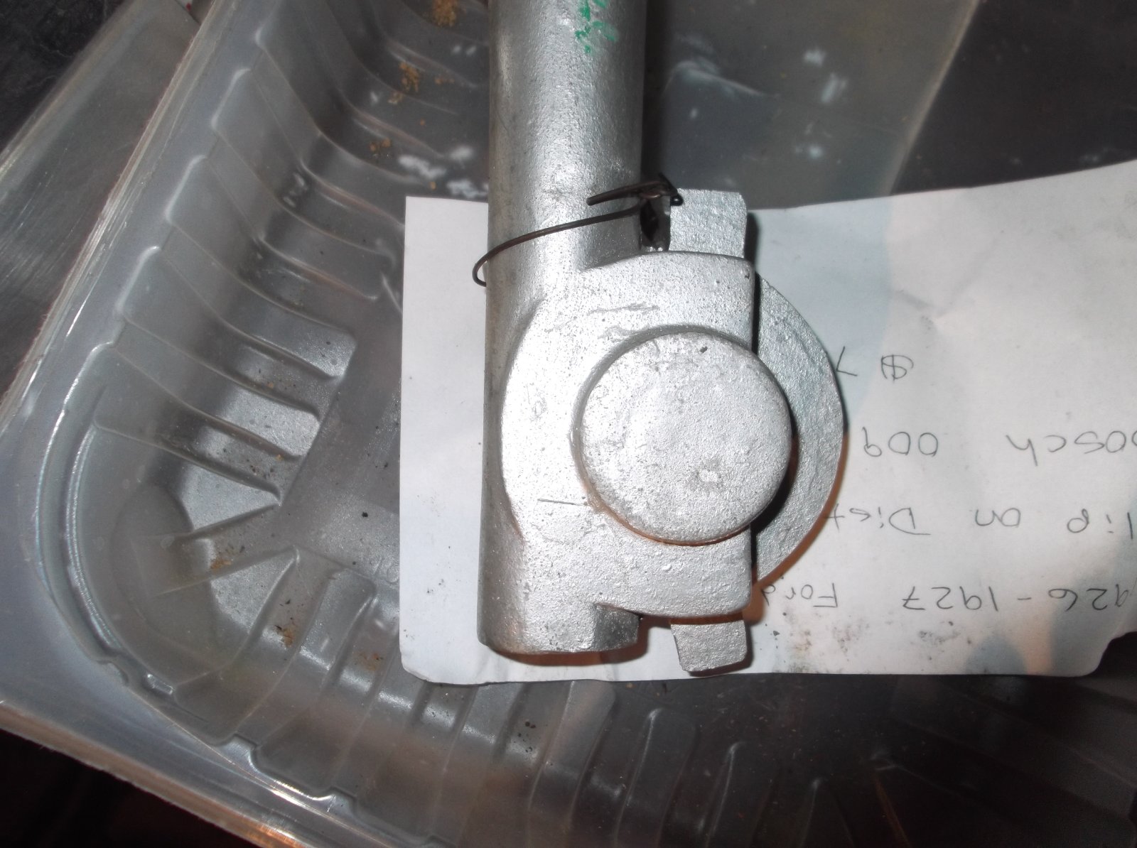

The base does remind me of the Argentina unit that came on my first T. Yours was polished
I remember the cap clips were thin sheet metal, not typical of normal dizzy cap clips.
The head was cast iron. Pinto points fit.
It Did fit on my pre 26 cam cover plate.

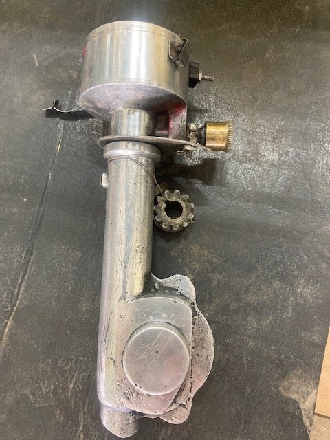

I have one similar to the one shown. Mine too will only work with the 1926/27 timing gear cover. I think the distributor body is Industrial Argentina origin but was going to use the 009 VW distributor in its place.
