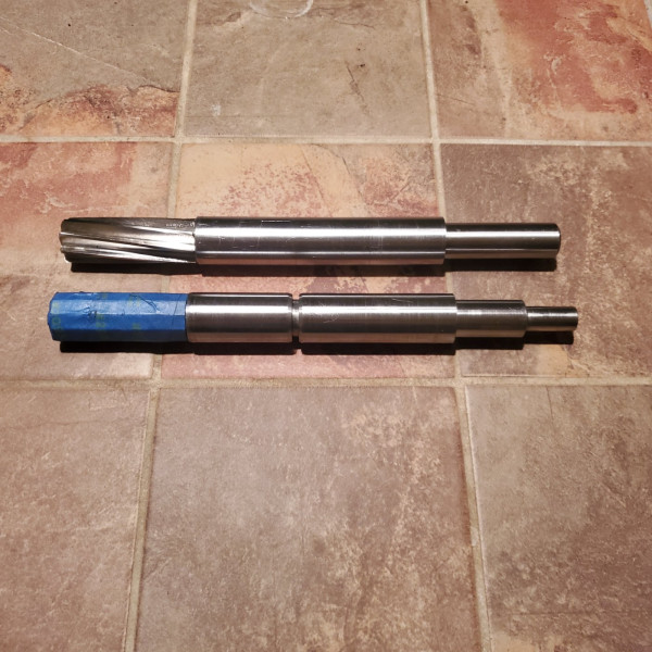

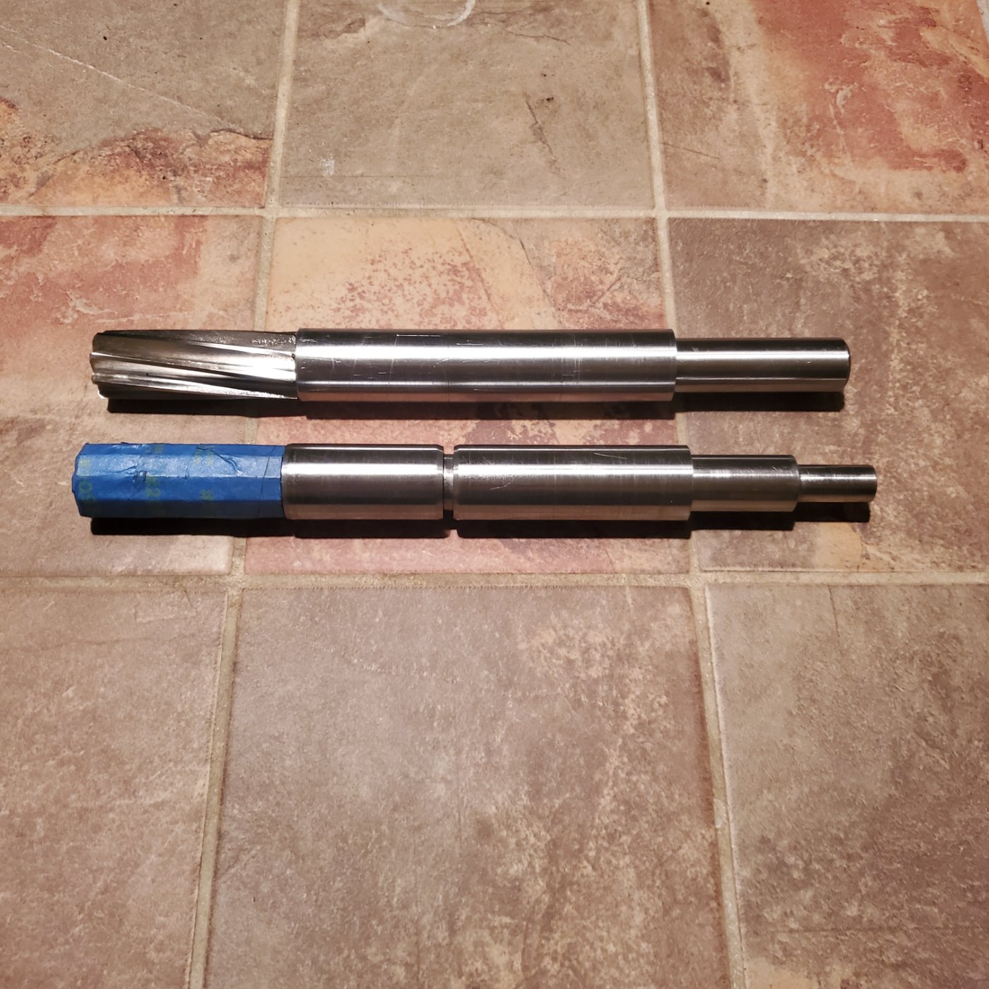

BTW its pretty easy and inexpensive to make a driving plate alighment reamer pattered after the KRWilson reamer that indexes off the two brake drum bushings. Ive made a couple.
