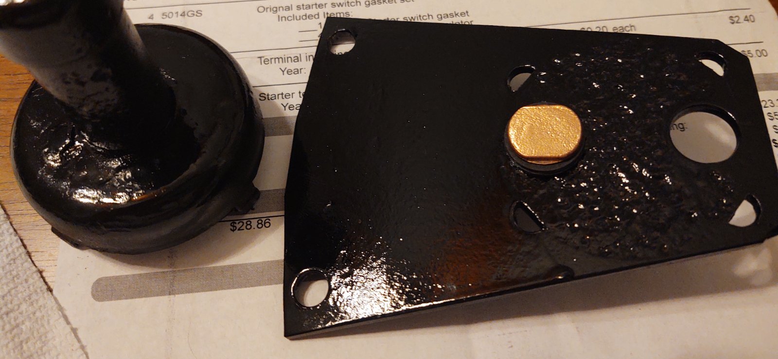

Re: Starter switch repair
Starter foot switch can be rebuilt

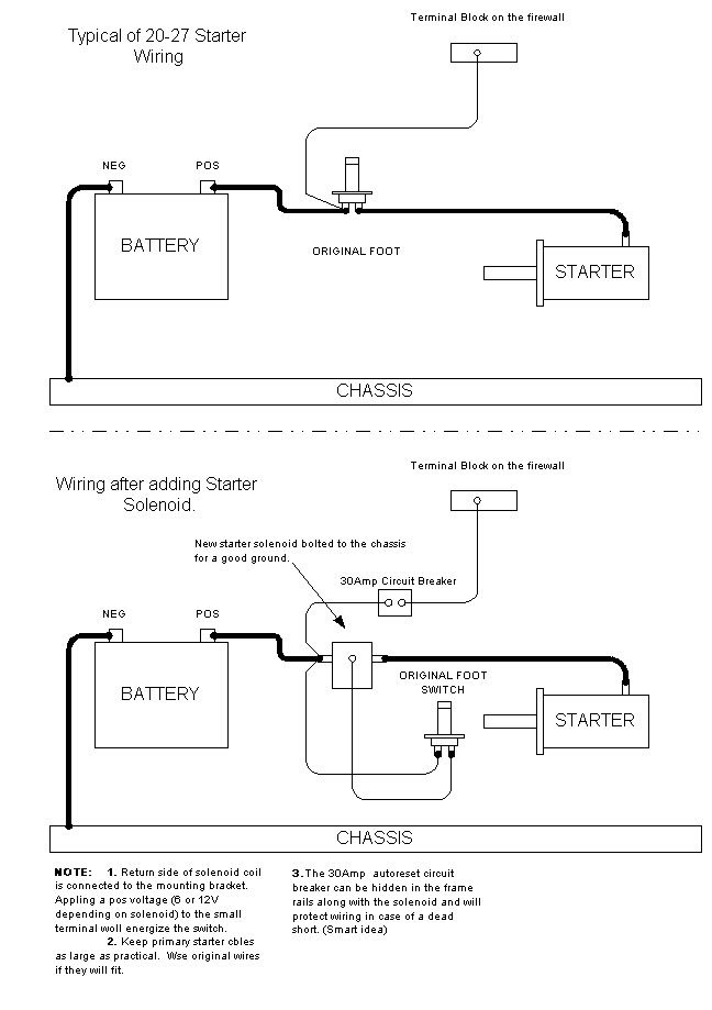

Change to a solenoid. Let the foot switch control the solenoid. That way your foot switches will last forever.

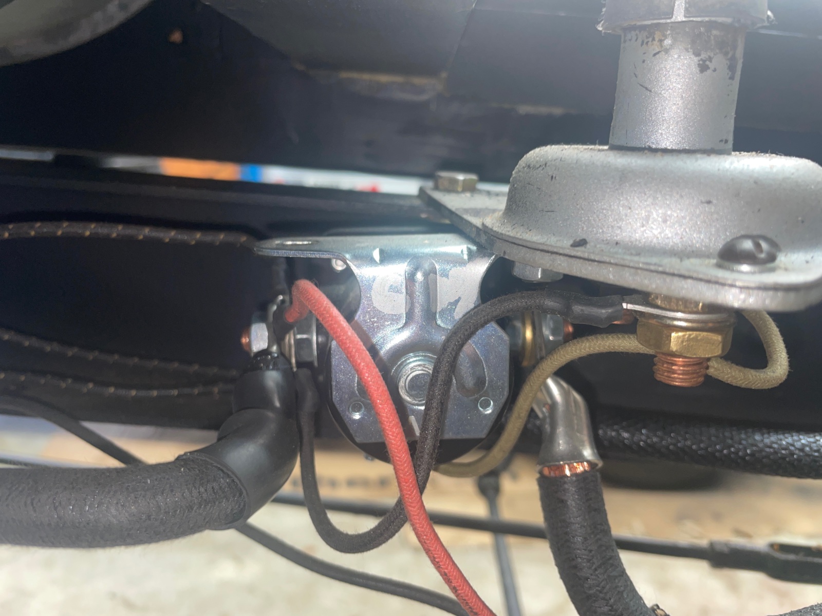

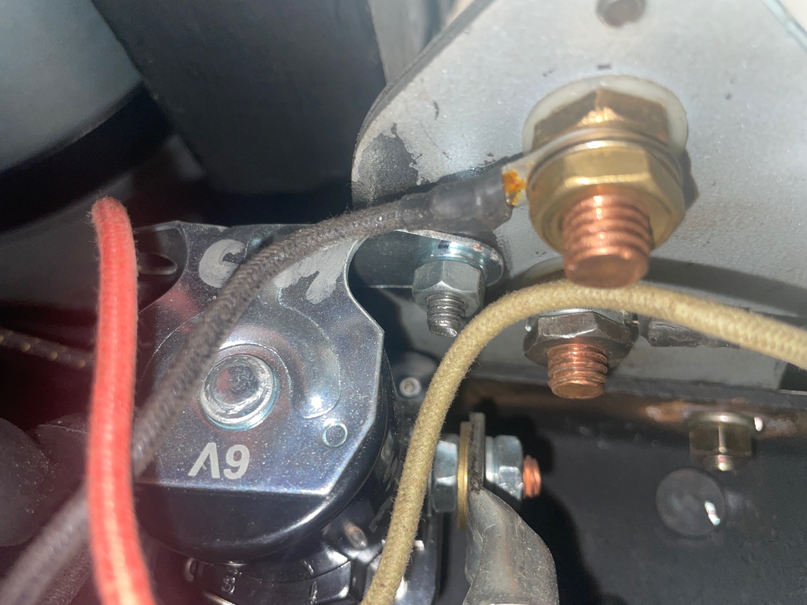

Yep. That's the better way. Rebuilt the Ford foot switch to clean the contacts and used new insulators, then fitted the solenoid to a bolt placed inside the foot switch cover, drilled hole in foot switch plate while rebuilding. The solenoid unit has to be grounded to operate. Remove paint from any of the ground contacts to the foot switch and the frame, to be sure of best ground return path.
Connect one side of foot switch to the solenoid 'S' terminal, the other side to the solenoid battery + cable then add starter + cable to the solenoid.
Works flawlessly, simple light foot press on the original Ford switch, fires the starter motor swiftly.
