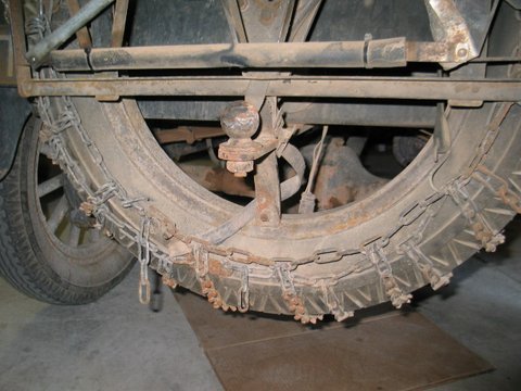

Triggered by the post about a lightweight trailer, I would like to ask for inspiration of how to make a hitch for Model T.
The above thread have a reference to a post in the old forum, where we see this picture:
Now - the regulations over here in Europe are a litle more restrictive than in USA, but to a large extent, when dealing with cars as old as Ford Model T you have some possibilities without having to come up with 100 pages of documentation :-).

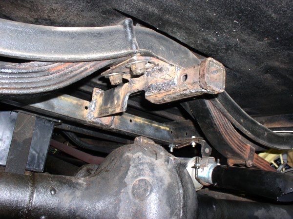

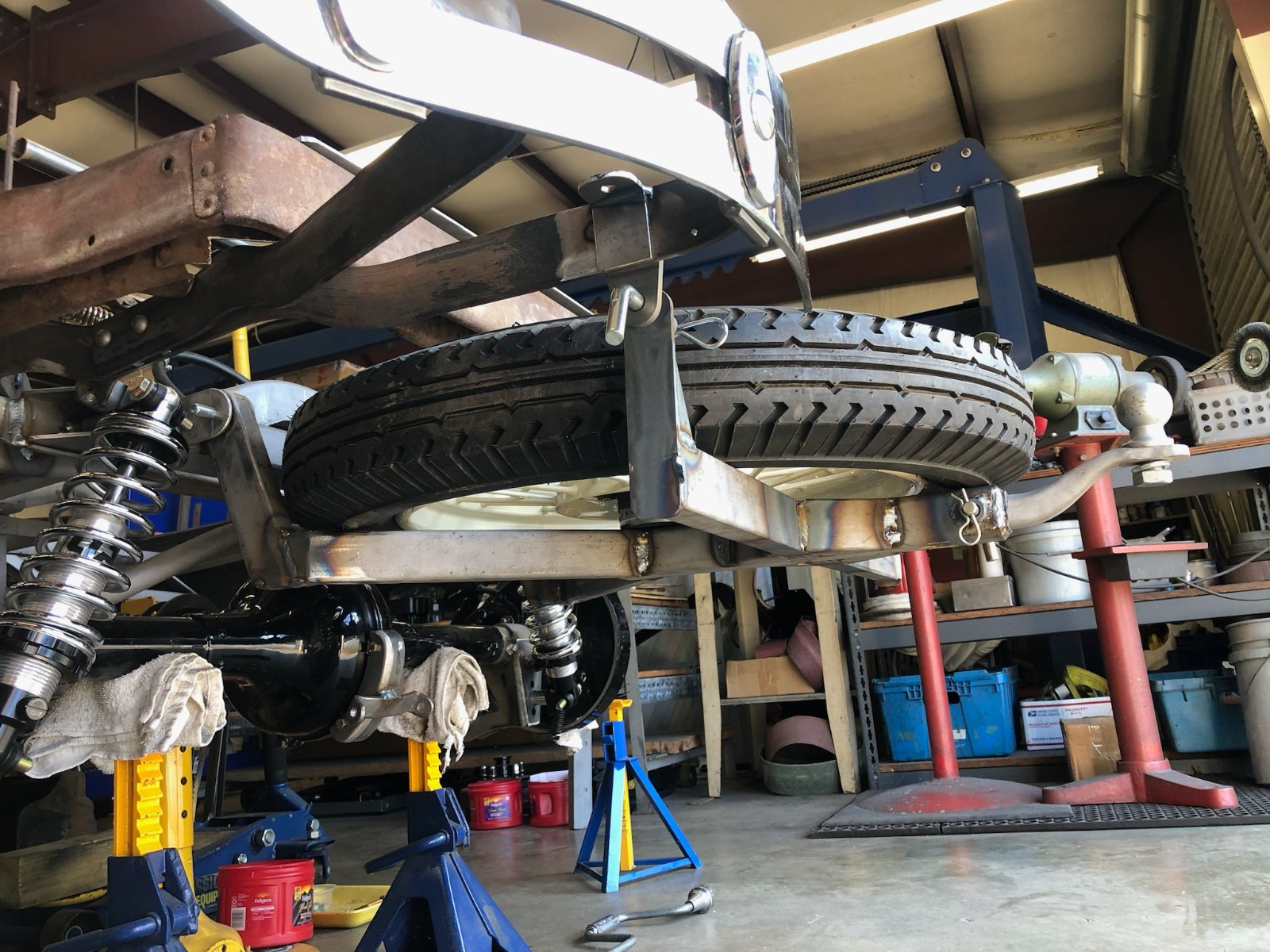

Many ways of doing a hitch, and most use the rear crossmember/spring hanger u-bolts for attachment, being part of the frame.
Got this one already made by welding to a 26-27 rear tire carrier, and with enough length and shape to reach thru the spare tire, if equipped.

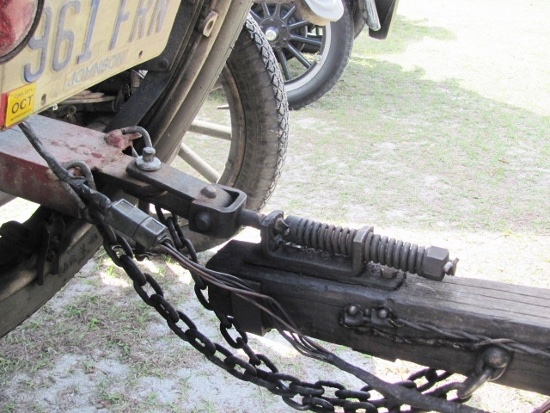

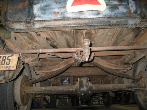

Other's from photo saved to files:
And the famous T trailer tourer, Mr.Dean Yoder, uses this set up for trailer pulling.

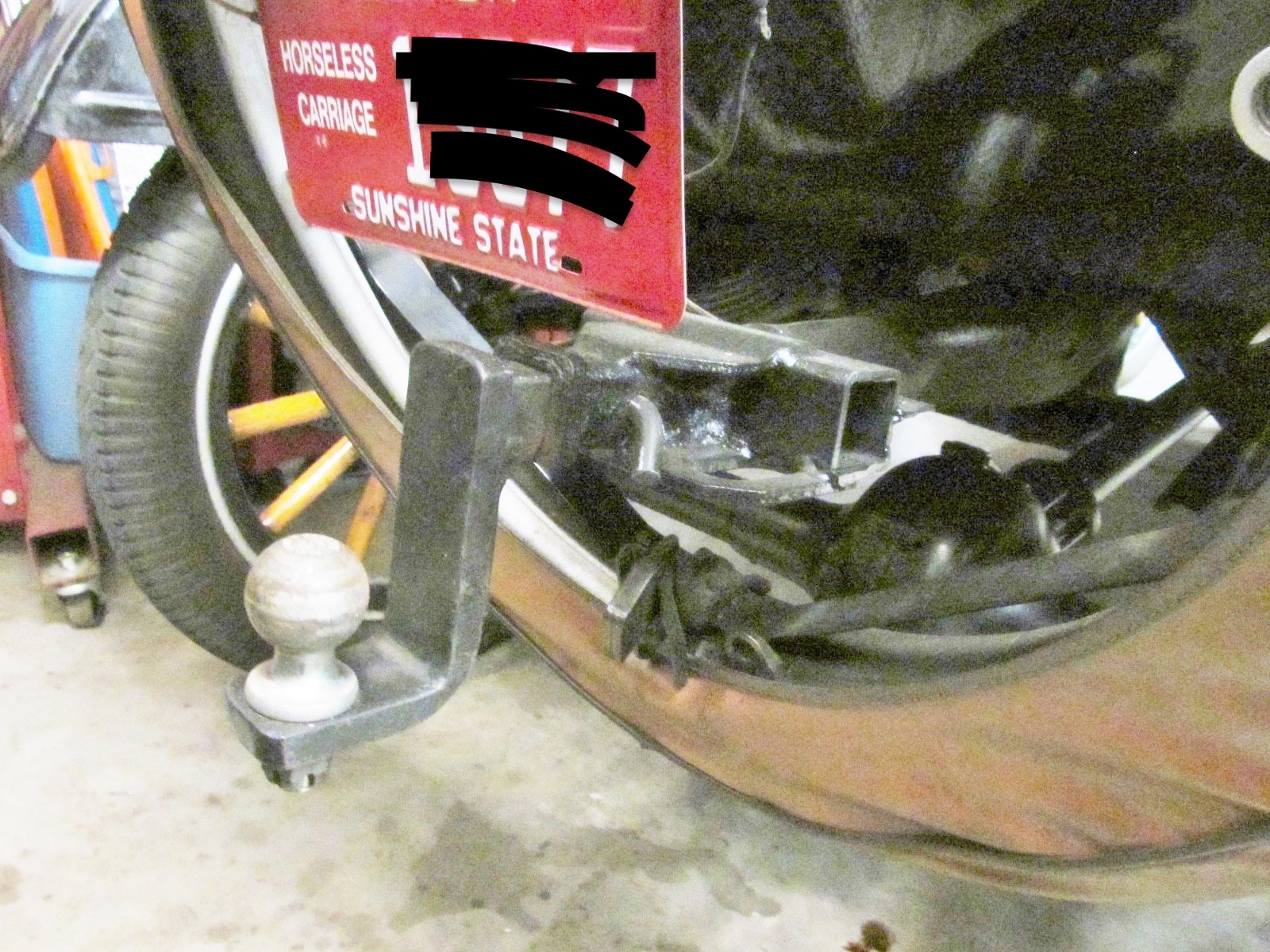

I have hitches on 2 T's and a Model A pick up, I have used them all and the work well I will include pictures. Please remember it isn't how or what you pull but how you stop it.

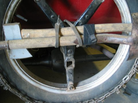

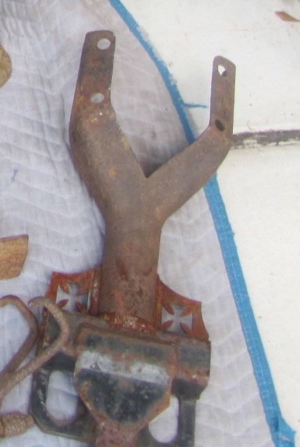

How about a multipurpose hitch?
Spare carrier and hitch.

Would you use a Fulton coupler on your trailer and, then, would require a ball hitch? Or would you use something like a farm type hitch with a flat plate and a hole to drop a pin in?
I was visualizing a wooden trailer to be made from the same wood as my depot hack and would use a farm type set up. I pulled a Model A wishbone from the family bone yard and it already had the flat plate and hole welded onto the wishbone and the axle. I would need to create a wooden frame, bed and find a way to connect it to the axle with or without a leaf spring . But the type of coupler and hitch might need to be made first.
