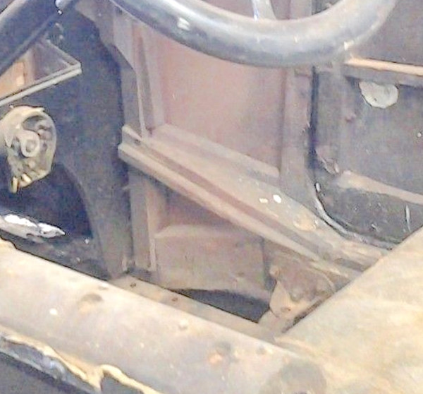

Just wondering when this style of floorboard support was used on the open cars?

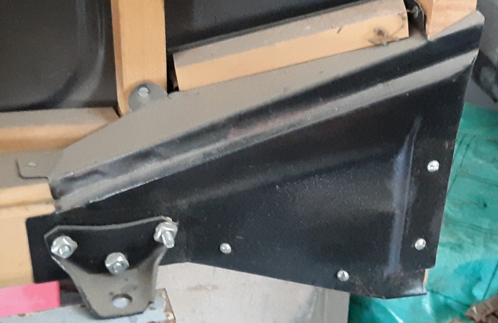

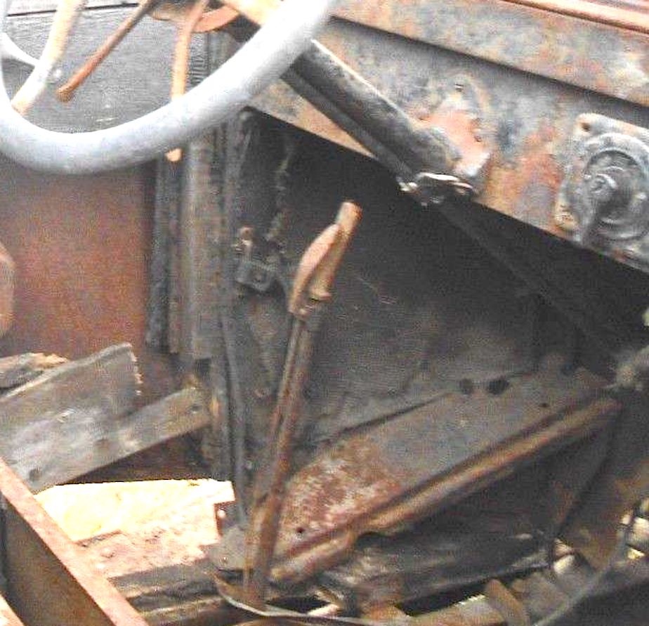

That part shouldn't be for open cars. Believe a sedan or coupe metal riser is what you have.
Photo of a '24 coupe riser

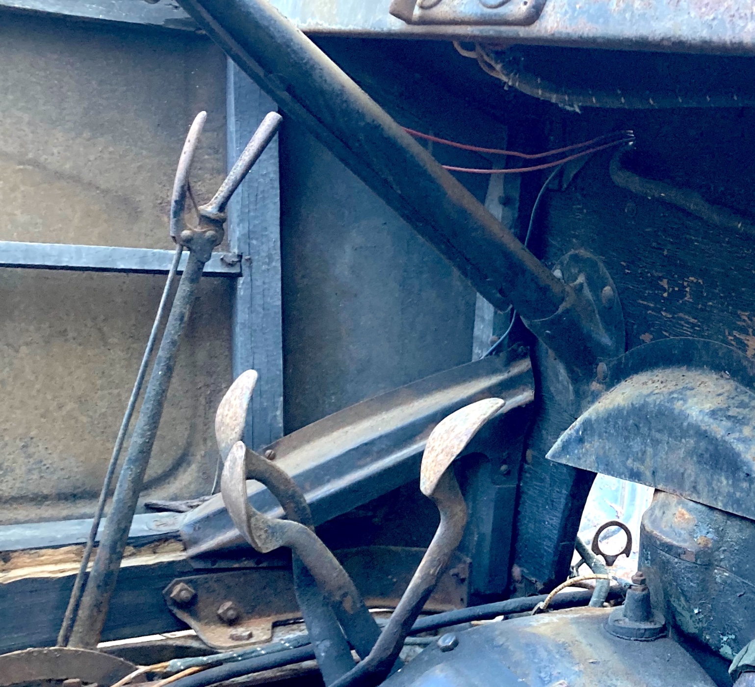

Here is a '23 open car metal riser:
Before that metal riser, wood riser was used, '17 touring pictured.

Philip Lawrence
Topic author - Posts: 501
- Joined: Thu Jan 10, 2019 11:42 am
- First Name: Philip
- Last Name: Lawrence
- * REQUIRED* Type and Year of Model Ts owned: 1914 Touring, 1917 Runabout, 1919 Touring
- Location: Auburn, CA
- Board Member Since: 2014
Re: Open car floorboard supports
Dan, Thanks for the information. I didn't think that it was right, so wanted to make sure. Those floorboard supports were on the rebuilt body when I bought it.
