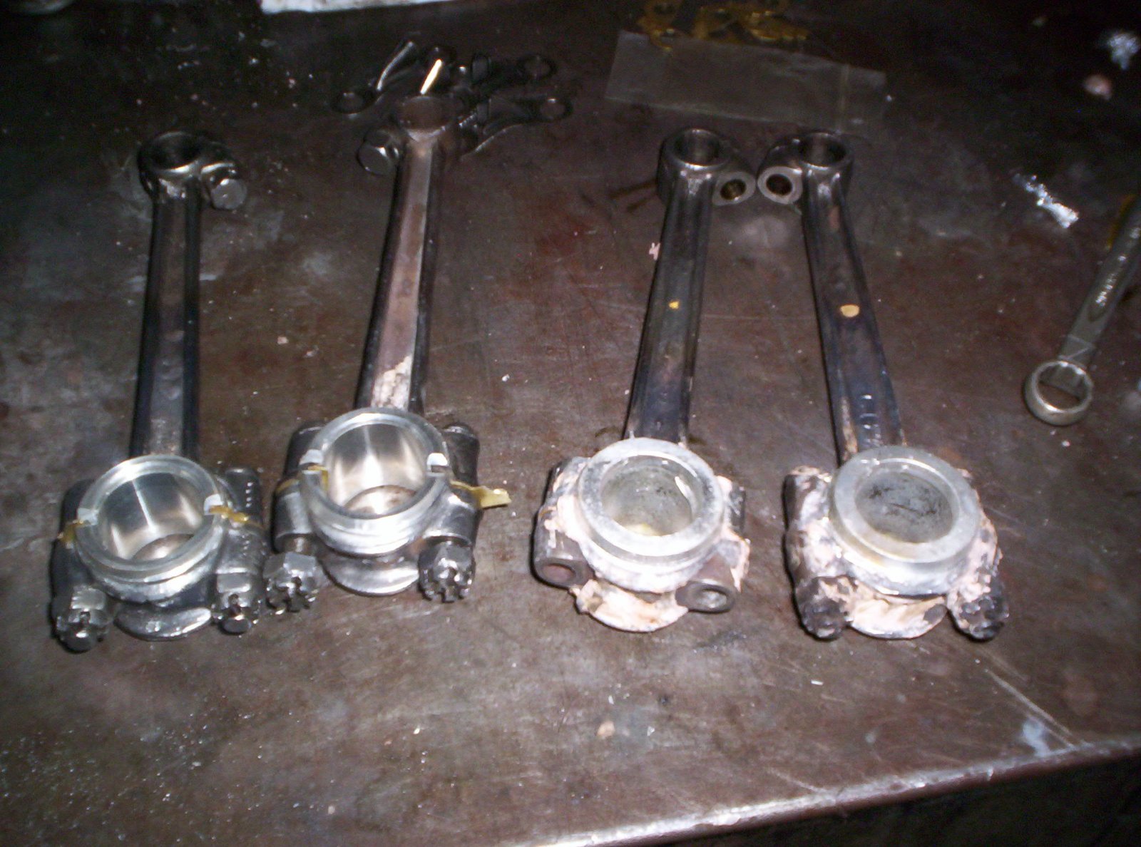

NoN Xed.... I measured a total of 1 square inch of Babbitt that was removed from those new Xed rods from the vendors. I paid to send them back... The X and holes make a nice path for the oil to escape and put more force on the surface that is left. The dipper does not see a puddle of oil with the windage around the crank only some mist, I believe.
Yup Dean and others have drove many many miles at pretty darn fast speeds and don't use dippers or X rods.

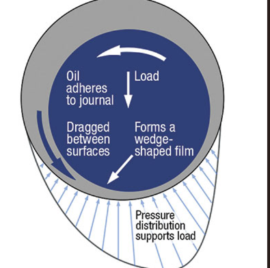

I am willing to comprise on Xing the connecting rod babbitt and to follow the theory of hydrodynamic lubrication (HDL).
The compromise is:
X on the rod cap
No X on the rod
As I recall from 60 years ago, the theory of HDL involves a 7th order differential equation.
