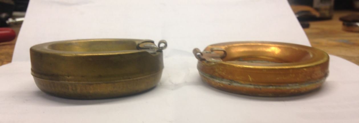

To the question you did NOT ask: your carb would most likely come with the float on the left, due to increased head pressure of the gasoline in the cowl tank. Having the correct float will help with drippy carb issues (when everything is clean). 30 year old goop is another story altogether.
Photo courtesy of: Tom Miller 11/3/17

Now the next big question is where can someone find the bigger float ?? I'd like to try it on my 26/27 NH.
