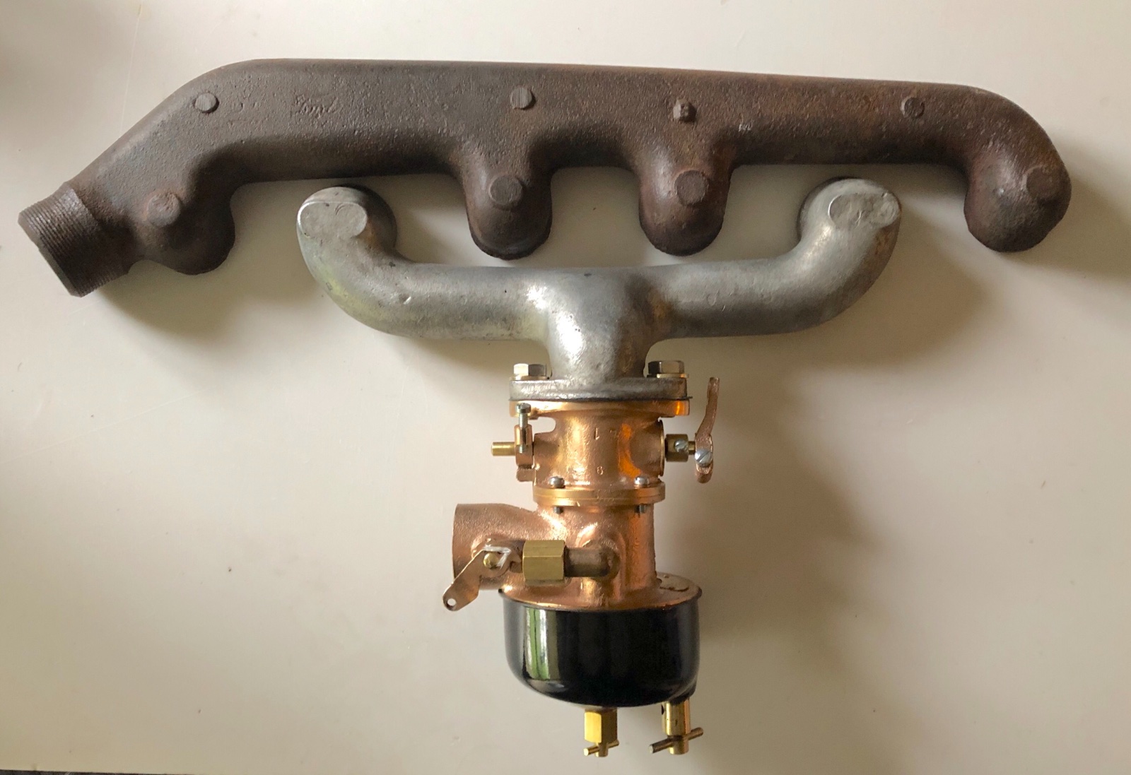

Got back from a work trip in Sicily on Tuesday. While I was gone a forum member sent me the correct manifold for the U & J carburetor that was recently rebuilt by Stan Howe. Now I’m ready for installation. I know that there is essentially one adjustment, the needle valve on the bottom but I also see an interesting disc on the throttle shaft with a slot that moves past a hole on the casting in throttle area. (See Picture) Is this an idle air passage?
The slot in the disc seems to be adjustable with how it interfaces with the hole by a collar that can be adjusted and locked with a set screw. Does anyone have an original set of instructions or chapter in an old text that refers to this adjustment?

While you are waiting for instructions; I think you are right about the idle, it leans the mixture at idle. My suggestion would be to install and see how it does. It may not need any attention after the idle speed is set. My micro torch has a similar valve, open all the way to start but adjusted to get a good flame.

The only adjustment other than the main jet is the position of the air bleed on the throttle shaft. It should be positioned so that the bleed is open when the throttle plate is about 1/8 - 3/16ths open, or at about 1/6th of the arc of the throttle arm. That is the U & J economizer, it leans the mixture at low throttle settings. Be sure it has a spring holding the plate tight against the body or it won't idle well. It needs to close that air bleeder hole at idle and when the throttle is open.
