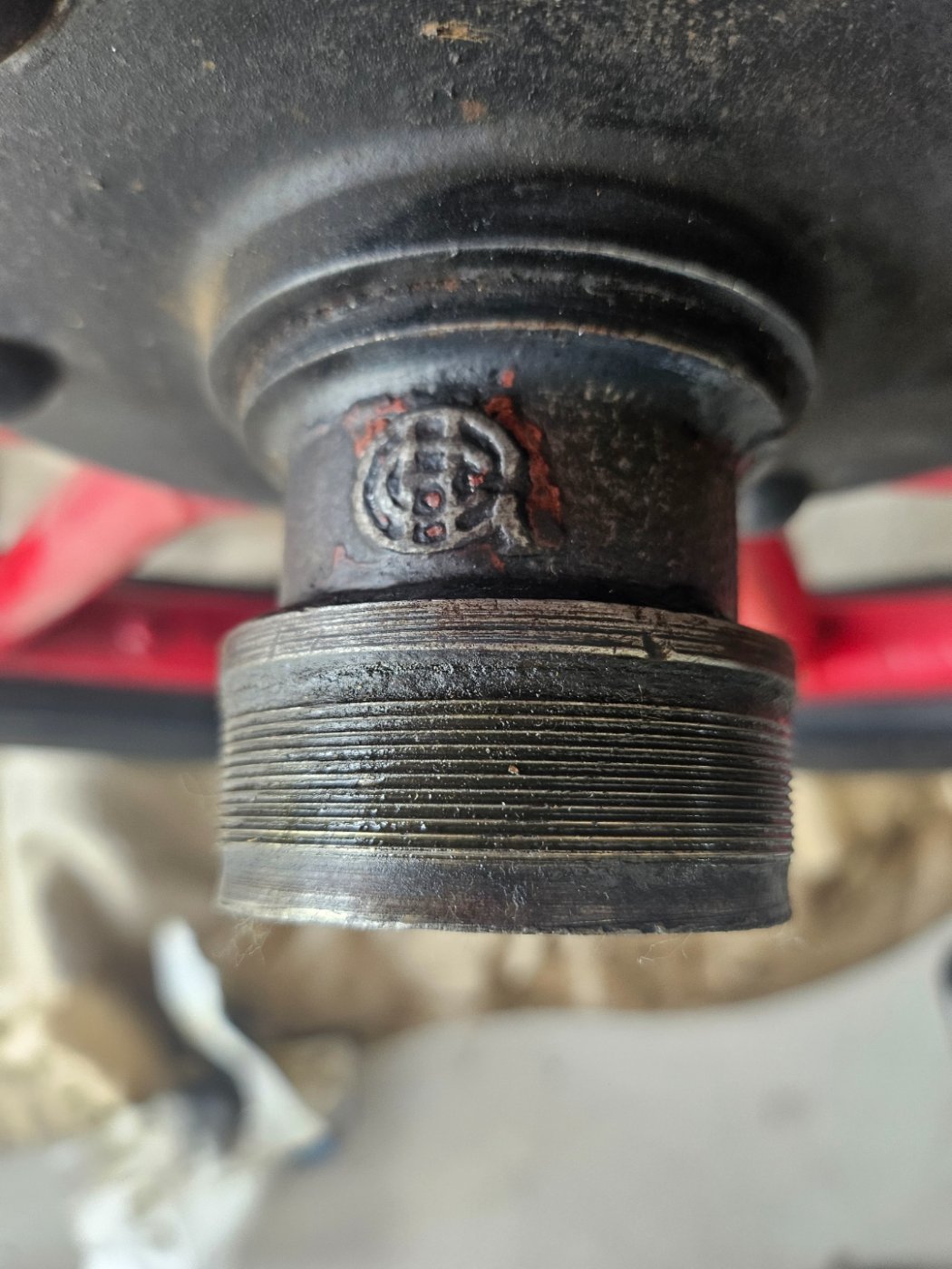

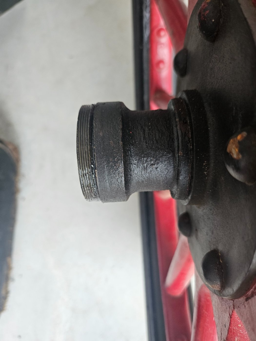

While Daisy is a March1914 build, the left hub is a 1910-13 variant. Also, cast with a "GHC" Logo... CH? I tried doing a search but came up empty....anyone confirm? Possibly a Cleveland Hardware??

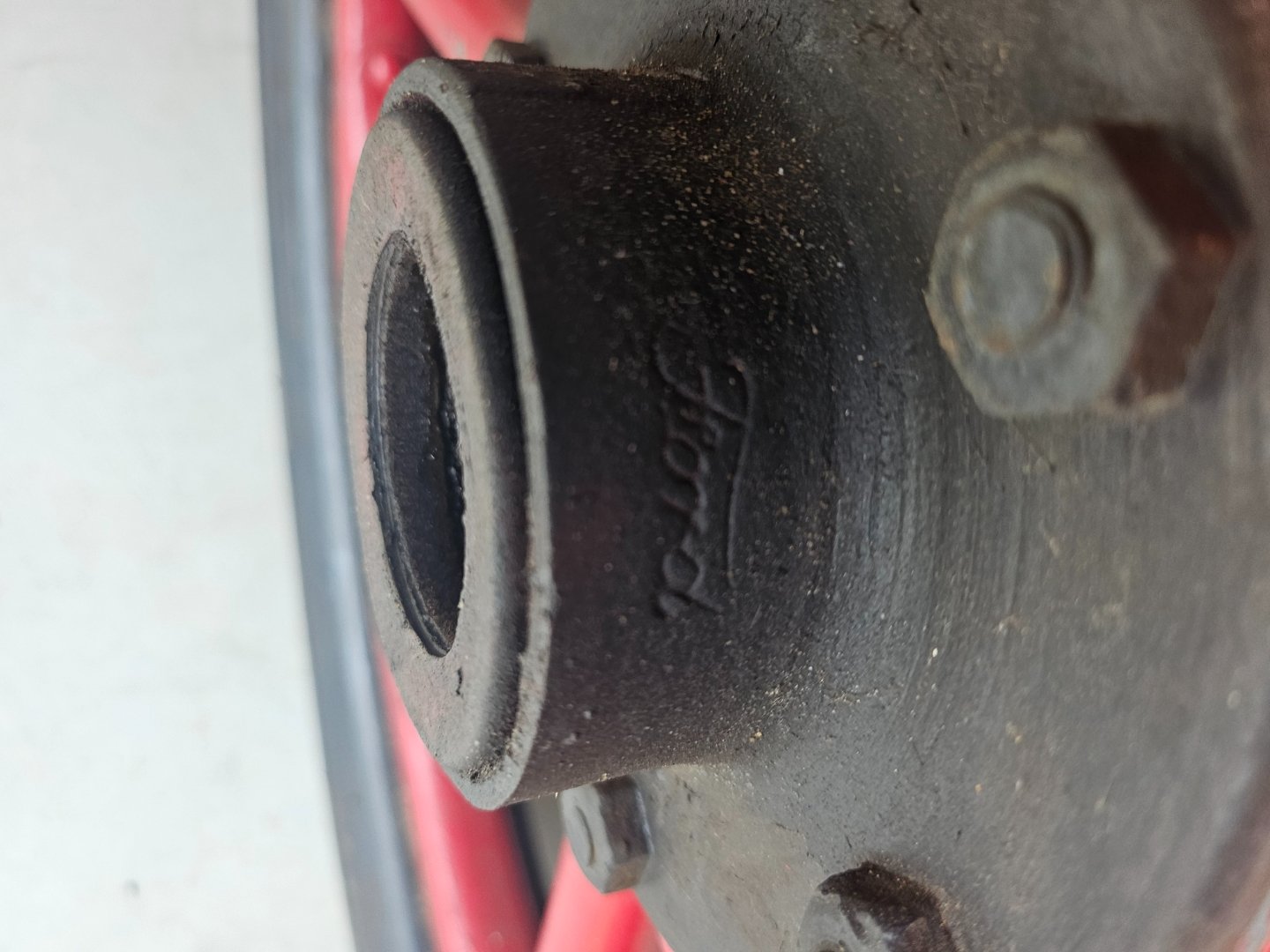

The right hub being a later "Ford" marked hub.

That early hub with wide threads can be suspect to cracking so inspect carefully.

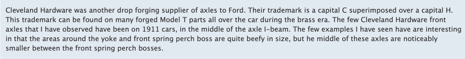

Yes the forging mark is Cleveland Hardware
Company still in business, other info from post by T. Boggess.

From the photo of the earlier hub with the long thread, the outer end looks to be somewhat wallowed outwards, so Dan's advice to check thoroughly is sound advice. The Cleveland Hardware logo appeared on a number of forgings on my 1915 Canadian tourer, especially on front axle assembly components. However, I do not believe the hubs were forgings. They are more likely castings. Rear hubs with cracked flanges certainly show this.
Good eye Allan! Yes, while the hub is crack free, it very definitely was wallered out. I had noted the hub cap had multiple cracks when I removed it, but that by itself wasn't an immediate concern given in my experience most original caps bear cracks to some magnitude.
But, once I had the new parts in hand and started the cleaning/prep, the outer bearing race came right out in my hand as I was wiping it down...it was definitely no longer a tight fit, but, neither did it show signs of spinning on the outer surface.
So, this hub just became a museum piece for me.
