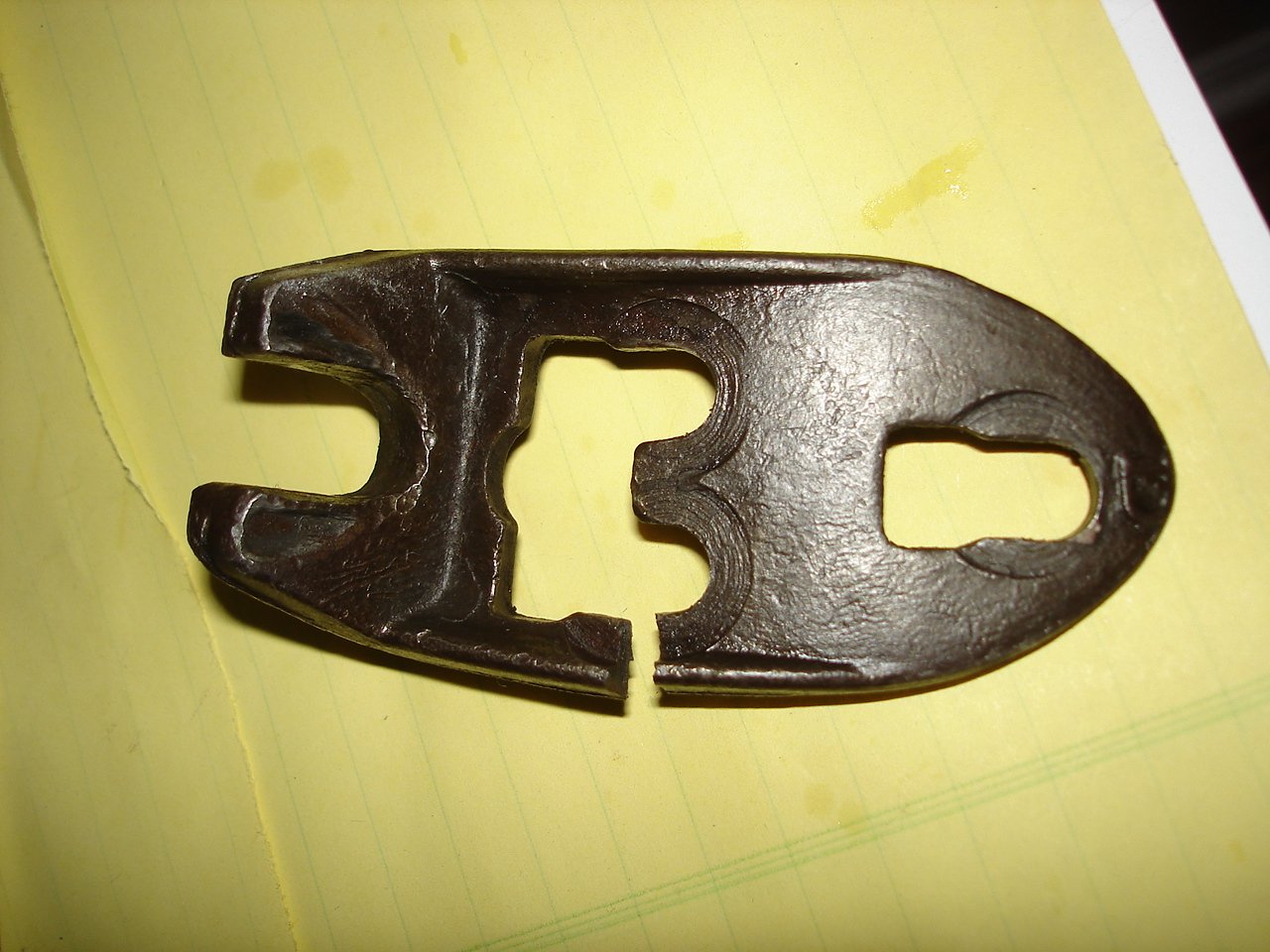

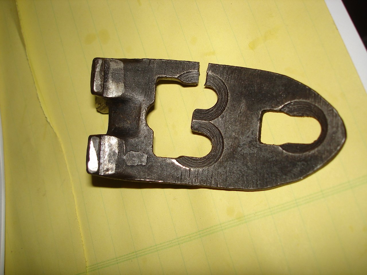

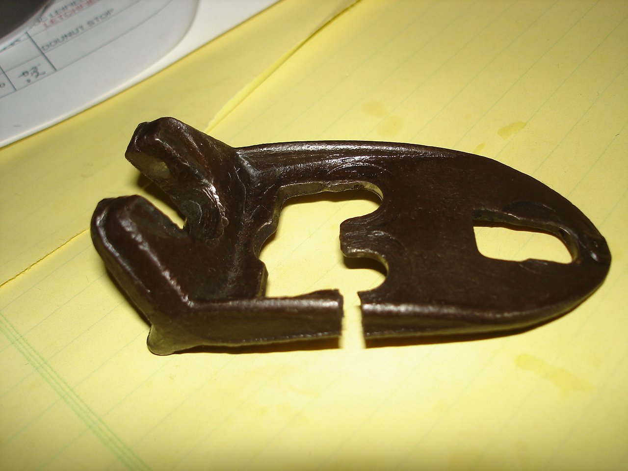

The discovery of this item made my recent engine rebuild worth very penny. This has nothing to do with the engine itself of course, but was discovered during the rebuild process. In driving the car, I had no idea this was going on, and about to fail completely. The brakes felt about as good as T brakes can be. I'm posting this as a lesson for others, and for myself, to inspect these parts very carefully.
The main takeaway here, is that this is not a genuine Ford part. Notice how the opening is not centered well in the part. The narrow side being the one that failed. Beware the bogus, spurious, parts!!

I am not so sure its spurious.
I have a few like this style. Some have ford script cut off. only one has a full script. 2 have no visible script. But the machining & forging is identical.
I had a wide band fail going down big bear mountain in a panic stop. The band (slot type) broke off @ the second slot.
Glad it was a large drum with some parking brake lining in tact. This was driving her home after the purchase.
Anyway, another bullet dodged.

There is a foundry mark on it, but no trace of a Ford marking anywhere. Either way, an important item to inspect whenever the trans cover comes off.

Amen.Jerry VanOoteghem wrote: ↑Sat Jun 22, 2024 8:30 pmThere is a foundry mark on it, but no trace of a Ford marking anywhere. Either way, an important item to inspect whenever the trans cover comes off.

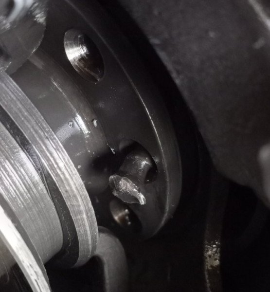

Good advice Jerry and indeed EVERY time I take the inspection cover off that's exactly what I do. INSPECT INSPECT INSPECT!...even moreso after few years back when these rivetsJerry VanOoteghem wrote: ↑Sat Jun 22, 2024 8:30 pmThere is a foundry mark on it, but no trace of a Ford marking anywhere. Either way, an important item to inspect whenever the trans cover comes off.
decided to evacuate themselves!
