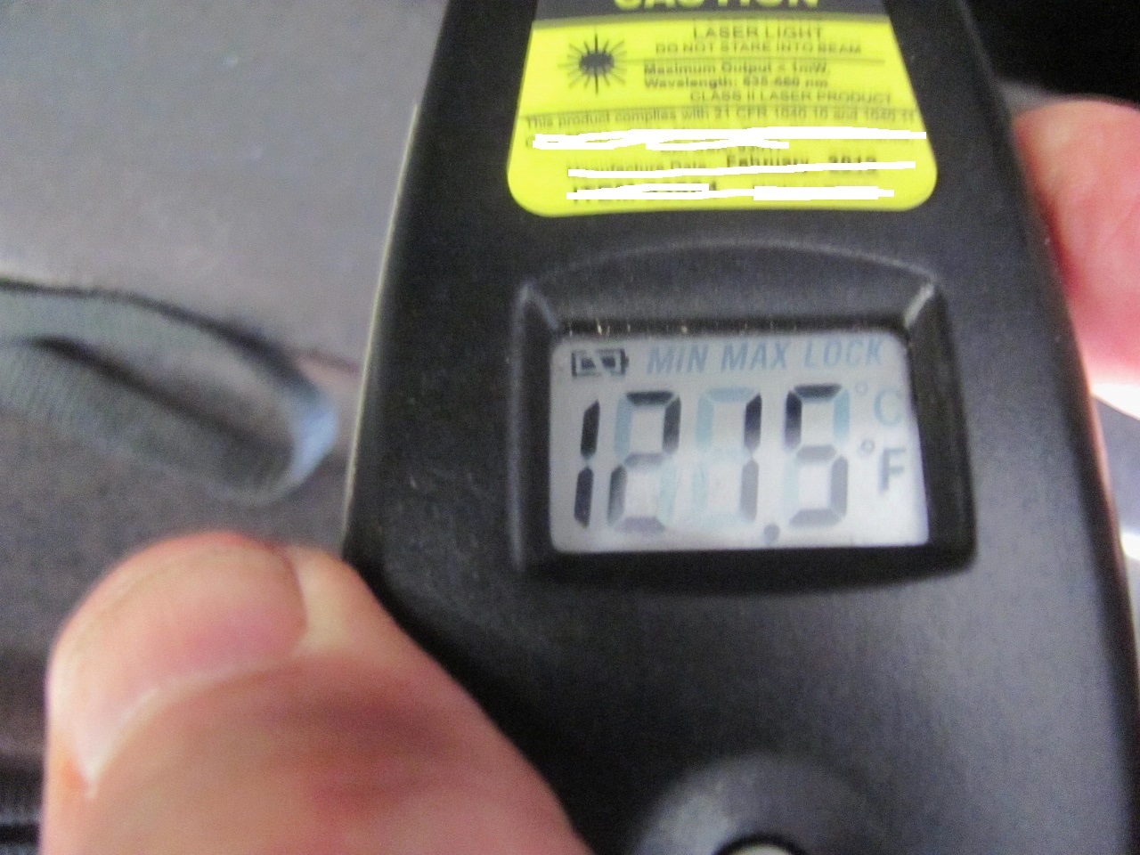

And with a low cost infrared temp gauge, you can test the system for efficient cooling, did that on a typical warm 90 degree FL day.
Pointed the infrared at the upper tank under the hood, and on the lower metal return pipe from the radiator.
Start point, T in garage, upper tank at temp of around 82.
Drove around to warm to operating temp, about 2 miles and stopped with engine idle and pointed infrared at backside of the upper tank , right at normal operating temp.
Then pointed at the lower pipe and temp was much lower, about 62 degrees difference, can touch that pipe as not too hot, of course don't touch that upper tank ;)
Added bonus, with running also a motometer, that confirmed the operating efficiency too, normal reading for summer!

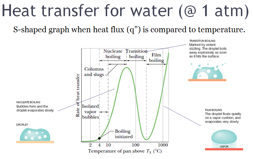

Neil's post covers the original question, but it's worth remembering that when the radiator boils you are getting nucleate boiling which gives very good heat transfer.
Kaiser
Posts: 1108
First Name: Leo
Last Name: van Stirum
Location: Netherlands
Re: How hot is cool enough?
Post by Kaiser » Thu Jun 20, 2024 6:40 am
John, I don't know where you found that picture but your graph is for a very different situation, i.e. a drop of water dropped on a surface of a certain temperature, it has little relation to a motor and radiator system filled with water that heats up while under power. What it does show however is that as soon as the water comes up to a fierce boil (transition boiling), heat transfer from metal to water drops off sharply.
The 'film boiling' part does not occur in an engine filled with water, at that point it is allready a lot hotter than it should ever get. it only happens when you drop some water on a hotplate, it is the droplets sizzling and scooting of in all directions. It could happen if most water in your engine boiled off and you re-fill the hot and dry engine with water without waiting for it to cool off, not a good thing to try, you might crack a head or a block.
Leo van Stirum, Netherlands

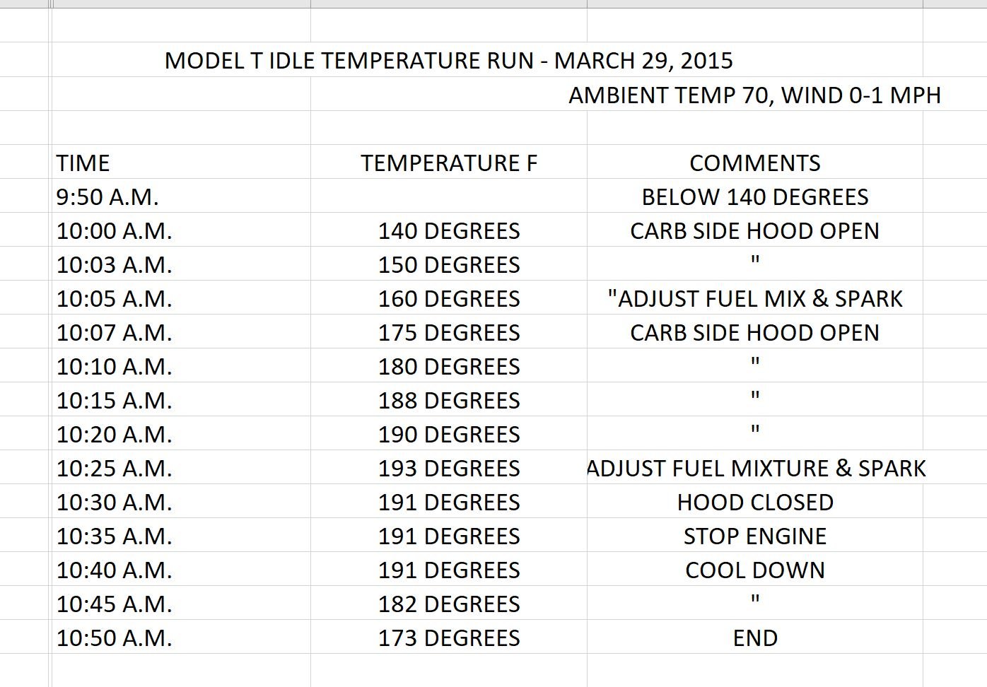

Post by John E. Guitar » Thu Jun 20, 2024 8:25 am
Here is some more information on nucleate boiling in an automotive context.
https://archive.org/details/introductio ... 6/mode/2up

Oh my! Guys, tell me no one has ever seen a pot of water on the stove, forming bubbles at the bottom, long before a hard boil. A cooking thermometer clearly shows what's going on. Some of those tiny bubbles make it to the surface. Can you see water flow? Yes, sometimes as surface wakes.

The water will begin to stir even before the bubbles form on the bottom of the pan. Most water is not pure, and most people do not live at sea level, and most water contains at least some dissolved air, which heat will tend drive out of it in the form of bubbles. So 212F as the boiling point will not strictly apply. The water in a pot or skillet will not heat evenly, especially in a lightweight vessel. It will be hottest at the point where applied heat is greatest, and the heated water will rise and be replaced by cooler water. Once boiling commences, mechanical agitation will disrupt the thermosyphon action. Boiling is to be avoided in cooling systems, except for the hopper type and the "Geyser" type, where boiling is expected to occur.
Post by Drkbp » Sun Jun 23, 2024 12:39 pm
Vernon,
Yes you are correct. Here is a 1914 that sat idling on my driveway for an hour.
Kitchen thermometer.
