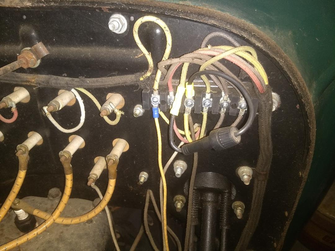

Photo #1 Ten circuit period after market fuse block.
# 2. Inline 20 amp main fuse connected to yellow main power lead going to battery side of starter switch. Much easier to get to without crawling under the car on tour or pulling the floor boards in the dark. Makes it easy to disconnect battery from non starter circuits when working on the car.
