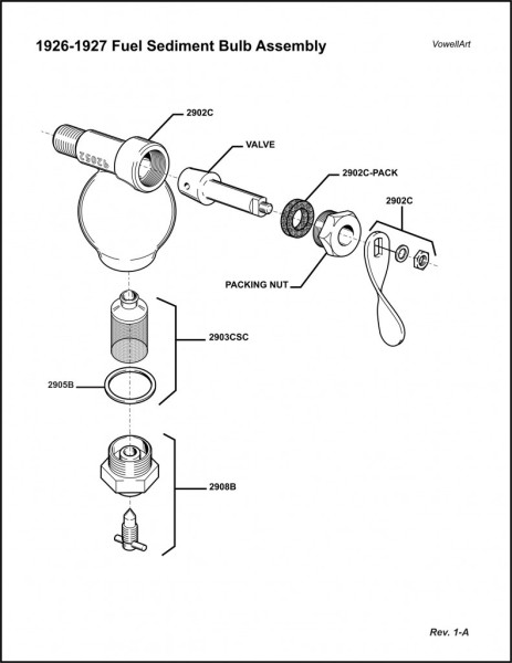

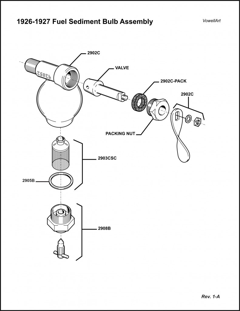

The fuel valve on my 27 Roadster has gotten impossible to turn off or on. Before I installed it about 4 years ago I lapped the brass valve with lapping compound and it’s worked great, easily turned and no leaks. Well I still have no leaks but it’s very stiff. Will it need to be lapped every so often to keep it operating?

Just back off on the valve pack nut a little bit so you can turn the valve. Be sure you have a a quart plastic container underneath to catch leakage you may have while the pack nut is loose.

I did that and it didn’t help, I didn’t have it really tight to begin with. The only thing that did help was once I backed off the packing nut I pulled out on the valve and it would then turn but once I put the nut back on and barely tightened the nut, just enough to keep it falling off it locks up again.

May have to take the valve apart. Rotate some crocus cloth inside the cast iron housing for the valve. Do the same on the valve surface of the brass valve itself. Rinse with solvent of your choice . Polish to make smooth, then reassemble with a schmeere of anti-seize and a new lead gasket.

If lapping the valve worked before, take it apart and lap it whenever it binds up, but only enough to clean off the buildup and apply a dab of grease to the valve when assembling. Jim Patrick
