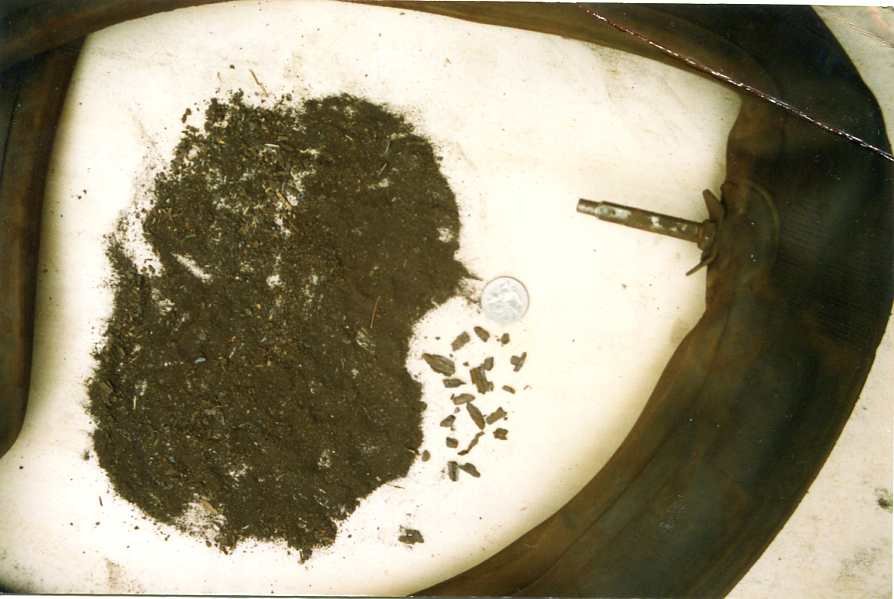

The rims were originally zinc plated because of the rust problem but years of use removes the zinc. The rims are probably the most needed part of a vehicle that should be coated to stop rust. When it rains or when your wheels get wet water will enter inside between the tire and rim and remain there especially if the vehicle is put away wet after a run. This means water can be present for a long time and the metal will go rusty.
No one is going to dismount a tire just to dry out the water, so a wheel may go for years while it still holds air before the tire comes off the rim.
Here is a photo of the amount of rust that was inside a wheel, ( this wheel was a brand new wheel) made in the 1980's which was put on a T driven for about 15 years before it had a flat. When dismounted the pile of rust particles and paint flakes came out, the rim was painted with primer and 2 coats of black enamel prior to the tire being put on. One reason a rust band or liner is a good idea, if the rust forms having a barrier between the rim and the tube helps keep the rust away from rubbing on the tube!!

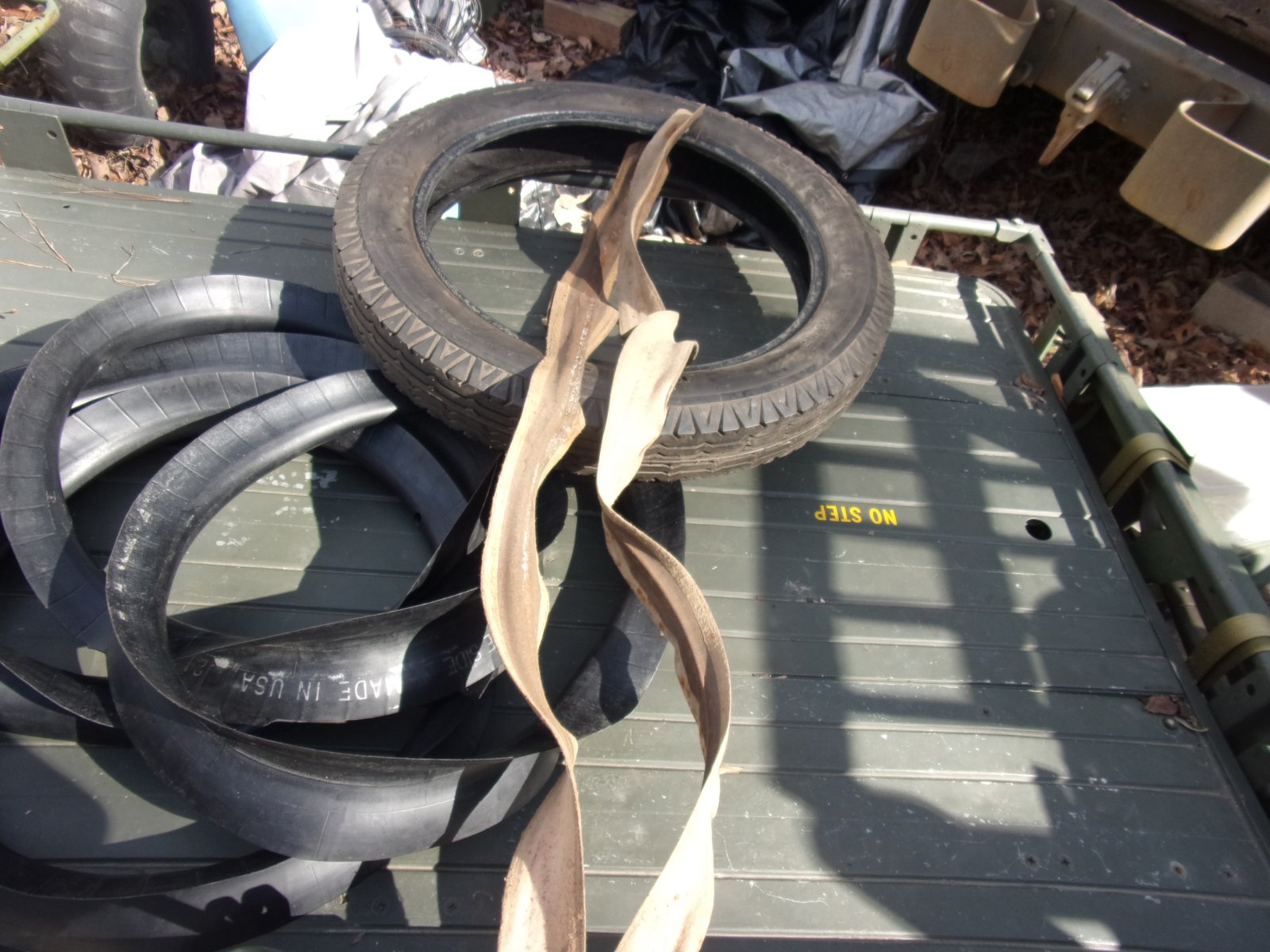

So, speaking of flaps...I am familiar with and am using the thick harder rubber flaps over my tubes on these 21" demountable rims. I have used flaps for years on my WWII jeep two piece wheels to prevent pinching during assembly. I received two "original" flaps that feel like felt covered canvas and they barely fit inside the 4.00 tires on my T. I recently read something about clincher liners and wonder if these canvas straps are actually intended for that application. They are a long straight strap with two holes at either end to slip over the valve stem and keep in place.
Are these straps flaps or liners?

Post by Steve Jelf » Mon Jul 08, 2024 1:24 pm
They are liners. They don't have to be expensive. Allan cuts his out of used tubes.
