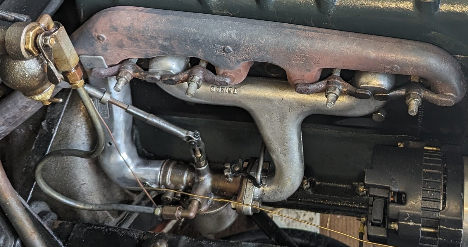

Hi volume external oiler & overfilled crankcase. #1 plug worst. #2 a bit dark. #3 & 4 pretty clean.
Runs like a molested monkey with a 280 super cam & Prus head. No power or speed loss complaints.
Heat pipe not on YET. Intake elbow ice cold. High humidity here near the coast.
Heat pipe recommended. A little top end loss with it on, but when it was on it still topped out @ 60.
Thats a satisfactory loss for this gentleman.
