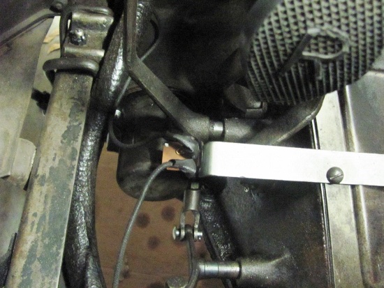

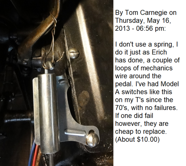

I use the 1928-29 Ford Model A switch mounted to the bottom screw on transmission door with a stiff wire between it and the brake pedal. Did the same on my 1920 Dodge. Have seen this used on several other Ts. Have had no issues even with it mounted with just the one screw.

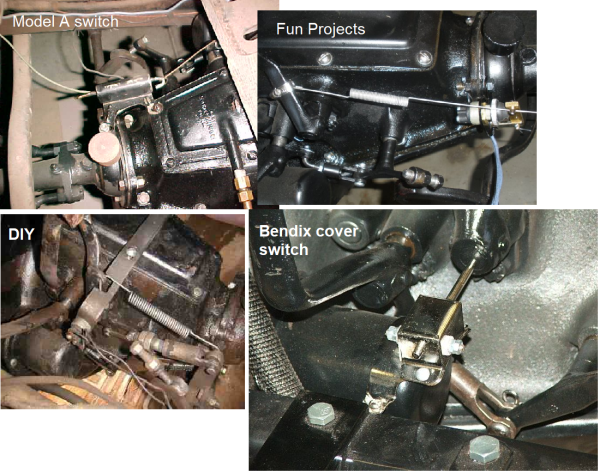

some options
https://www.mtfca.com/discus/messages/2 ... 1334538884
https://www.cool386.com/brake/brake.html

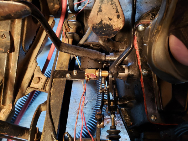

Re: Brake Light Switch

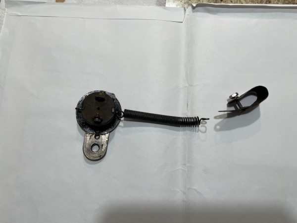

Can't remember which vendor I got this switch from but no drilling required and very easy to adjust. The bracket just clamps on the frame. For me, was the best option I found.

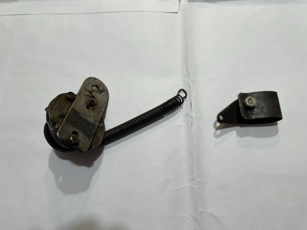

Did you find what you want, David?
Tom M. wanted a Fun Projects switch, so I looked thru my spare parts and found this one I no longer need. It is used, and worked. I went a different route when I changed wiring. I offered it to Tom a few minutes ago...not sure if he found something else. Let me know if you are still looking and if he doesn't need it, I'll let you know. Best to reply to me thru email. addufo at g mail dot com. without all those spaces of course and the usual internet symbol.
Dave

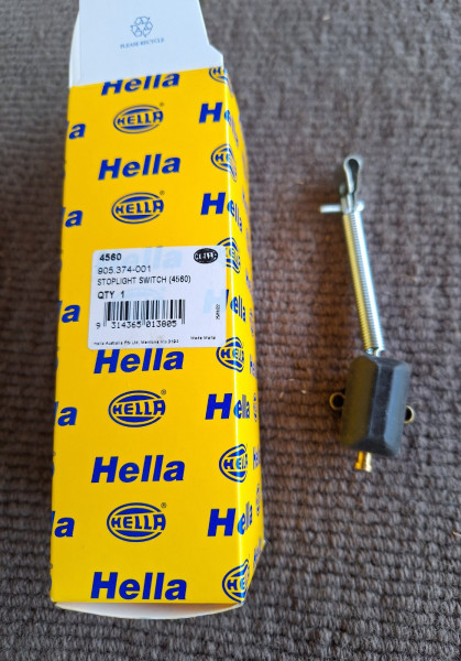

This quality Hella switch is readily available in Australia.
The position of the bend is used to set the "pull" on the switch.
Otherwise, I use a switch like the on Mikey 1968 shows . I have a few metal bodied brake light switches from 70"s 80's Japanese cars in my stash. These mount in a clamped on bracket like his. The beauty of these is the stem of the switch is threaded so the switch can be adjusted in or out to set its activation.
You could use a more modern plastic bodied brake light switch but these clip into a fixed bracket set at just the right height in the car. You would need to make your bracket adjustable to set the switch correctly.
Hope this helps.
I fix the switch body to a small bracket on the frame rail, and connect the spring to the pedal arm with a simple length of bent wire .The position of the bend is used to set the "pull" on the switch.
Hope this helps.

So do I but mine is mounted under the floor board so it doesn't get in the way when working on the trans.I use the 1928-29 Ford Model A switch

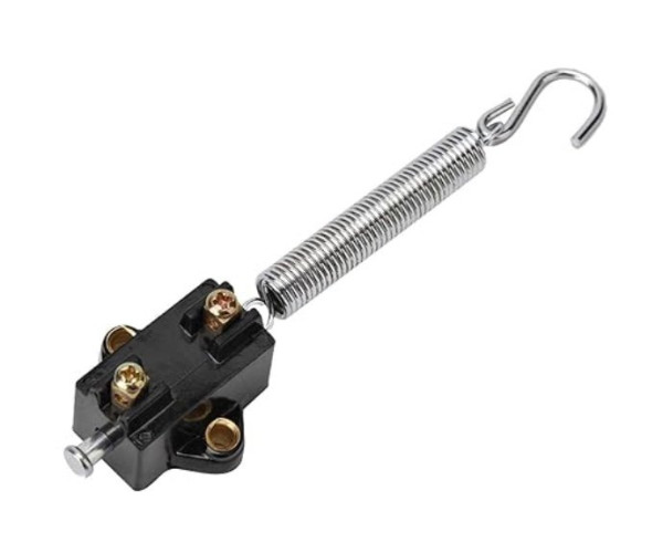

Saw this on Amazon for $8. Wouldn't it be easy to bend a piece of aluminum (steel, brass, etc.) to a not quite 90°, attach the switch to the horizontal and place the vertical under the top-left bolt on the ball cap (like the fun projects switch?) You could use a piece of safety wire to attach the switch spring to the pedal. With the switch mounted that way it wouldn't interfere with removing the tranny cover.
I used to have a Fun Projects switch but removed it (sold) when I had disc brakes installed. The disc brakes use a switch activated by hydraulic pressure.
