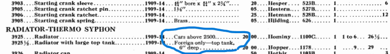

Just a query: would a modern aluminium core allow sufficient water flow without a water pump?
- Posts: 1458
- Last Name: van Ekeren
Re: Aluminum radiator
Core would work but for a thermosyphon system to work correctly a large top tank is needed, Canada Ford even fitted larger top tanks on the early models for export to hotter countries, ie, India, Africa and Australia.

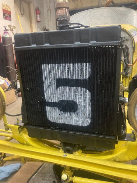

For what it's worth, I'm in my second season of running a Ford 9n tractor radiator on my speedster.
Buying a new T rad was out of the question for me so I had to come up with something.
It's a copper rad so it was within my capabilities to change what had to be changed for it
to work. The $169.00 price tag was a bonus. Works good, stays cool... It's not "plug and play"
but worth the effort.

Great idea, I looked at that but don’t think it will work out for a low radiator application. Glad it worked out for you.
Craig.
