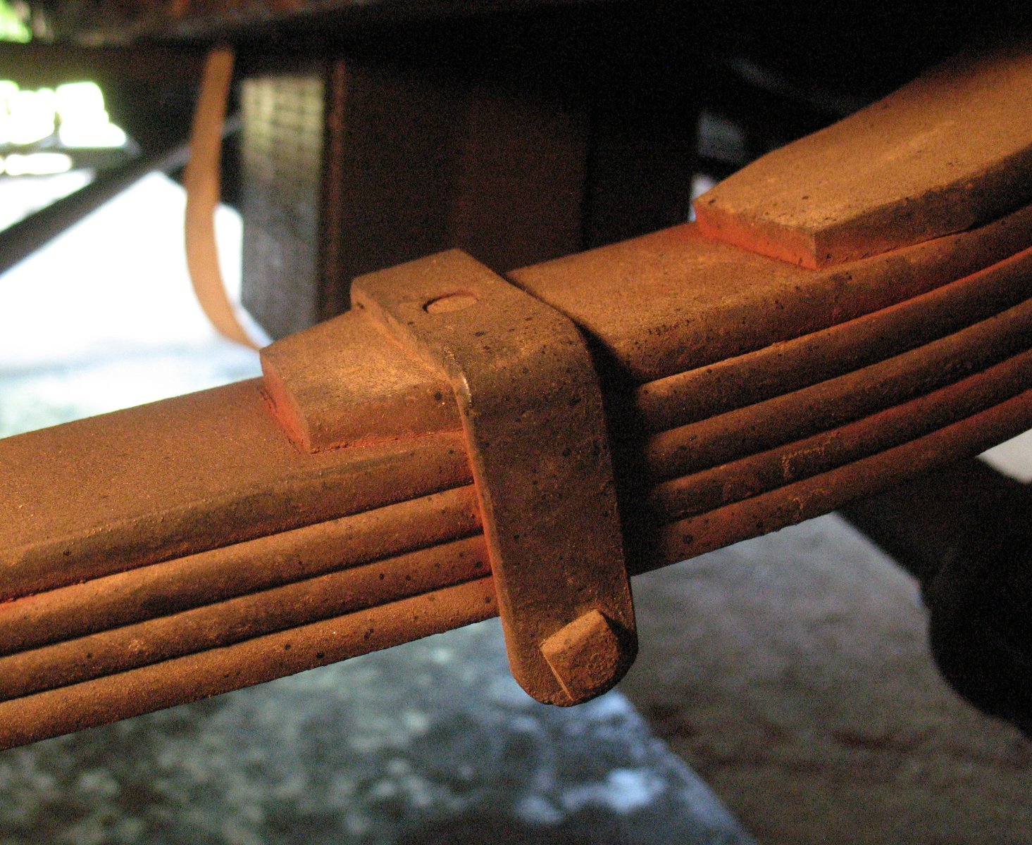

I noticed this broken right rear spring clamp on my 1923 touring and set about trying to replace it. Most of these clamps have a little tooth punched in them which fits into a hole in the top spring leaf. I don't recall seeing one like this, but maybe somebody else has dealt with this type and can shed some light. I've tried driving a big screwdriver under it with a BFH, but so far it hasn't budged.

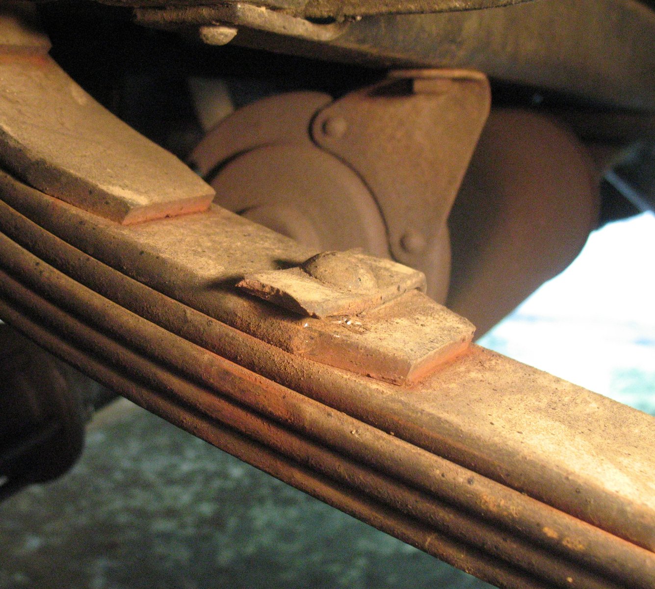

The left one has just a round hole, and it appears something round is broken off in the hole. Is that a rivet with the head broken off, or what? If I know what I'm dealing with here, maybe that will suggest how to remove it.

Sure looks like a rivet to me, Steve.
I deal with them on modern ball joints by using a HD air hammer (not HF or Crapsman) and a sharp chisel bit. Just pop the head off sideways and punch the rest out. Without a good air hammer, you can grind the head off.
Looks like you may have to separate those springs to get the rest out.

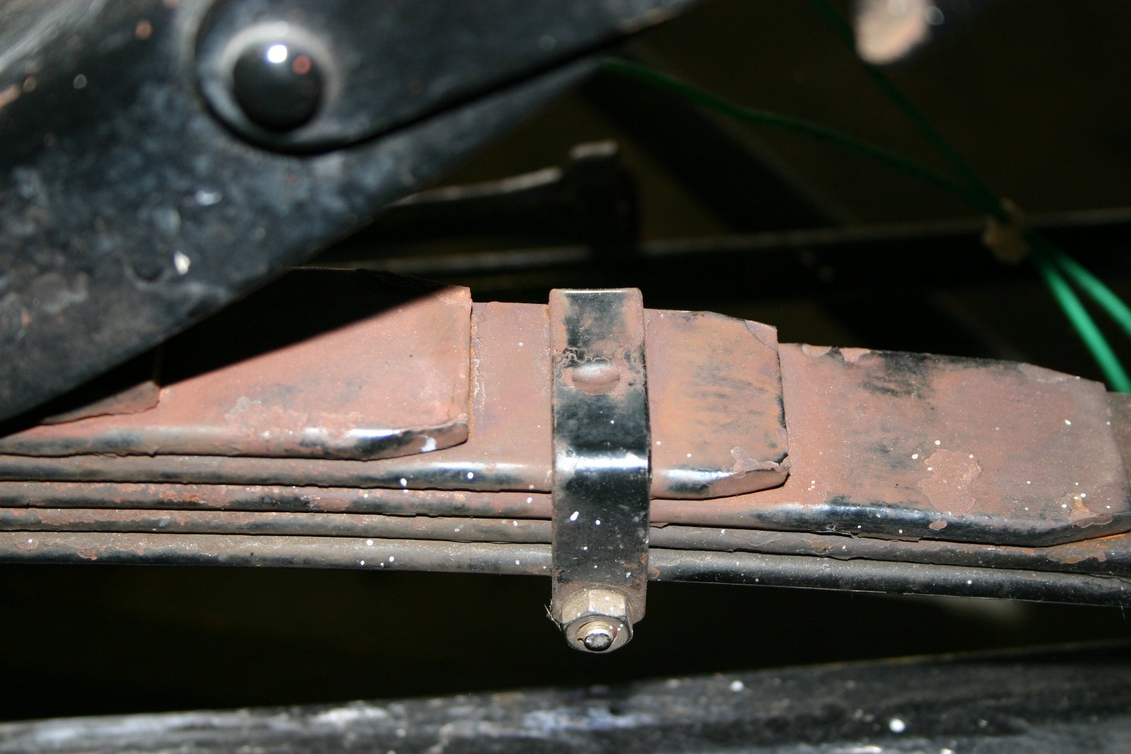

My spring clamps have the tab that fits into a small hole on the spring leaf. If you pop what looks like a rivet out, will there be a hole to use the new type of spring clamp? Mike

While most T springs used loose clamps, many with some sort of dimple to hold it in place, I have had a few with the clamps riveted onto that leaf. I have always been curious whether that was a "year" thing? Or maybe a supplier difference?
You should be able to grind or chisel the piece off, could corner weld a piece to replace what is missing, or simply drive and enjoy until you decide to rebuild the whole rear end.

I like Wayne's corner weld a replacement piece. You can always replace that whenever the rear spring is removed for whatever reason.
Simple, easy, satisfactory.

If it was mine, I wouldn’t bother at this time as the other side is obviously securely clamped and it fits closely in the cross member. Arc welding against a leaf spring is just looking for a future crack in it as tempered spring steel is NOT meant to be welded to!!

Les, I don't think Wayne meant welding to the spring. That clamp can be repaired very easily in place by welding another piece to it with a corner weld as Wayne said. The spring wouldn't be affected at all. That's what I would do in a heartbeat. Dave

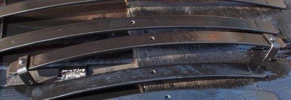

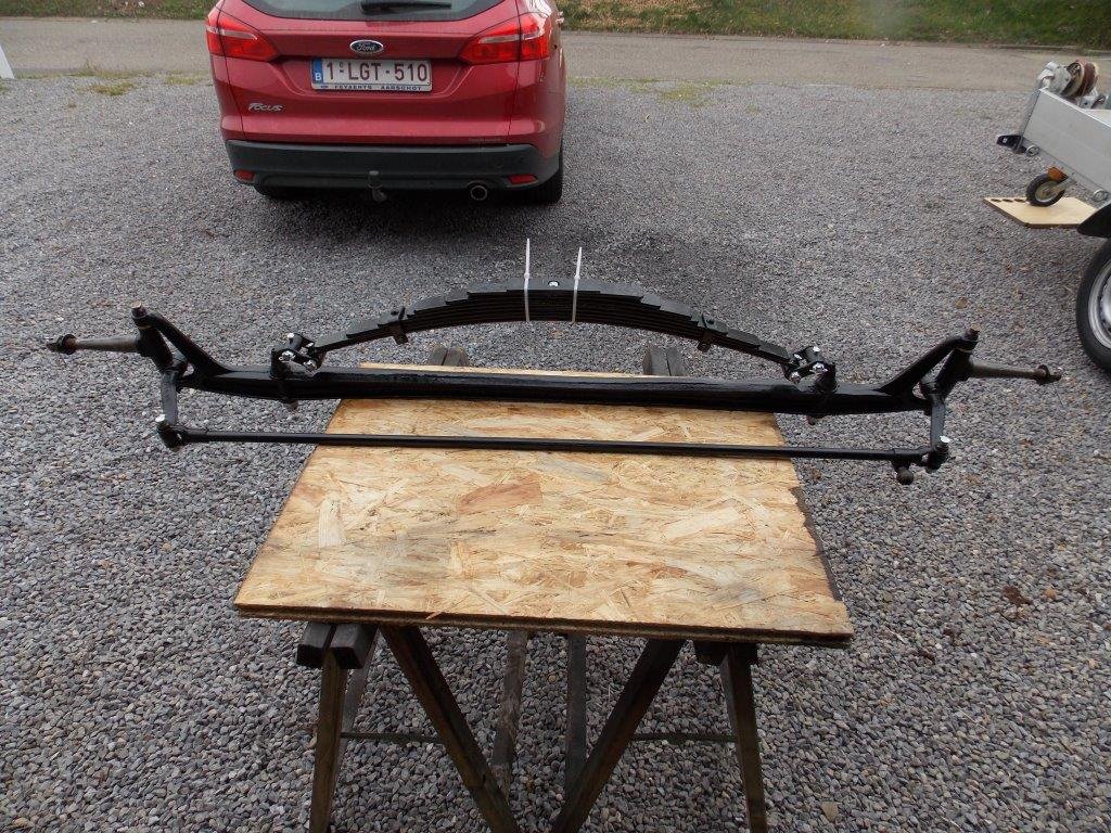

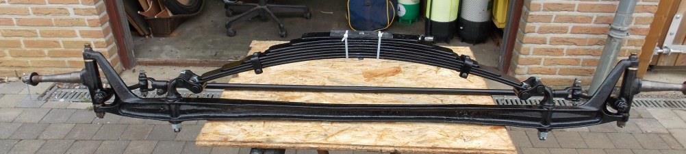

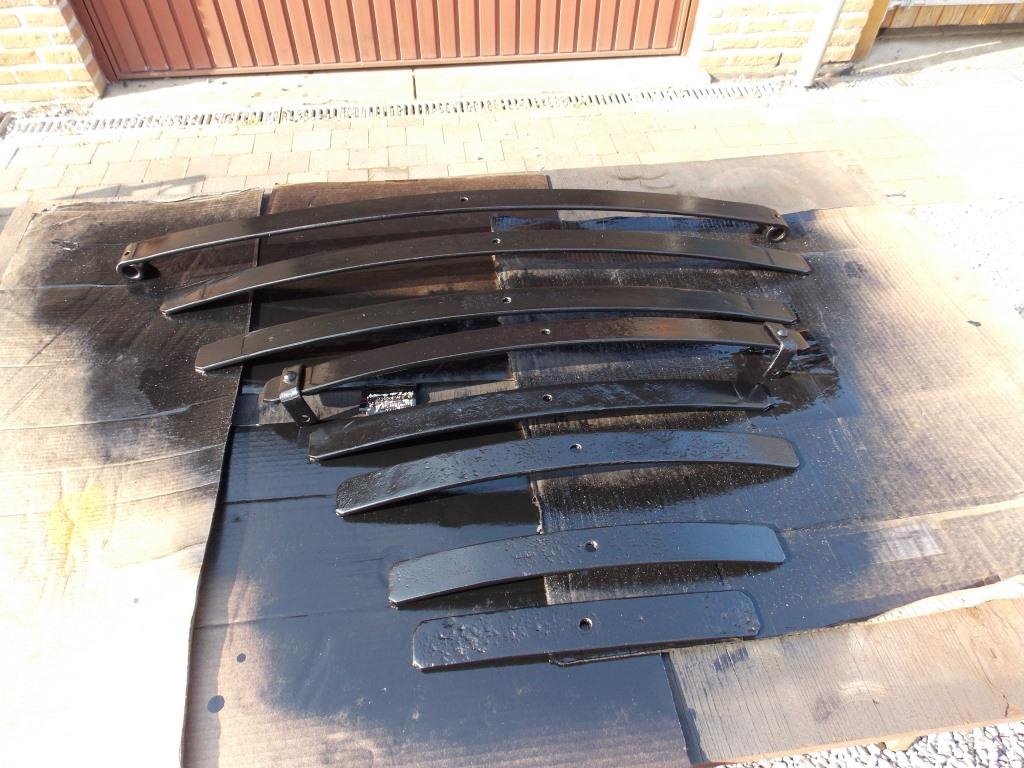

Here is a front spring with the same construction.
I rebuild the front axle and as the spring was solid I just installed the leaf as it was.
Andre
Belgium
Andre
Belgium
