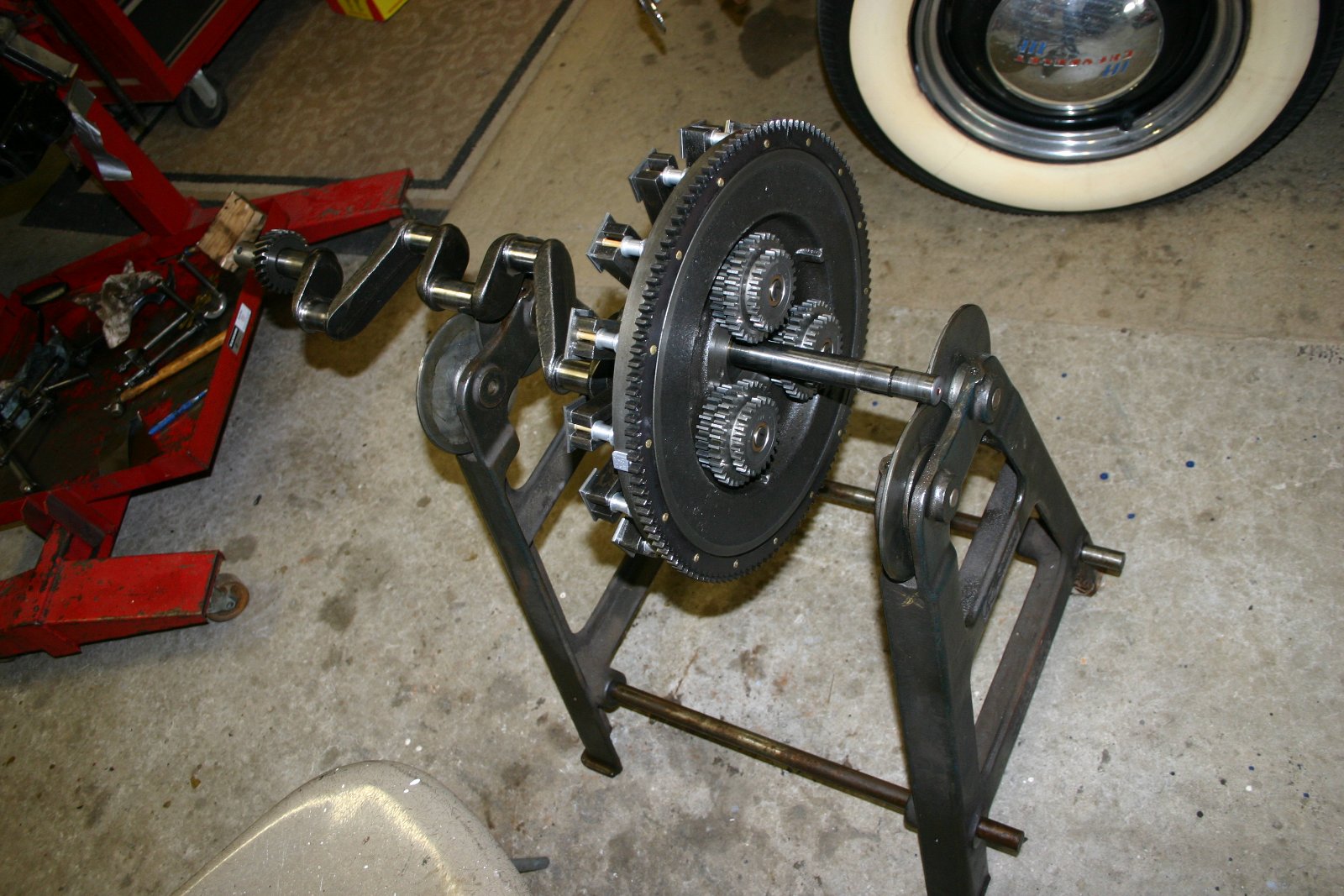

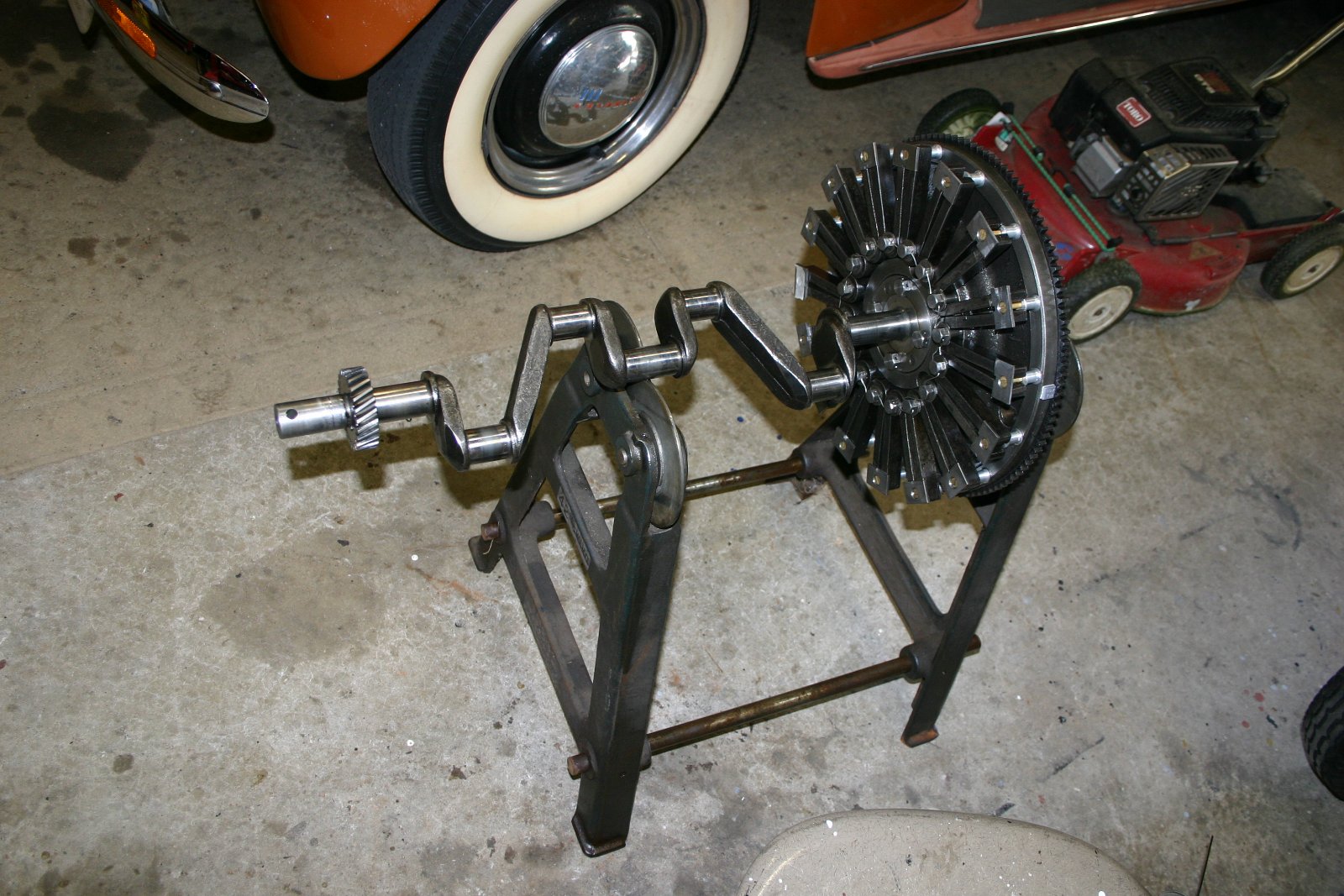

Well, OK I'm going to approach this from another angle. I'm wondering about the rotational balance of my engine. So I dragged out the grinding wheel balancer, assembled the crankshaft, flywheel with magnets on it, the input shaft and the triple gears in their proper positions. Then set it on the balancer.
After a few spins I found a consistent heavy spot. I then used a 7 gram stick on wheel weight on the opposite side of the heavy spot. Now don't cry the sky is falling, the Martians are invading or some other nation emergency, I'm not installing it with this weight. I'm just looking to see if I can figure ot how out of balance my engine is. You can see the weight as the gray square on the edge of the flywheel. Obviously, I do not have the drums and clutch attached, which is a good amount of weight, but how far out of balance could it be? For that matter is 7 grams out of balance A LOT? I have no feel for what is bad, or so-so or even OK, Mike

Trying to balance it the way you are is a bit difficult.
If you have someone that can spin balance the flywheel you'll be in a lot better place.
Then you can contemplate machining weight of the triple gears.
