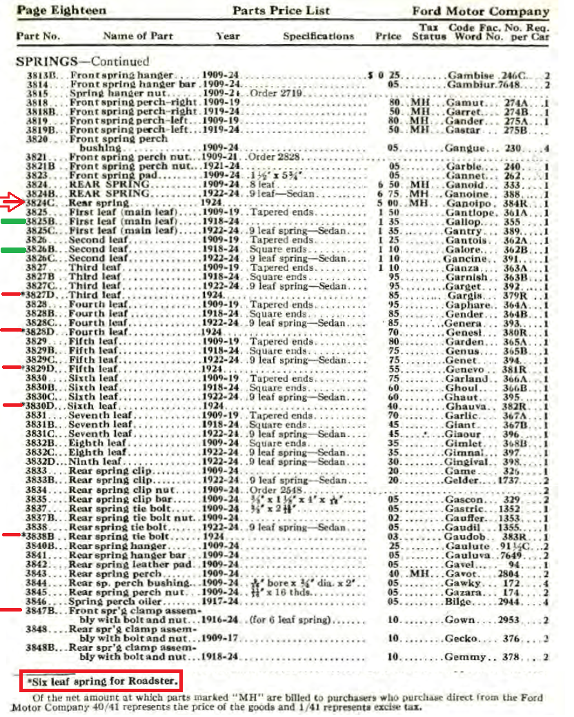

This may help
From https://www.mtfca.com/discus/messages/1 ... 1302150014
" Dave Martin on Wednesday, April 06, 2011 - 10:56 pm:
It�s interesting to note that the bottom two leafs are the same as the typical 8 leaf, and only the top 4 leafs are different, and have unique part numbers. The book also lists the tie bolt, but I don�t see different spring clips. There was recently a Roadster on the MTFCA classified ads that had this 6 leaf spring, the seller emailed photos, and the unique spring was clearly visible by the shorter leaf lengths.
I understand the parts book lists this unique spring as standard equipment for 22-25, but this particular car was the first one I have ever seen with this spring. Could there be evidence that maybe not all roadsters from the 22-25 years had this spring? With these being the highest production years, it seems like a lot more examples would be around. Unless they were too weak or failed prematurely?
I spoke with one of the gentleman making the �T� springs at Hershey a few years back, and he seemed receptive to making a 6 leaf, if drawings were supplied. I�d like to compare the drawings of the 6 and 8 leaf springs to see if the arch or shape is different, or if the difference lies solely in the length of the top 4 leafs.
Part 3824c would be the entire spring. Since 3825B & 3825C are the first two leaves they would define the arch height (you already have those). Then 3826D, 3827D, 3829D & 3830D the remaining leaves. Also unique parts for the clamp & bolt
