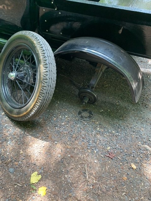

The main problem is someone else made the change and added Rocky Mountain Brakes.
With the main wheel casting broken apart and no place to find one, the easiest fix was to switch to Ford's original wheel hubs.

Not sure what you had that failed, but there was clearly a poor adaption done.
Adapting a wood wheel hub is not the way to go, as I mentioned earlier & your picture clearly shows.
Wire wheel hubs are machined with a taper that tightly mate to the inside of the wheel.
The lug nuts hold the wheel on but the hub center supports & centers the wheel.
You cant bolt a wire wheel against the R/M drum.
Now you have zero wheel support & the wheel is fatiguing the drum. That must be what happened here.
My previous post suggestion didn't consider small drum R/M brakes needing to be used.(you left out that critical bit of info)
Larry may have accidentally given you the best advise. Wood wheels.
Or my idea of a big drum rear end.
You are lucky you were not going to fast & no one was hurt.
