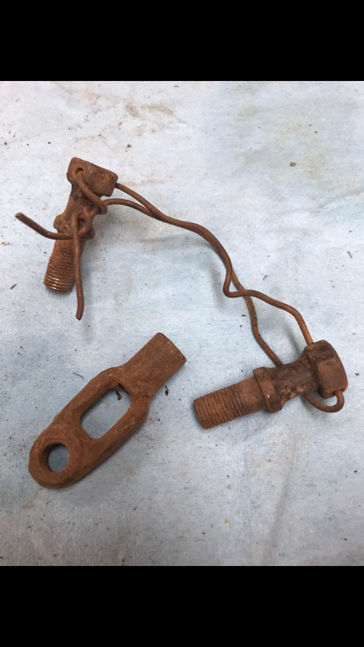

These were in an old can of T parts, but I can’t place them. If T related, where do they go? The bolts are 3/8” fine, and the rod end of sorts is 5/16” fine. Thanks!

Bolts are 2 of the6 needed for the late26-27 wide drum output plate.
The other part is a model A brake rod end? Not an A expert, but looks familiar.

Thanks! I looked up the Model A brake rod end, and you’re right on that too.

Those 26-7 bolts superseded an earlier type with a slotted head, meaning a screwdriver was used to tension them. These later ones are far more satisfactory. At least, that's what I have found on our Canadian sourced cars.
