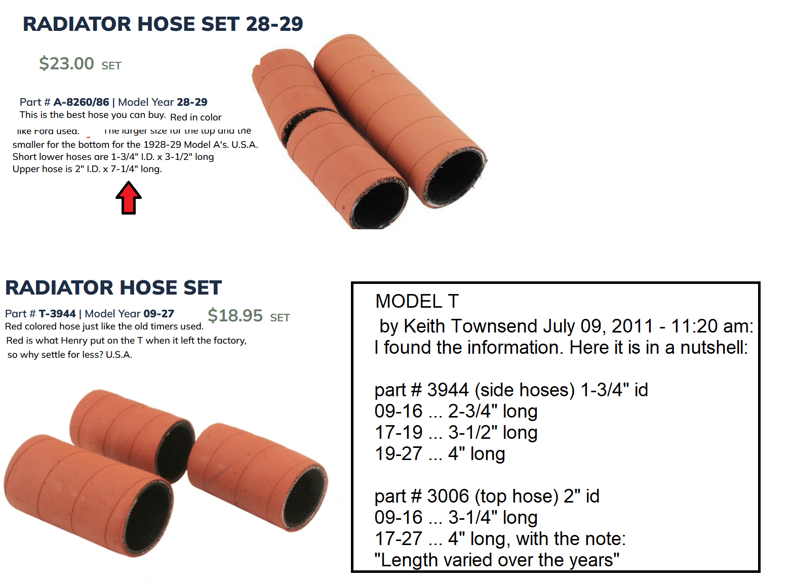

I had posted this back then. For 1917-27 get a Model A hose set, trim to fit

Post by signsup » Tue Jul 23, 2024 8:50 pm
That would have worked as well. but, only the 30/31 set would have given me the needed lenght for the upper hose. But, it would have worked as wel. Thanks for that info.

Post by John Codman » Fri Jul 26, 2024 1:06 pm
I bought a hose set from Lang's for my '27 in 2014. The upper radiator hose is six inches in length; it fit perfectly.

As I mentioned, my radiator is an aftermarket and appears to be higher than the standard Model T radiator, hence, the need for a longer hose. But, I have read previous years threads about other having a similar need. I am sure with thousands of hoses sold, the vendors have the correct length for the correct fitment.
