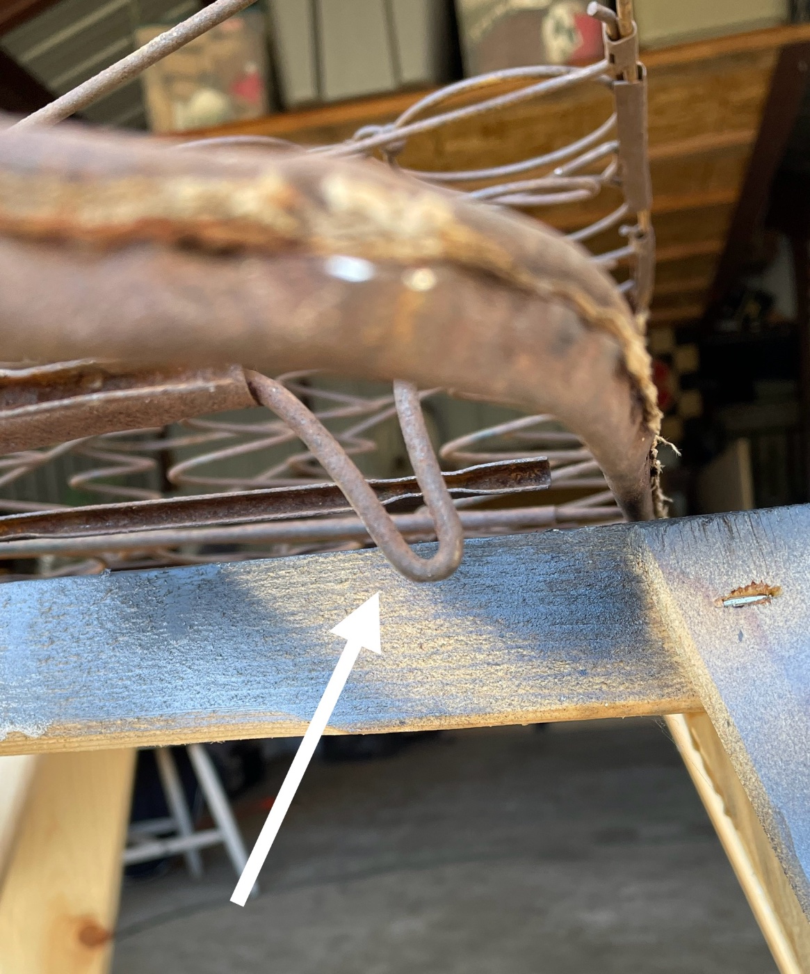

Has anyone seen two "legs" on the bottom of their seat springs?

Those are for holding the springs into place. They go into corresponding holes in the seat frame.

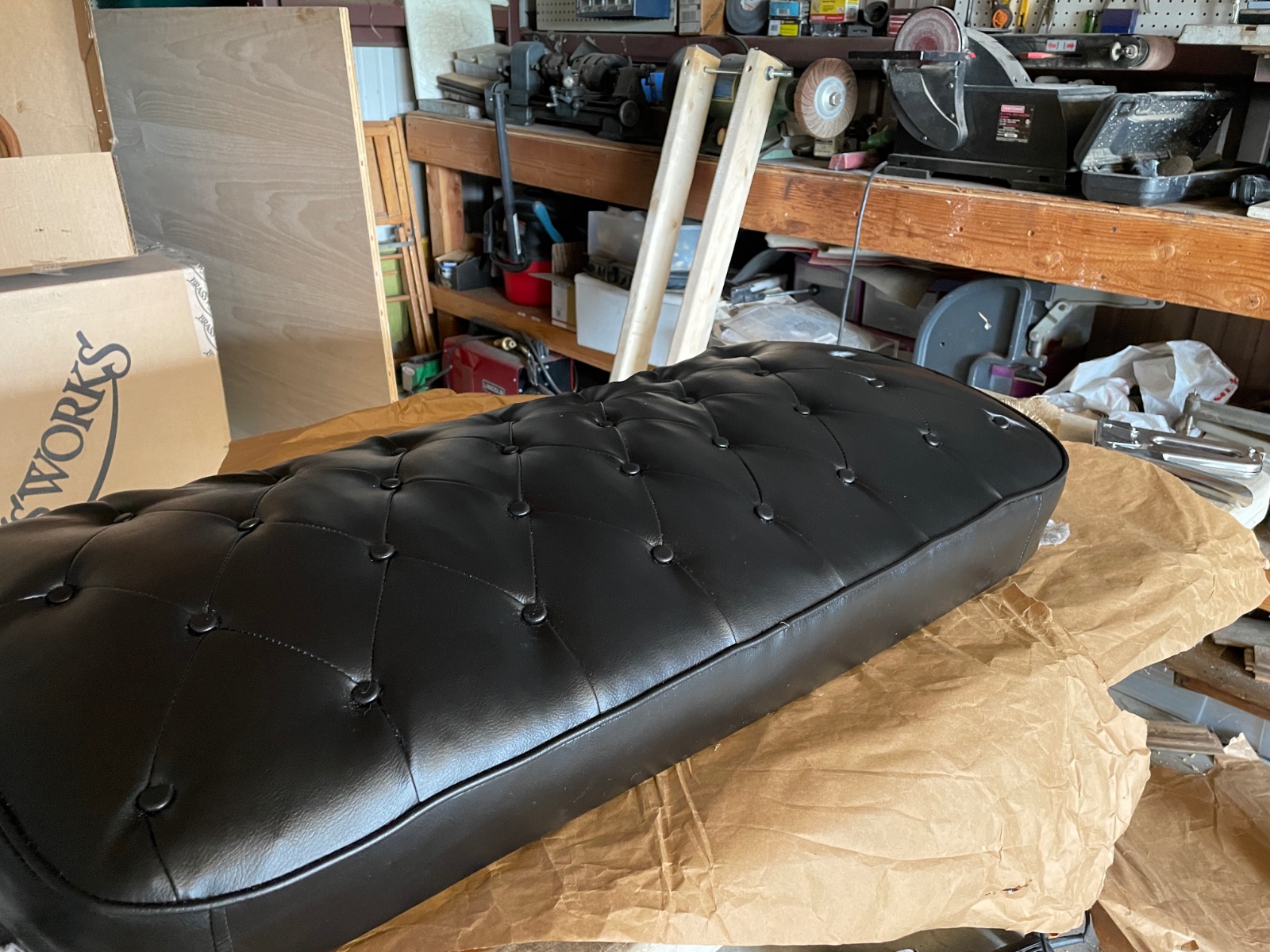

Thanks Ken. My seat platform doesn’t have holes so I just took the legs off. I suspected that but without clear evidence I chose not to drill my restored seat platform. Next time I’ll do it right.
