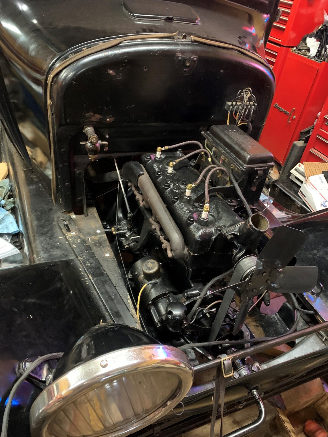

Here is my set up

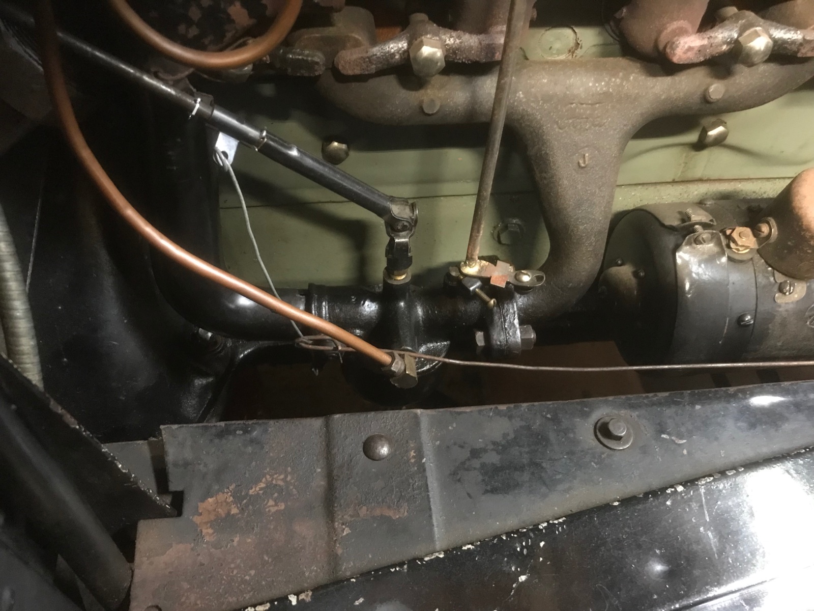

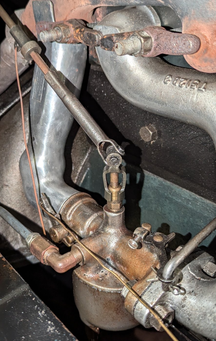

You will need a shorter fuel control/choke rod. The one that runs up through the dash. Here are pictures of with vaporizer and then with an NH.

Thanks for the photos!
