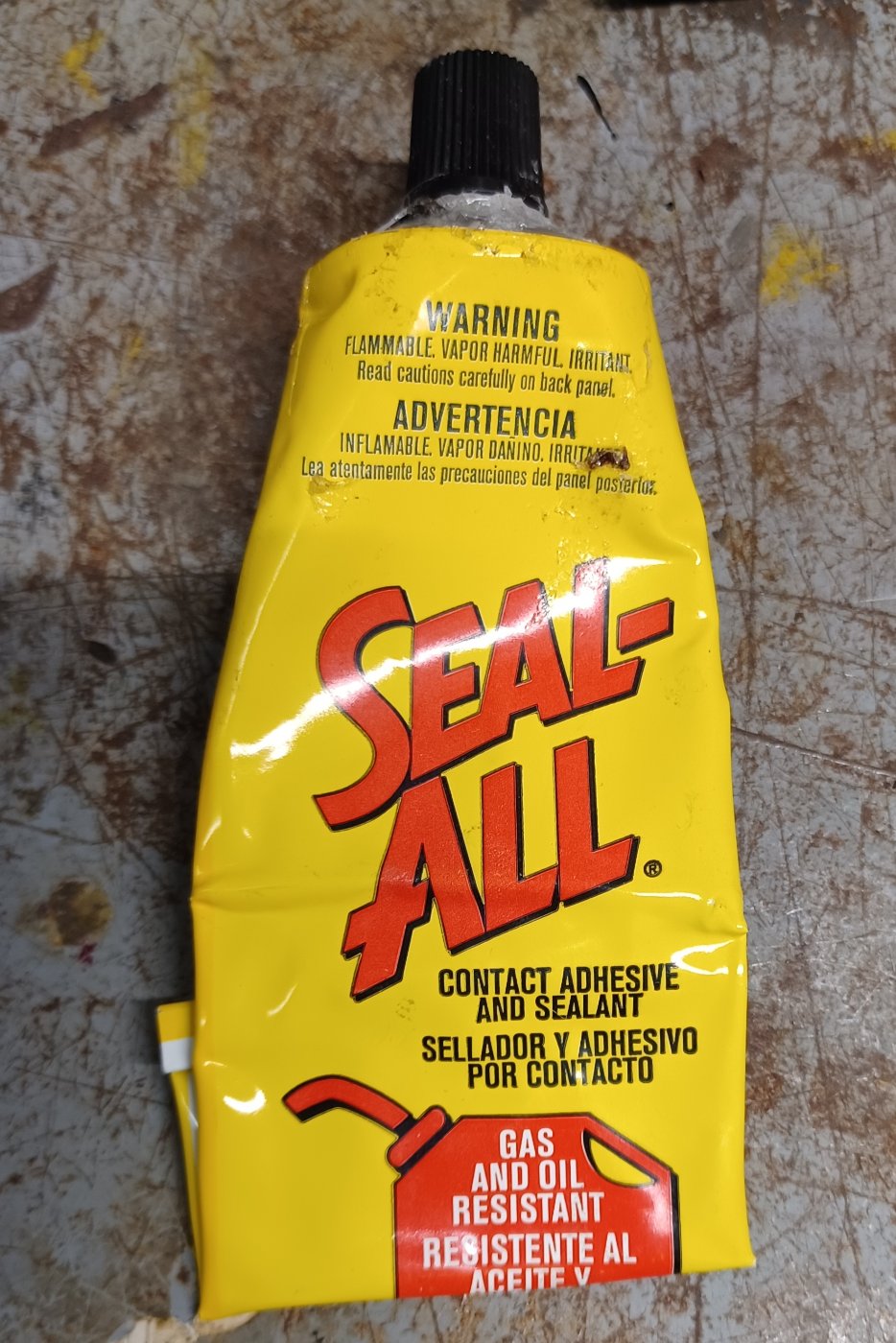

Try this stuff after you've emptied the radiator and made SURE it's DRY. Also wipe the area super clean with lacquer thinner. Then apply 2 or 3 coats with plenty of cure time of course. This study is very thin and does set up taxky very fast. I've stopped top tank seeps with it witj great success. This is fantastic stuff for multiple uses.
