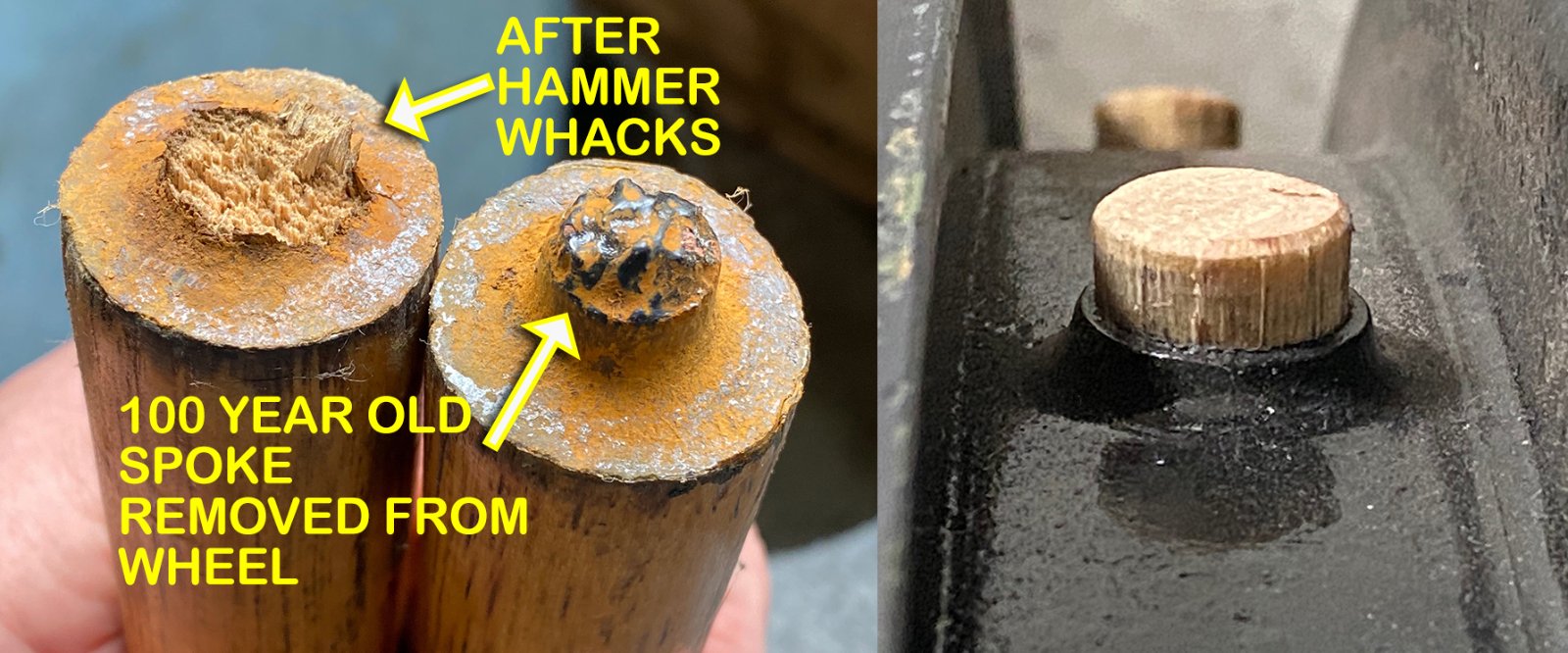

Your wheel is unlikely to fail when driving straight. The load applied in a turn or by a pothole might be enough to cause it to fail, especially if the tenons are rotten. I wouldn't chance it.
I've had good luck with Stutzman ((330) 897-1391) getting a fast turn-around. Call and leave a message and see what he has to say. Ditto for any of the other rebuilders.
I found this inspecting a wheel where the spoke was only a little loose. A couple of whacks with a rubber mallet and the tenon sheared right off. The photo on the right is what they are supposed to look like. I'm often surprised that people don't always seal the tenons on a new wheel with varnish or paint.
