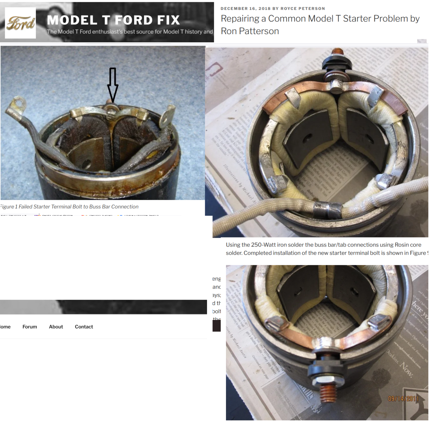

- Posts: 6579
Re: Starter wireing diagram help needed.
This helps on soldering https://modeltfordfix.com/repairing-a-c ... r-problem/

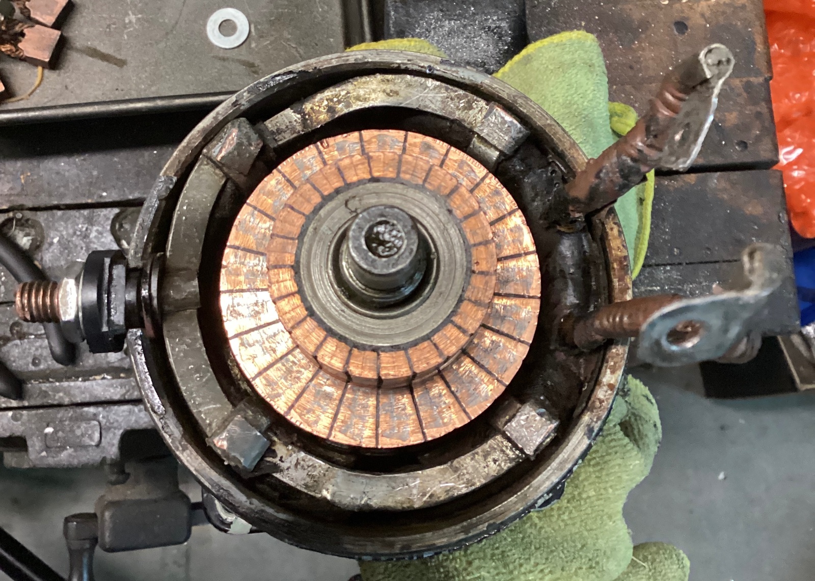

Gentleman, great advice, Franks data I cannot open.
As you can see from my picture, I have a situation. What should I do next, my starter does not match the diagram above. Do I cross the leads?
- Posts: 5246
Leads do not get crossed in a starter.
1) I doubt you could & reach the brush holders. 2) Both wires are tied together electrically, so it wouldn't matter.
JTT3's picture is for a generator, not a starter.
Also, the mica does not get cut back on a starter commutator.
See the service manual.

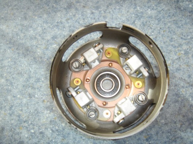

Ron Patterson
The diagram posted above is for a generator filed winding NOT a starter field winding.
Attached is a photo of the brushplate inside the brushcap and you can see the two insulated brusholders.

J1MGOLDEN
- Posts: 1322
- Last Name: Golden
- Location: Bowie, MD
Something about that starter does not look right!
