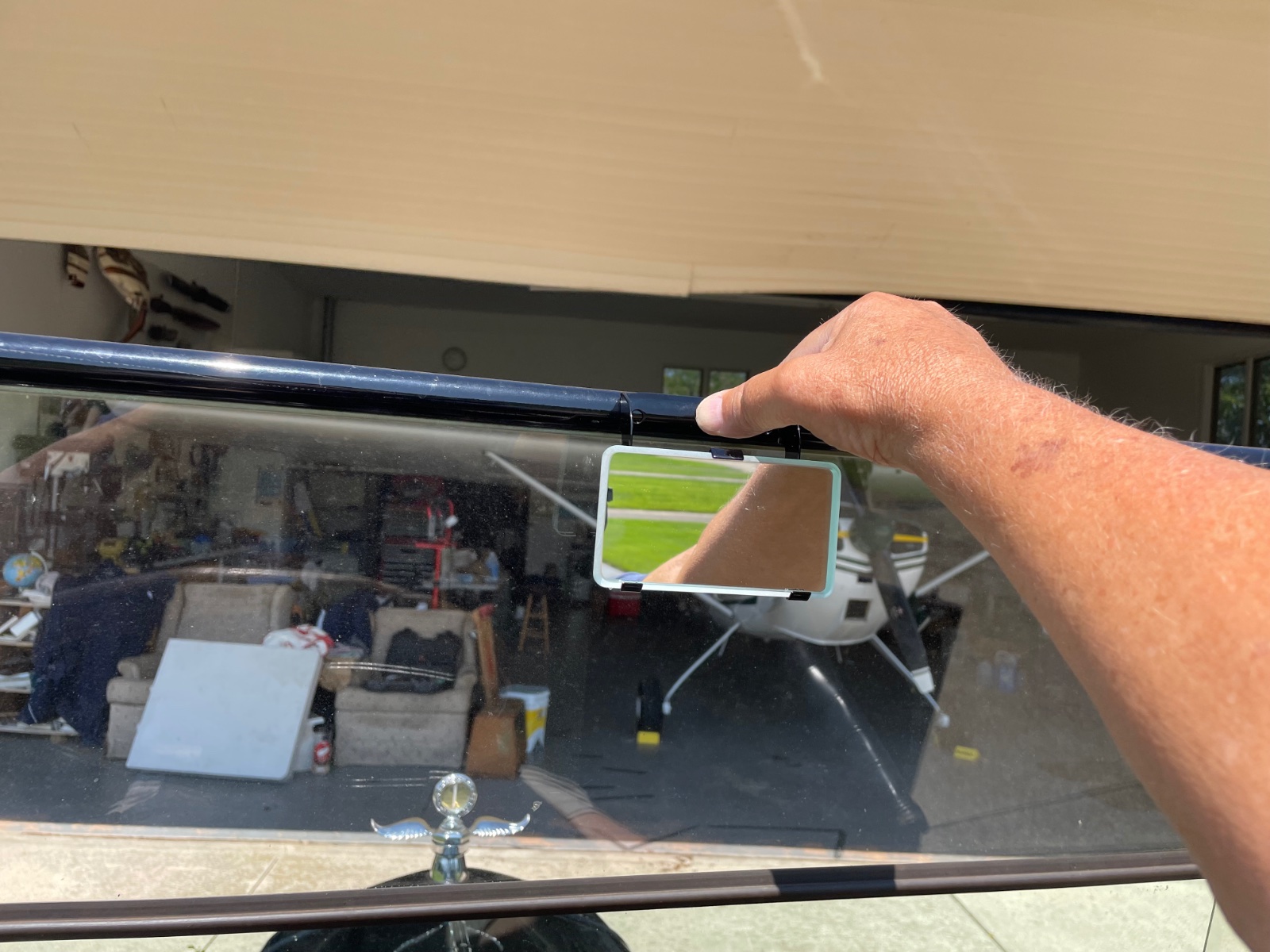

I just purchased the repro inside mirror for open cars (T-7853-X) from Snyder’s. It came without mounting hardware or even so much as a picture or drawing of the installation. From my recollection of ones I’ve seen, the photo shows what I believe to be the correct orientation, which will also work with the top up. The windshield frame on my ‘24 Touring has no mounting holes at all. I’ve read where some are centered, and some are off center either way a few inches. Is there a prescribed or preferred location? I would like to leave room for eventually installing at least a manual wiper.
Another question is the best way to mount it. Is there some sort of clamp system available to keep from drilling holes in the windshield frame? If not, can I just drill and tap one side of the frame (#10 or #12?) or drill through holes and use screws and nuts?

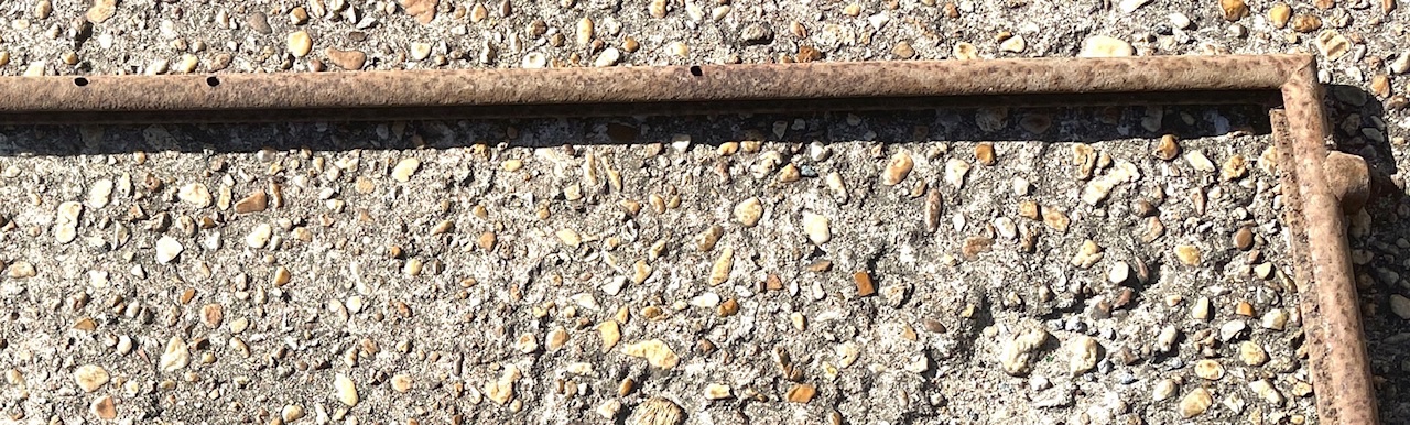

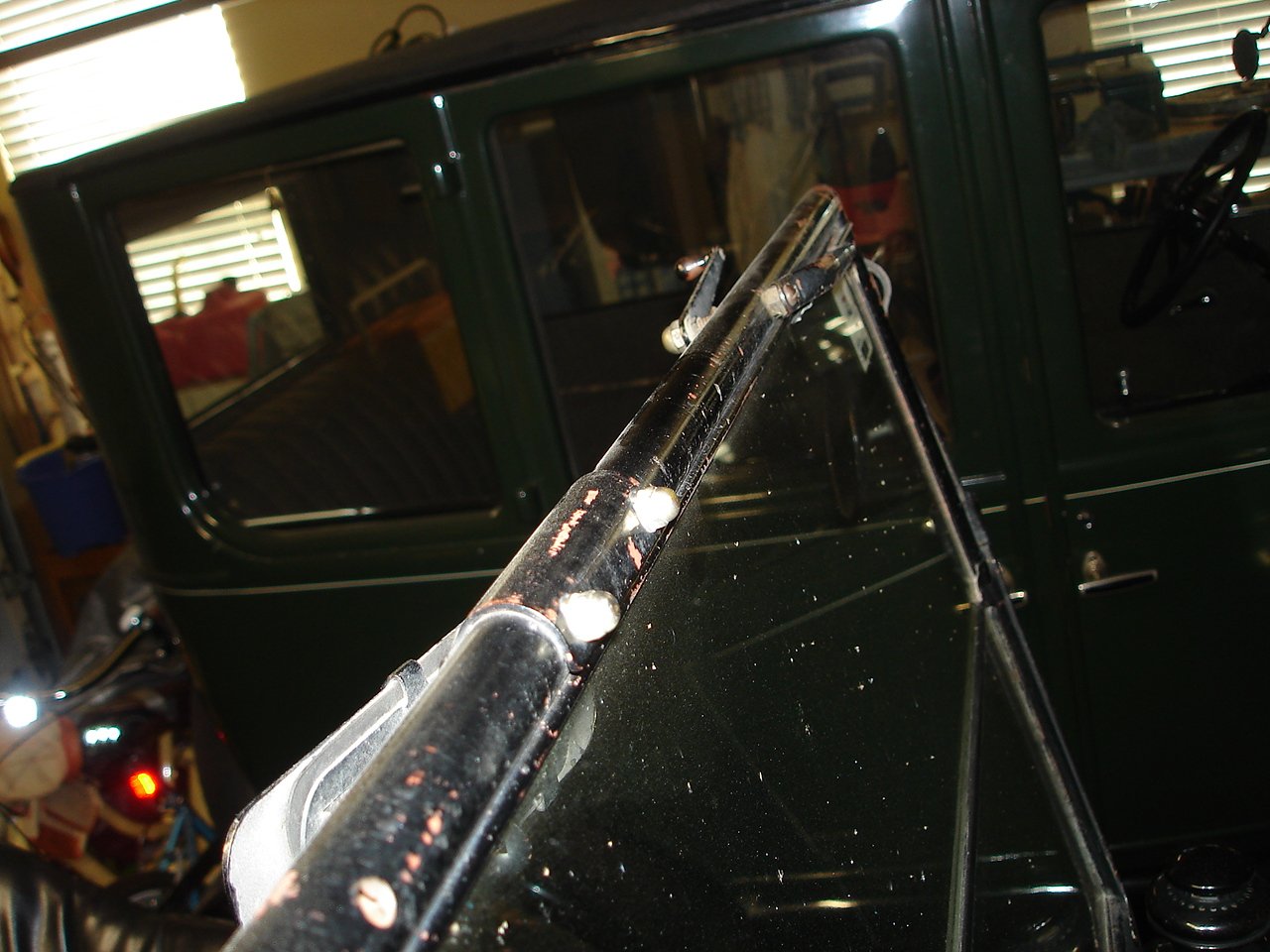

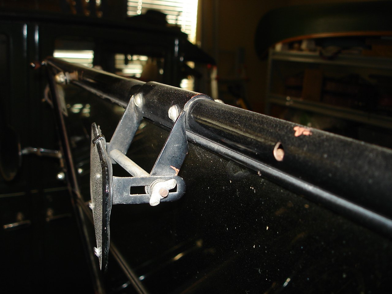

I believe Ford drilled all the windshield frames for the wiper, and the RV mirror whether you were going to use those items or not, beginning in late 1924. If you choose to drill the holes, find a late 1924 or later windshield frame for a sample. I don't think the mirror is perfectly centered.

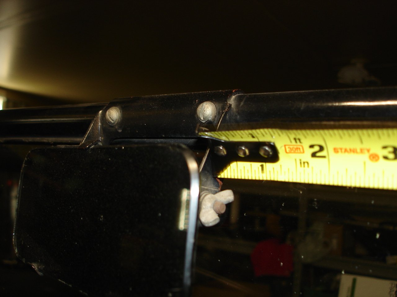

Miles,
The placement of the mirror on my '25 Touring...

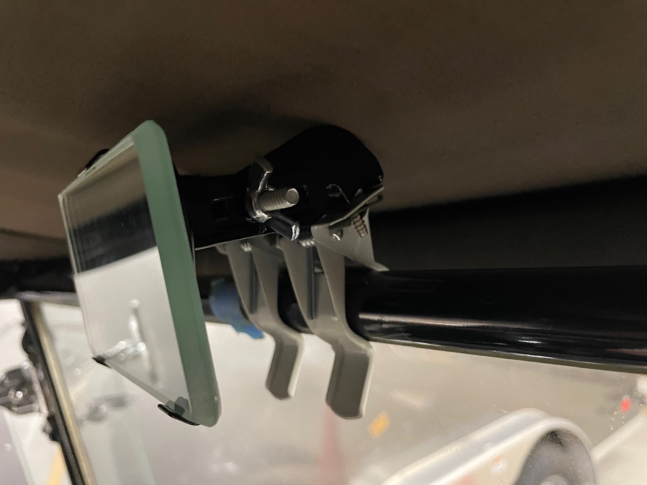

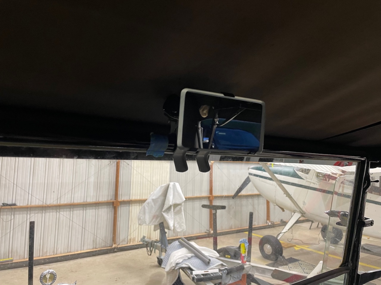

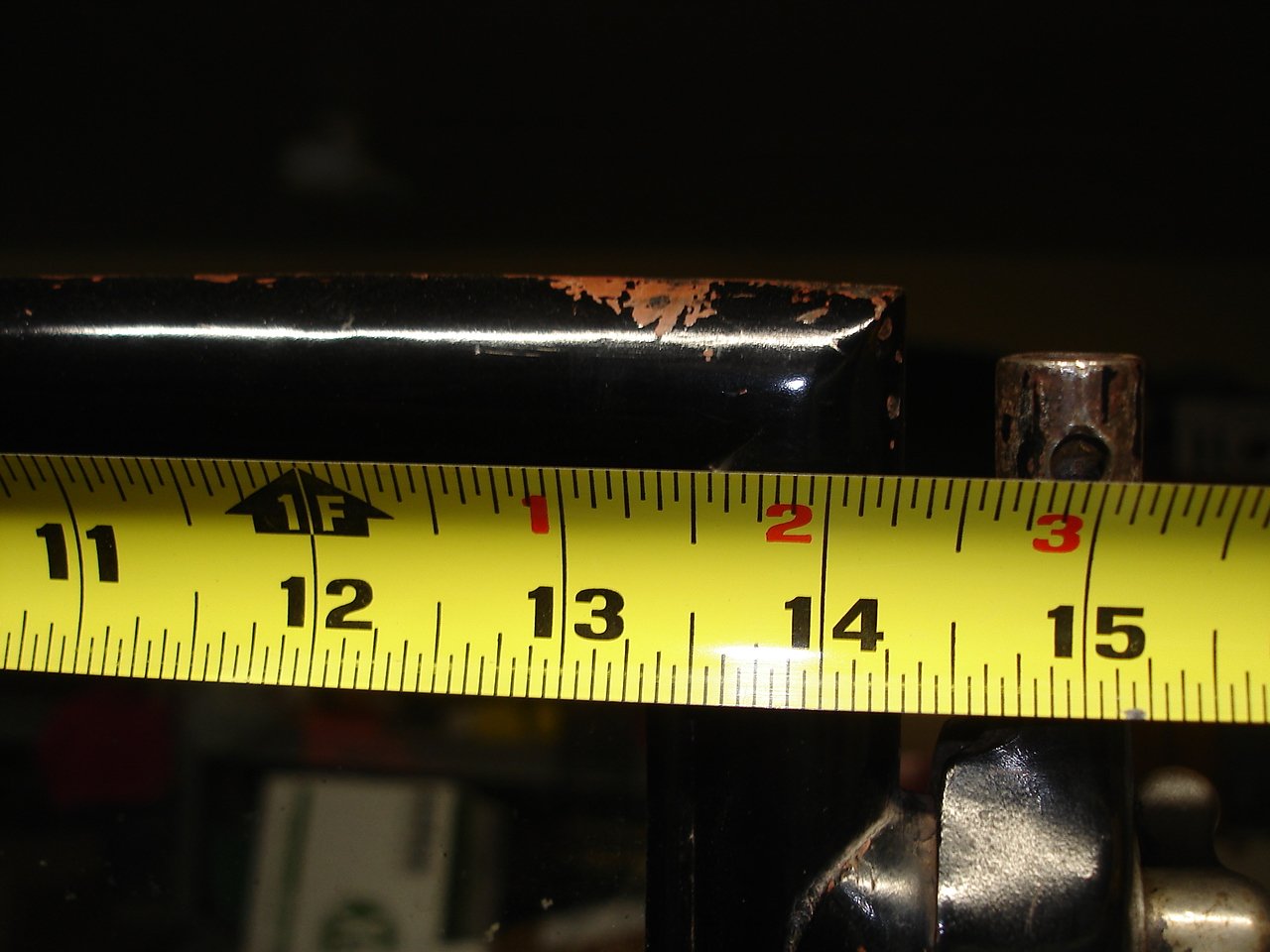

Thank you Jerry. Using Dan’s measurements, the mirror looks too far to the right with the right hole nearly 2/3 of the way across the windshield frame. I found some “spring grips” at Home Depot that will let me try various positions without adhesives or drilling holes. Right now I have it dead center (about 2-3/8” to the left of yours) and it seems to work and look fine, though I haven’t yet driven it in traffic, and haven’t taken into account how a windshield wiper might fit with it.

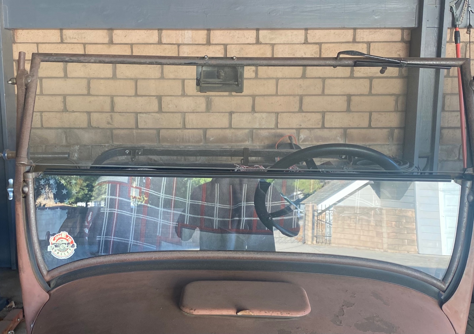

My ‘26 (pictured above) mirror works fine and adjusts easily with the top glass closed or tilted open. I’m surprised how effective the hand-operated wiper is with mist or light sprinkling.

I’ve been using the white spring grips from Home Depot (see my July 31 post) on the Michigan Jamboree tours to mount the inside mirror, and I have to say I’m impressed: minimal jiggle and no noticeable blockage of the view forward. They place the mirror slightly above the windshield frame but not so high as to interfere with the top. Sometime after I get home I’m going to paint them black and call it good.

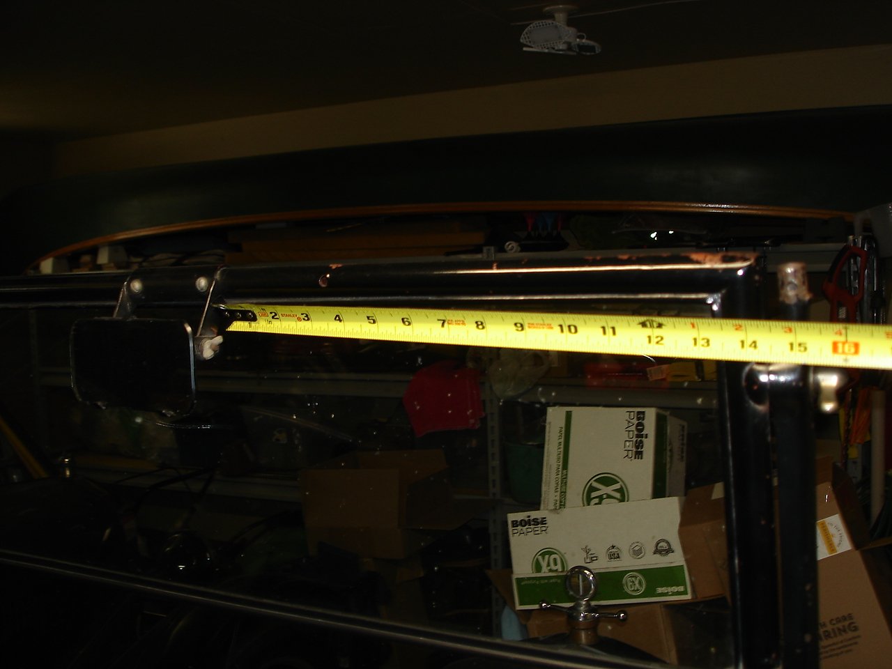

- Posts: 3950
- First Name: Larry
- Last Name: Smith
Re: Inside Rearview Mirror for Open Car
I just checked my 1925 pickup which has the original upper windshield frame, and Ford R.V. Mirror, and the dimension 14 1/4" is exactly the same.
